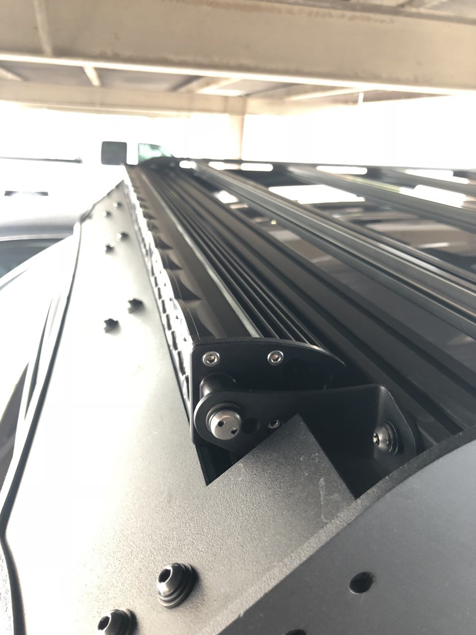

    I went through some trial and error to mount a Baja Designs S8 light bar.
    First of all, the brackets that come with the S8 are both too short and too wide to use on the wind fairing crossbar, and none of the predrilled crossbar holes on the rack allow mounting the light bar in any usable place.
    I ended up buying Rigid E-series mounting brackets and they worked great. I also bought the L series which I’m pretty sure would work too ($10 cheaper) but kept the E series because it’s the first package I opened, and it’s curved, and it sits FLUSH with the fairing
    https://www.amazon.com/gp/aw/d/B00K87WV0M
    In the picture, the crossbar is mounted on the most forward two holes in the “+” and it is PERFECT!
