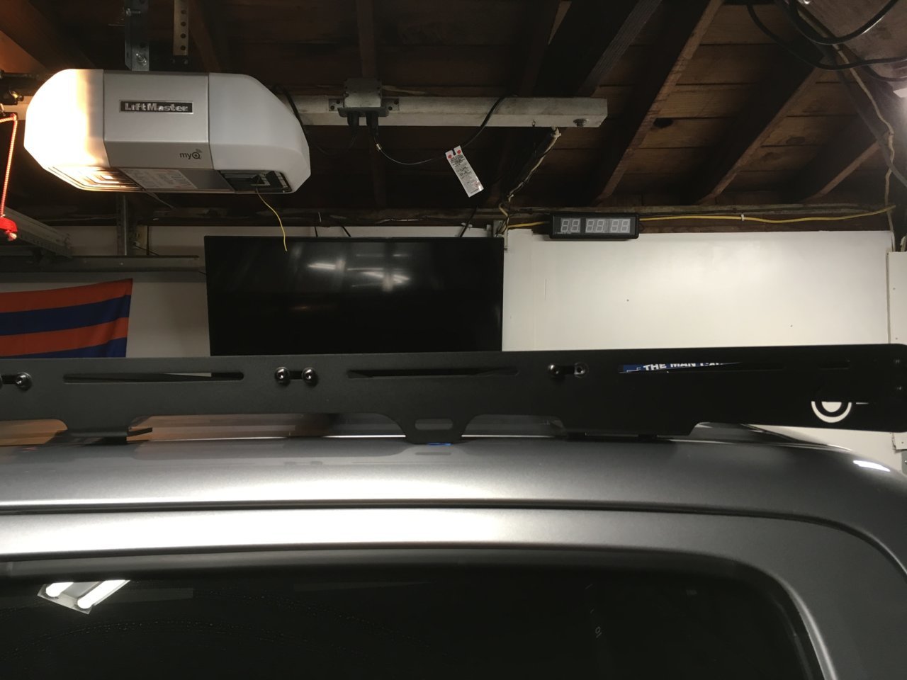

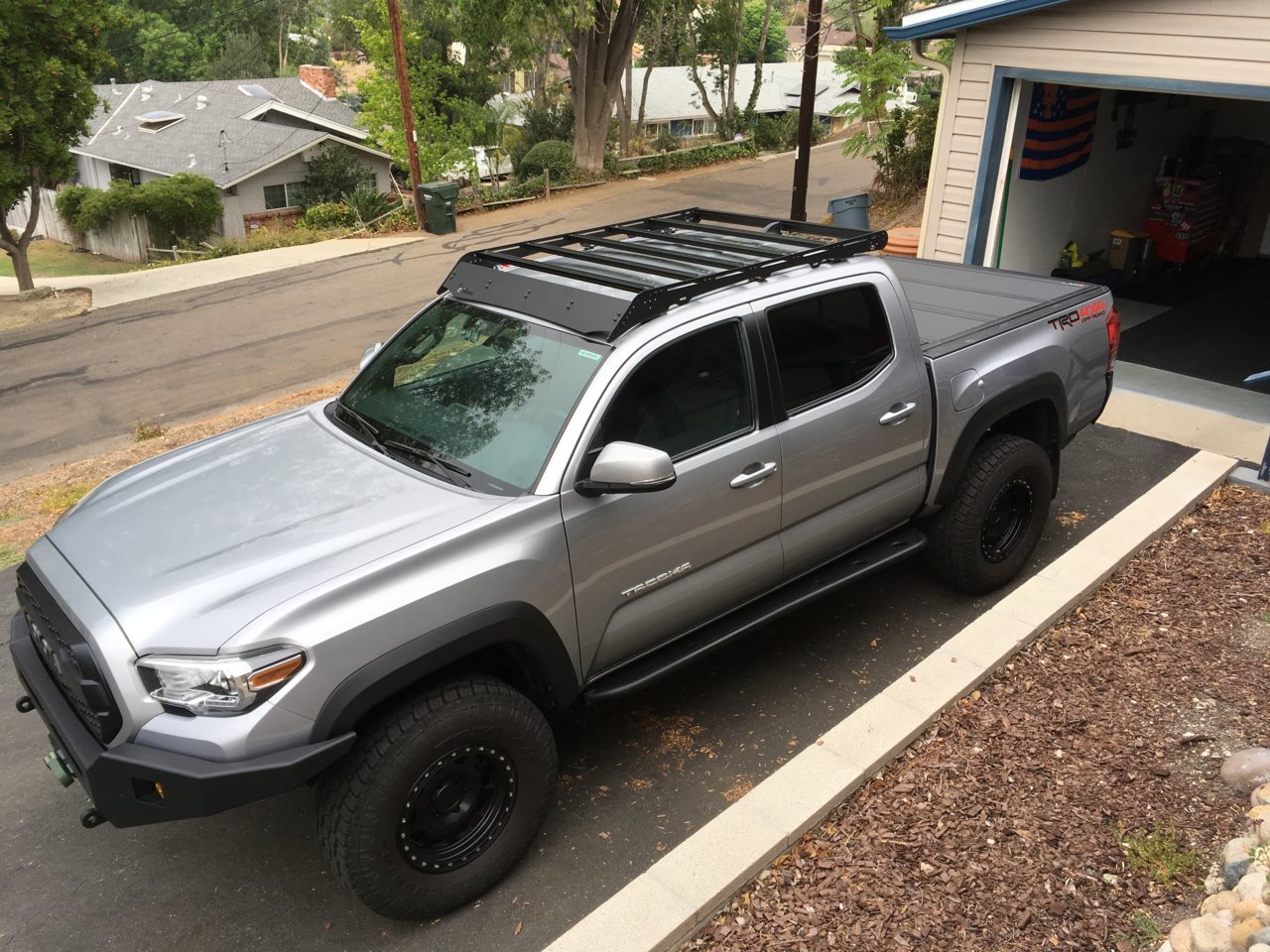

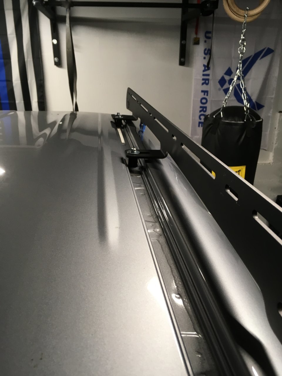

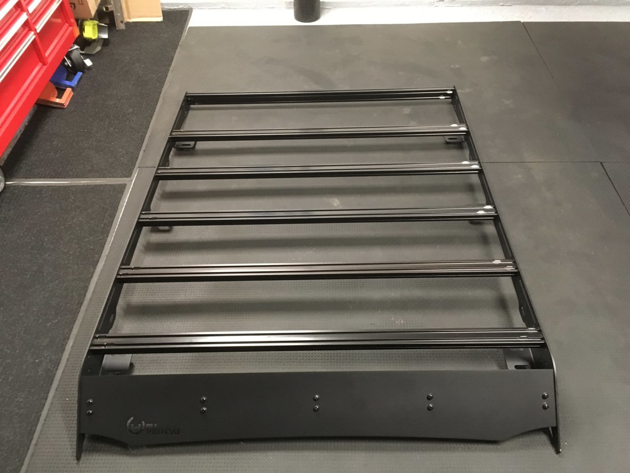

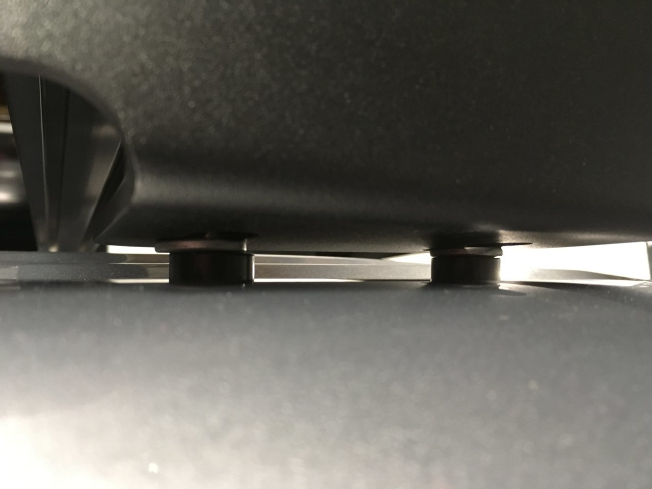

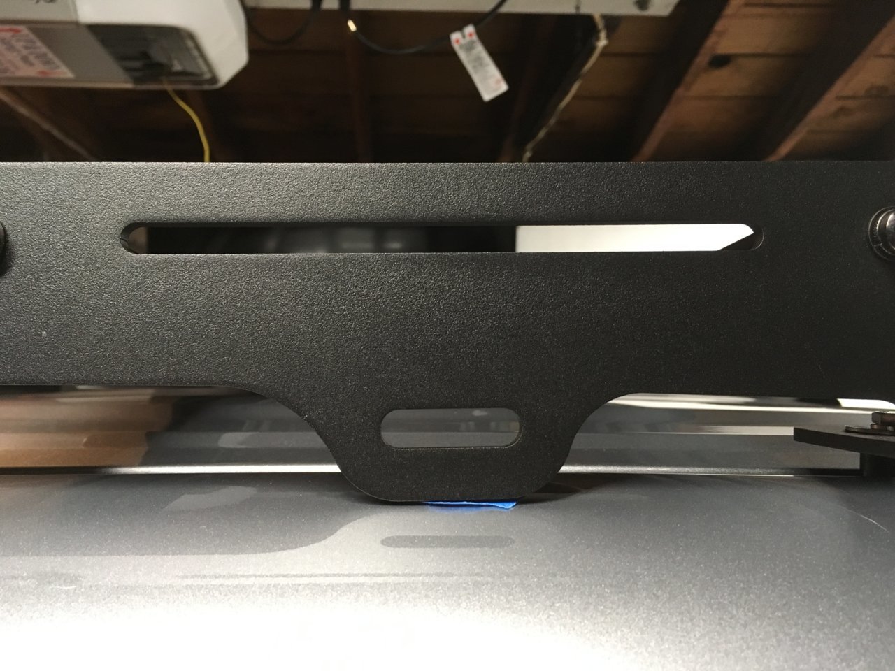

    I loosely assembled ensuring all hardware was there and determined using lower holes for wind screen. I also made sure mounting bolts threaded into the roof. Wouldn’t want to find out they don’t bite after you apply the silicon and race against it drying. I was installing by myself so I disassembled, siliconed each mounting hole, applied spacers and loosely installed each rail then cross rails. I tightened each mounting bolt and discovered the left side rail touched the roof. I removed the back two bolts, added a washer on top of the two spacers to raise the rail and re installed the bolts. The rail didn’t touch the roof anymore. Tightened each bolt, visually centered which was good to go and used a right angle to ensure square. Let silicon dry for 24 hours. Stood on top to celebrate.

    I did this exact same thing except I didn't need any washers. But this reminded me that I lined the entire length of the gutters with painter's tape on both side in case it touched. Not inside the gutter but the roof itself.

    I threw a sweat shirt on my roof and layed each cross rail on it and lined up the holes to the rail.
