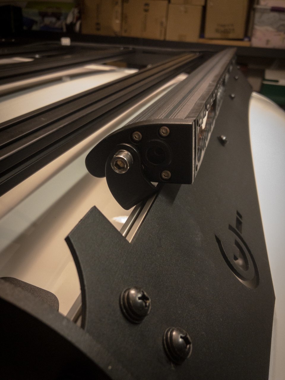

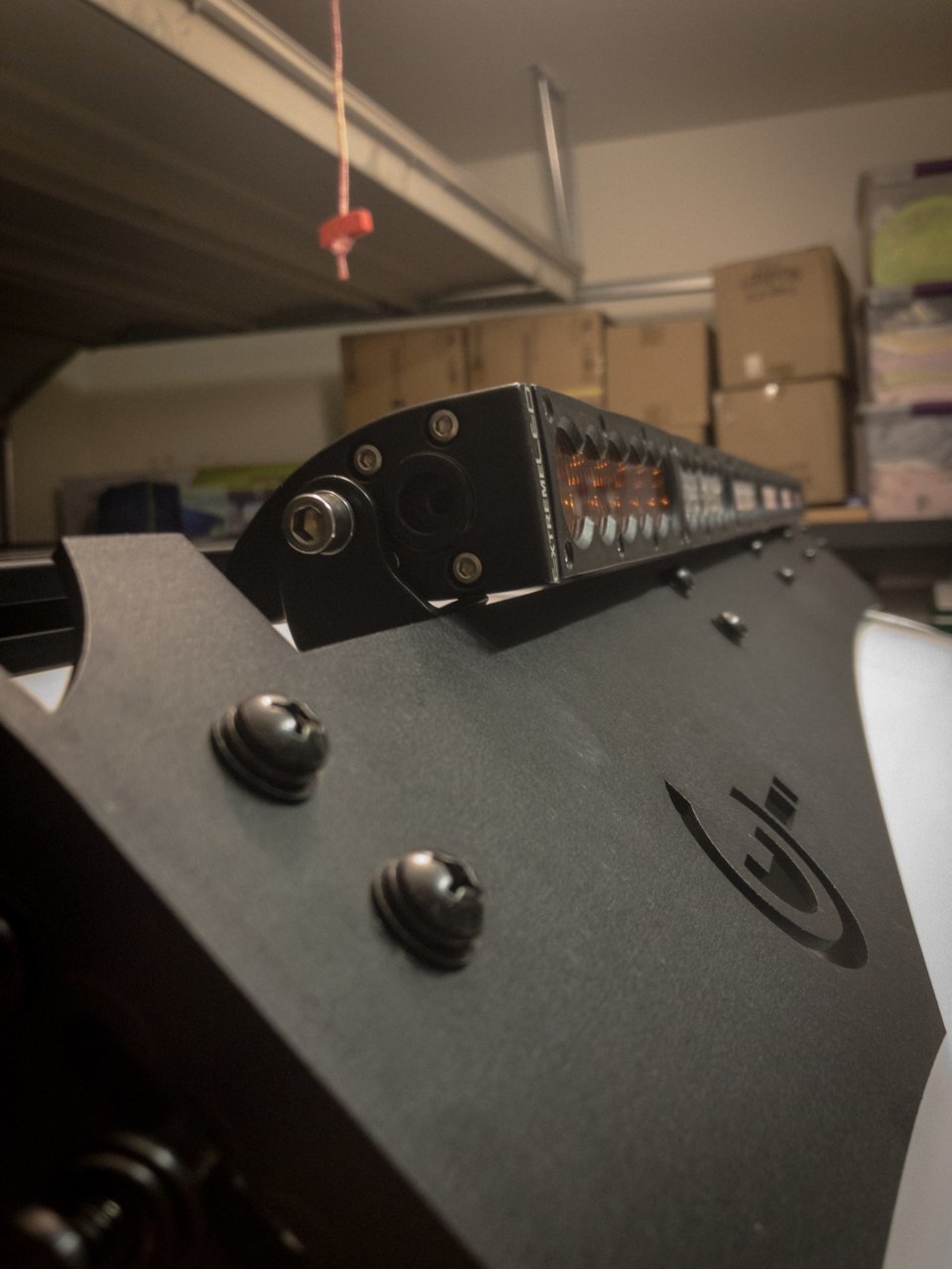

    I think I was just butthurt because the brackets that came with the lightbar don’t work. I can’t get the light level. I ordered some of the heretic ones from prinsu’s site. They look like they’ll allow more rotation.
