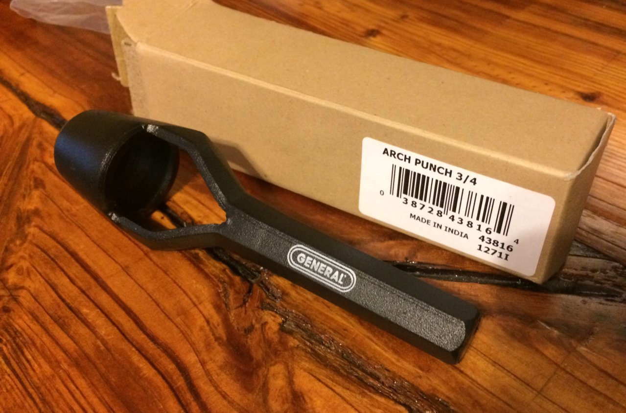

    Hey was it easy to punch the hole on the rubber molding using the Arch Punch? Thank you.

    If anyone needs the punch, I'll send it to you for the cost of a small flat rate box ~$8. I traded a guy the oem roof rack for his prinsu'd strips when I installed min, so i never even took it out of the box 2 years ago.

    Sent you a PM. It's super easy, but you'll still need to remove the metal strip that runs through the roof weatherstripping before you can punch through it.

    I have heard from several people that the rubber weatherstripping binds when you try to drill through it (even when clamped). If you get a solid hole punch like the one in the link below it works great. You just need to lay the weatherstripping over a 2 by 4 piece of wood and pound hard with a mallet. It will go through the weatherstripping after a few hits. The key is measuring properly where to punch the holes.

    I have done a few installs now. The repercussions are that the bit won't go through without being stopped by the steel rod that runs the length of the weatherstripping. You could also not get the holes to lined up exactly right.
    Easiest way to get rid of the steel rod is using a dremel with a cutoff wheel and a straight razor. There is a rubber piece between the weather stripping and the steel piece that runs the length of the weather stripping. Cut two slits in the steel, take a new, sharp straight razor and cut out the steel rod from the section you just cut then punch the rubber. You CAN drill it once that is removed, but the punch is cleaner in the end.
