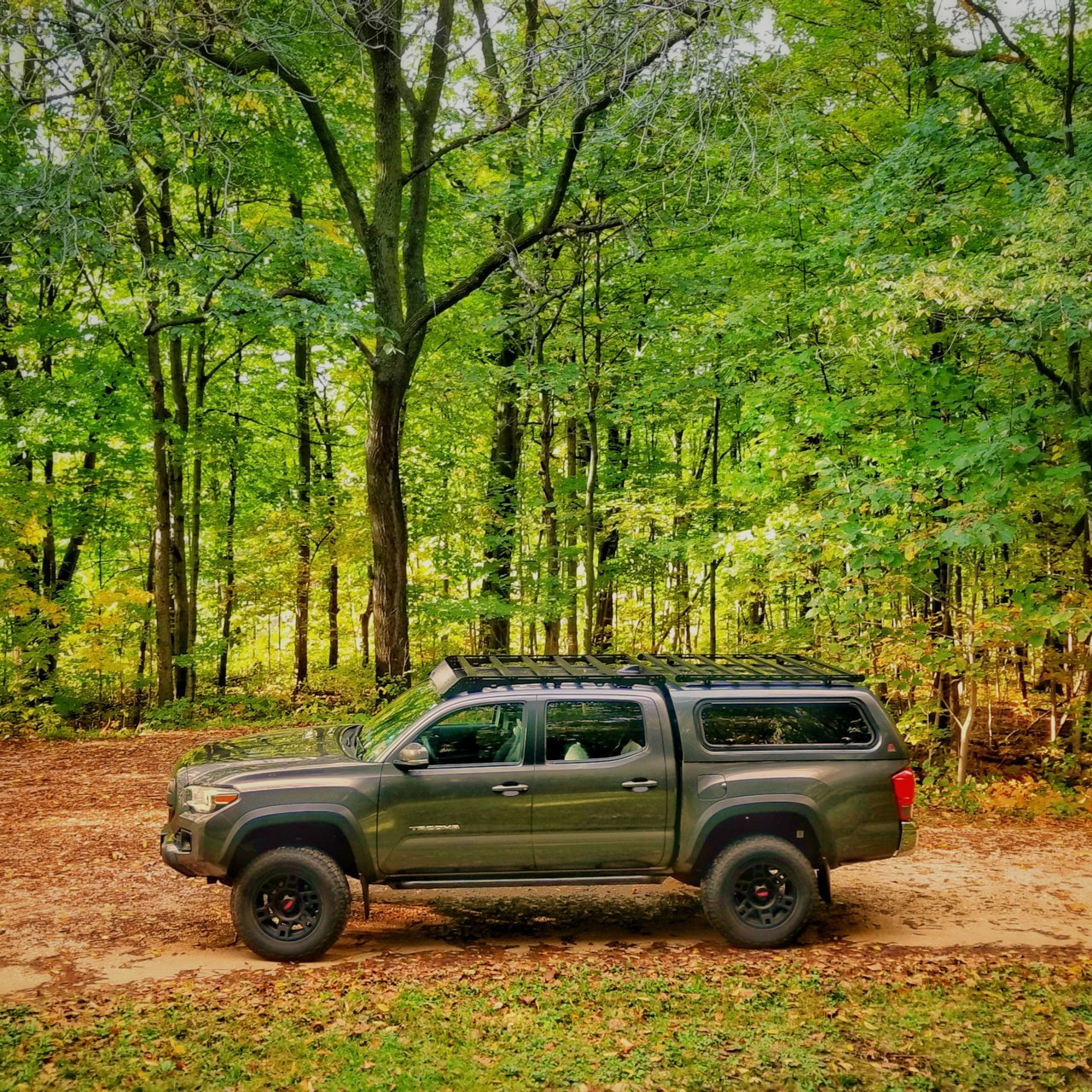

    Hard to tell from my photo, but my racks are very close to being same height. My cap is a Leer 100XR

    Looks like you have the shorter brackets there for sure...

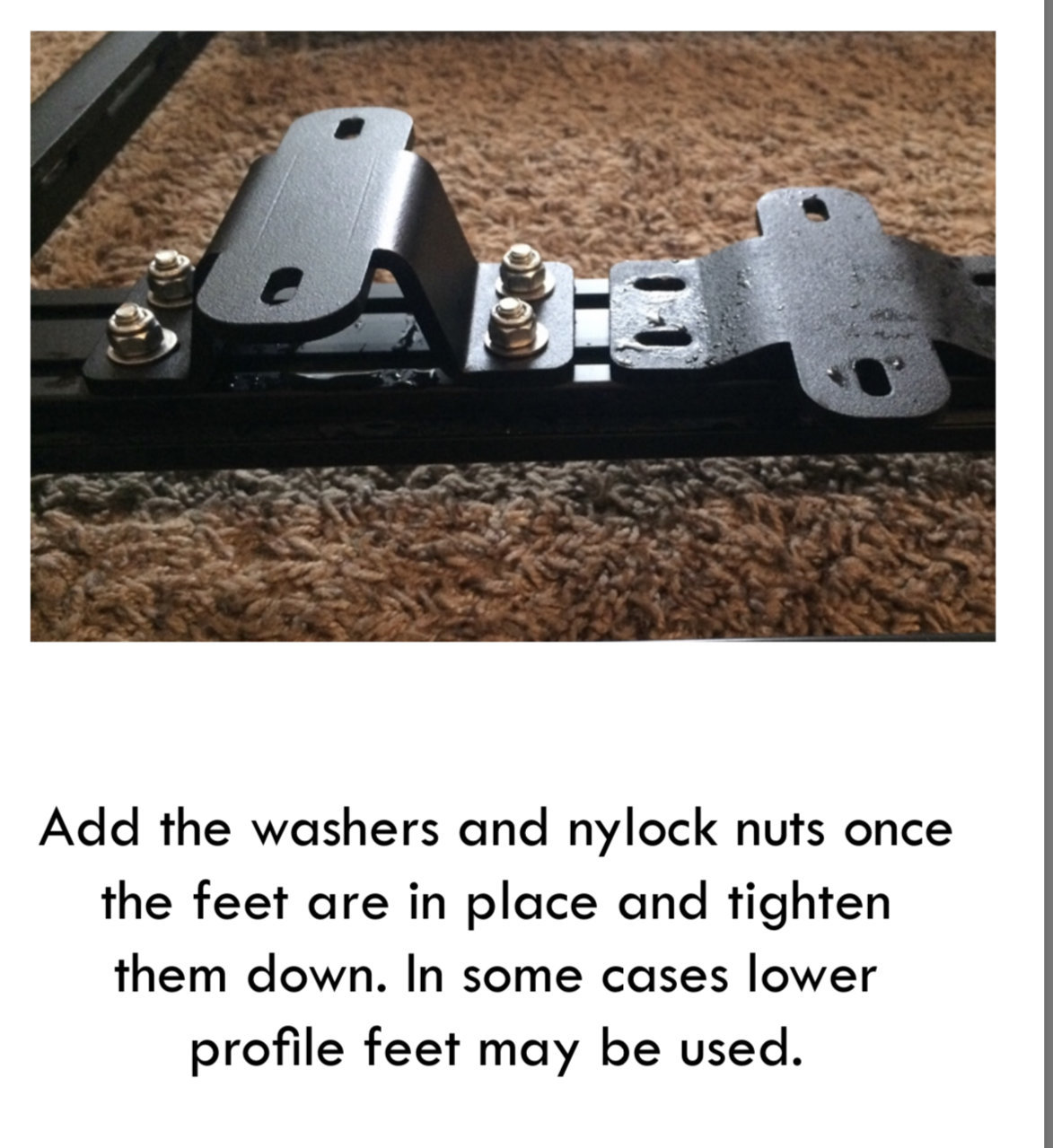

    Here is the part of the Prinsu install instructions that shows two different brackets sizes. They only sent me the ones on the left with the rack, had to pay for the others that they are shipping and I assume will look like the ones on the right.

    well i got the lower brackets to day and they are WAY TOO LOW. As in they are a good 1.25 lower than the brackets that are .5 too high. I talked on the phone with Prinsu support, and they suggested raising the front which I still didn't want to do.
    So I'm going to get some spacers and use the these too low brackets and see if I can get this solution to flush. I don't know what to say, but I'm relatively sure that this will work and I'm bummed it didn't work out of the box but whatever. They are going to allow me to send back the brackets I don't use for a refund, so at least I got that going for me. Off to tilt at windmills.

    Since my OCD can't handle the height difference and neither Prinsu nor Leer can give me an explanation I'm just fixing by using the low profile brackets (the ones on the right of the picture I posted above), and crafting spacers/washers by ordering four 4 -1/2 inch long pieces of aluminum flat bar that is 1/2 in thick by 1-1/2 wide from metaldepot.com. :headbang:
    Then I just need to drill holes in those, paint them black and slap them under the lo-pro brackets using some longer bolts and I'm in jail like Flynn.
