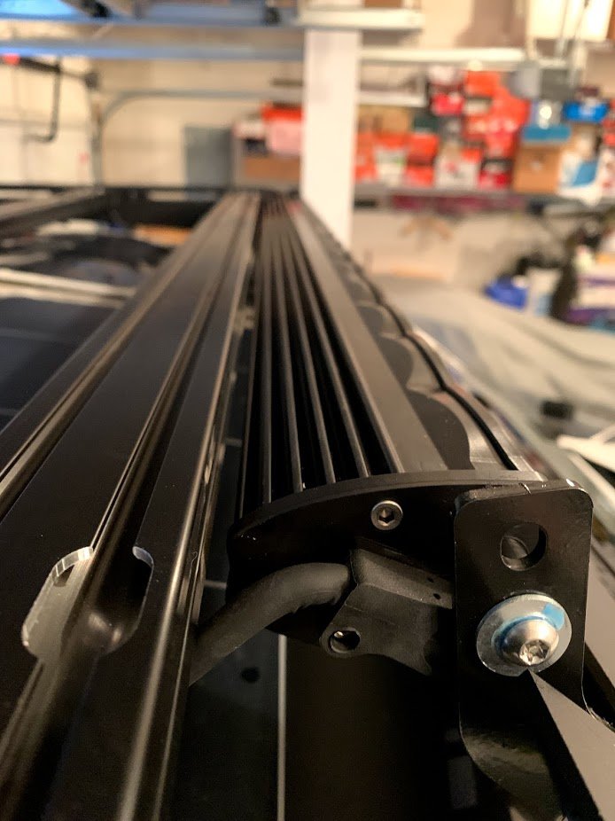

    does anyone know if there is a bracket to mount a BD onx6 40" light so that it would sit flush with the cross bars and not above?

    Did you try the prinsu ones? I just flipped a crossbar vertical and drilled through to mount it. Cheap and easy. Used security hardware to prevent sticky hands. No issues.
    Sits flush:

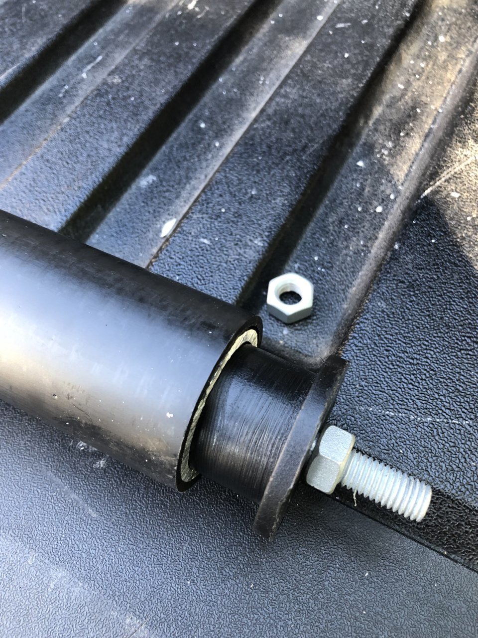

    How did you disassemble the roller? This is the best solution I've seen so far for rolling up a kayak

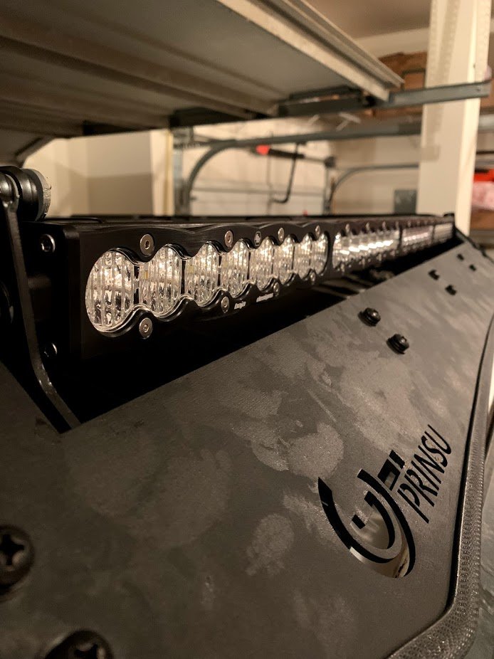

    mine sits just below the crossbar and i used the light brackets prinsu sells
    i do run a s8 tho so its not as tall, you could always notch the holes out to give it room to move. as mine sits, it sits flush over the fairing

    the onx6 has two mounting points on the side of the light bar as opposed to the s8 with only one mounting point. I did take a look at the brackets prinsu sells but not sure if it will work since onx6 requires two bolts on the side and they are further apart from each other than the two through holes on the prinsu brackets.

    you can make a small L bracket to mount the rearward mount on the back crossbar

    The roller comes disassembled. It has an aluminum tube and a plastic outer tube and two plastic roller ends that are bolted to the rack. I just had to measure to cut the tubes down then just assemble it together.
    It worked really well. I’m happy how it came out.

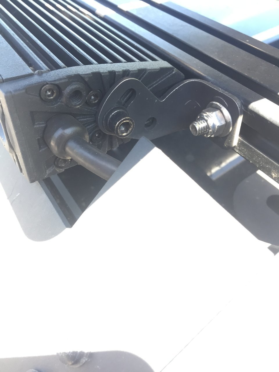

    I'm running a Morimoto single row bar that sits flush. My bar has 2 mounting holes as well. I ended up mounting the standard prinsu light mounts on the front face of the 1st crossbar (not the one behind the fairing). I just used 1 of the lights screws and haven't had any issues with it moving around. I'll snap some pics at lunch...
    Edit: Pic added

    I don't think you even need the rear bolt for that system to work. Looks like it just is there to lock the angle of the light bar into place. Not really a requirement. Any standard light bar bracket that fits Prinsu should work for you just fine.

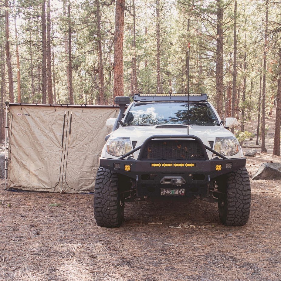

    what kind of awning is that?

    What kind of front bumper is that?

    ARB!
