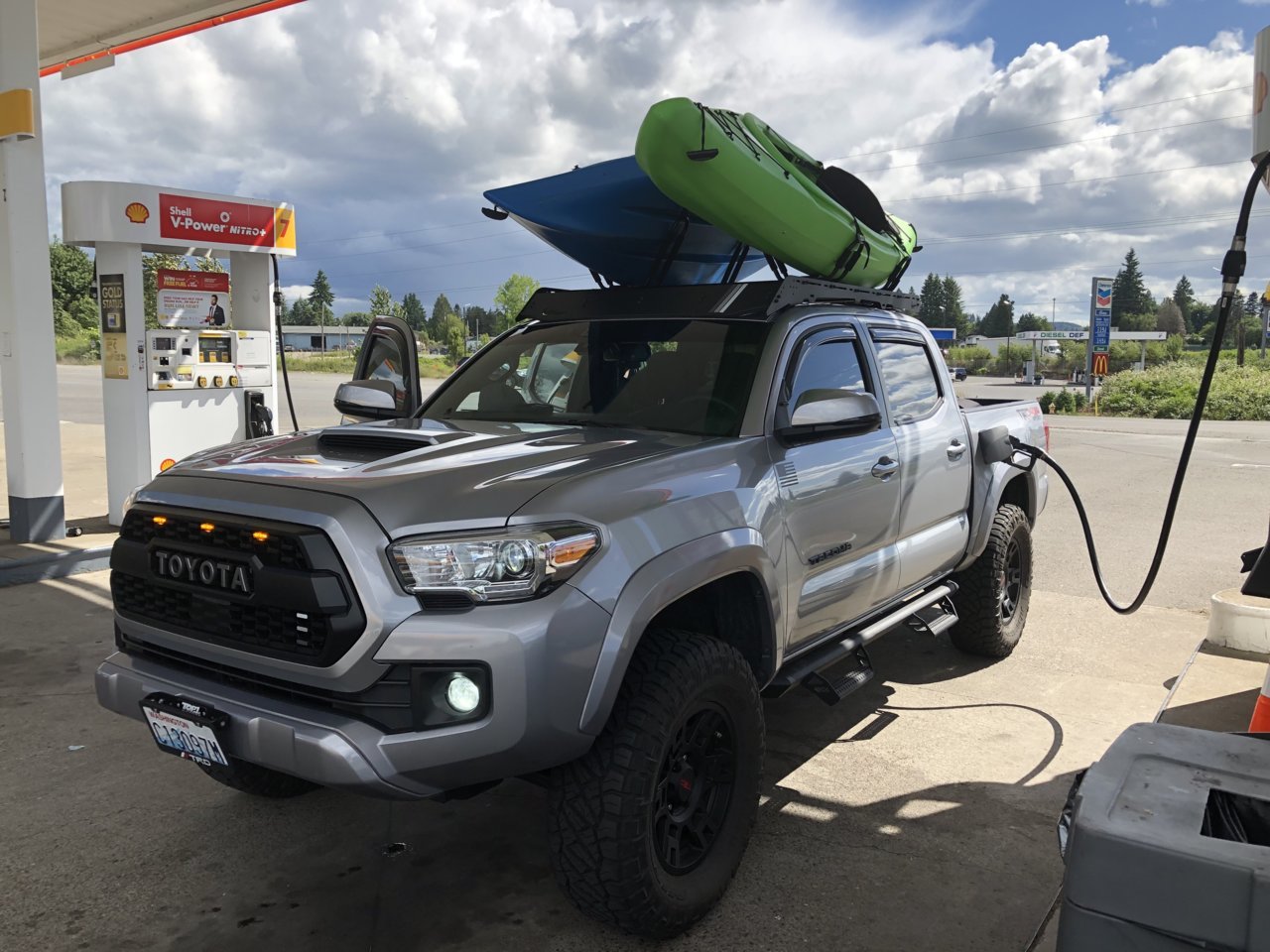

    How exactly are you doing that? Link to those j-hooks?

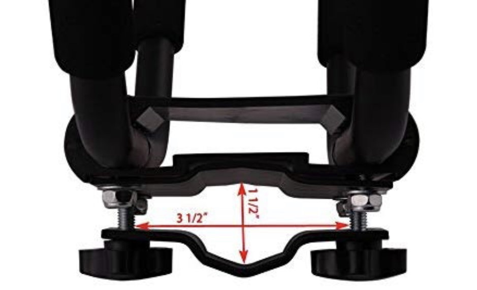

    Just mounted the J hooks with the hardware/mounting attachments that came with the J hooks. They work and are pretty damn secure but the bracket is more rounded which doesn’t exactly work as perfect with the square prinsu cross bars.
    https://www.amazon.com/gp/aw/d/B00873J0YY?psc=1&ref=ppx_pop_mob_b_asin_title

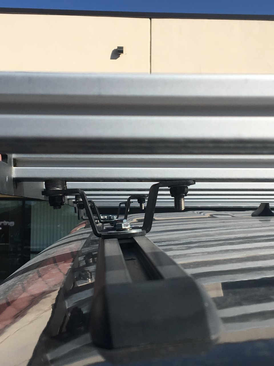

    what thread and kind of bolt did you buy to be able to stack washers? my racks come in a few days and I want to be ready incase my leer topper gives me this issue

    Those are the bolts that came with the rack. I just got 1/4" stainless washers. It may be worth getting some 1/4-20 1 1/4" carriage bolts if you have to do the same thing. The outside bolts were barely long enough as you can kind of see. other then that it's been on almost 2 years not with no issues. I don't have a roof top tent but I've had the rack loaded with kayaks.
