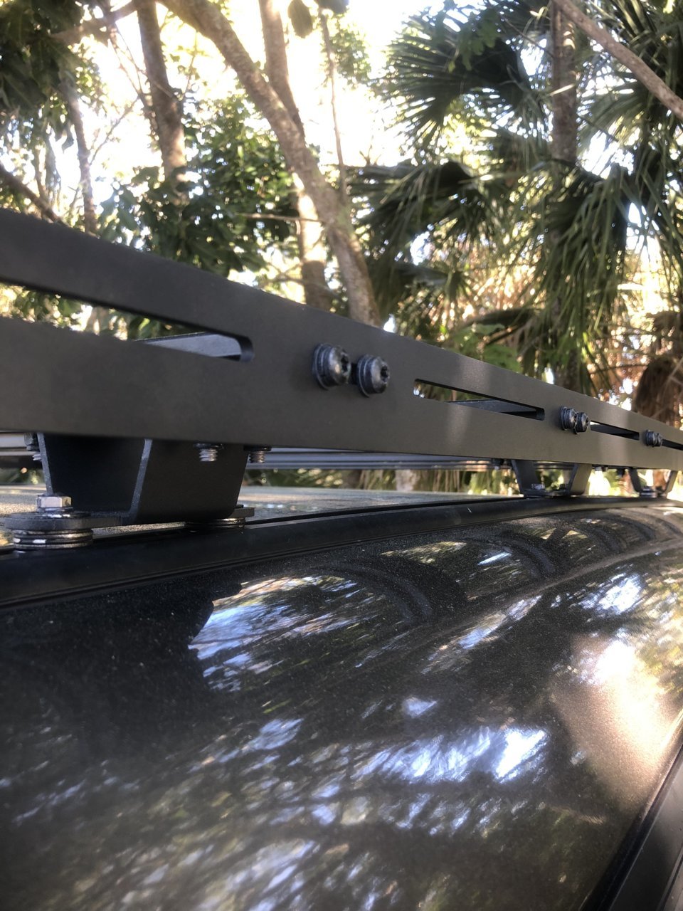

    How "tall" are the sides of the Toprac? 2?" Do they widen a bit on the front and back portions? I'm looking to fab a rack to go around and above my softopper, and I want to match a Toprac with my existing Cabrac, and I need to know how much space I have to work with. I'm sure this info is in this thread, but there are now ~525 pages to this thread, and... I don't have time to scour 500+ webpages.

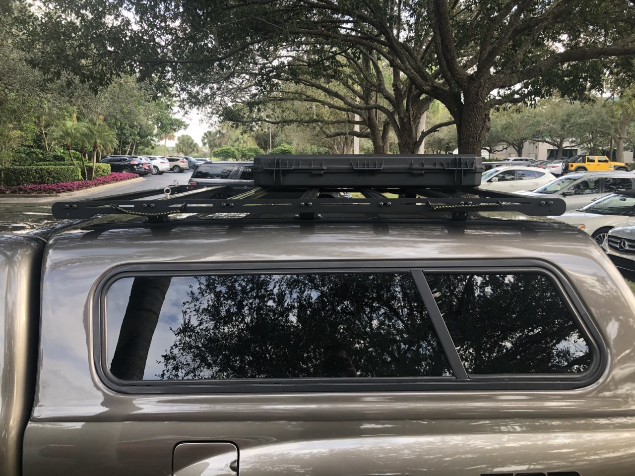

    Prinsu Rack is IN!! The Rhino Rack Tracks put it pretty much dead level to the cab rack.
    I need to figure out if I should put my awning/recovery tracks/Plano Case on the front or the back of the truck........

    I would say about two inches. Front and back start at about two inches then run about an inch and a half though the middle to another two inches in the back. See picture. A63FDA4B-92E5-480D-BBE8-8E17C6C4B635.jpg

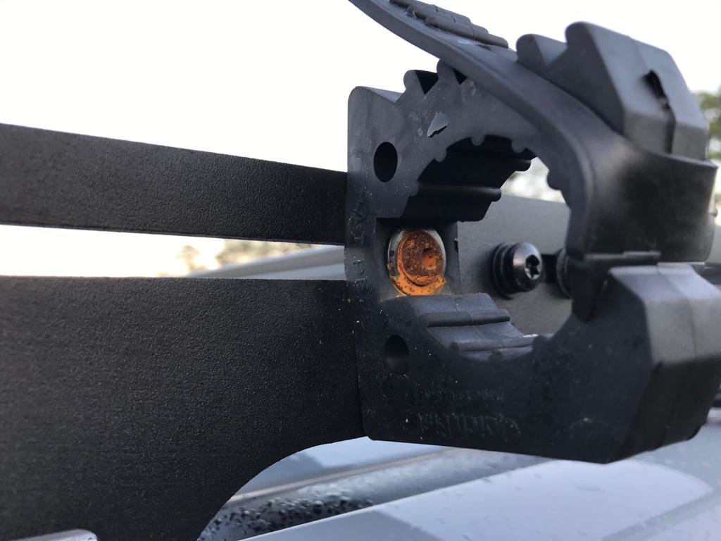

    The anodized bolts holding the rubber Quick Fist clamps to the Prinsu rusted in about... 1 week's time since I installed them. They're no different than any of the other bolts on the prinsu. None of those have rusted.
    What gives?

    Is there a washer behind that? What was mounted to the Quick Fist? To me it sounds like galvanic corrosion, where 2 different metals were in contact when you add an electrolyte (a.k.a water)

    There is a washer behind it. On the backside of the Prinsu rack is simply one of the 8020 T-Nuts. It is Zinc, however:
    https://www.amazon.com/gp/product/B00TE30LUI/ref=ppx_yo_dt_b_asin_title_o01_s01?ie=UTF8&psc=1
    I don't believe I used the bolt from this listing. I think I used one of the supplied-Prinsu bolts. It's interesting that neither the washer, or the T-Nut rusted. Just the bolt!

    That looks like the bolt was just black oxide coated, which will rust very quickly in a wet environment.
    Also, steel is usually not anodized, aluminum is. Although it is possible to anodize steel, it won't have the same affect as it does on aluminum.
