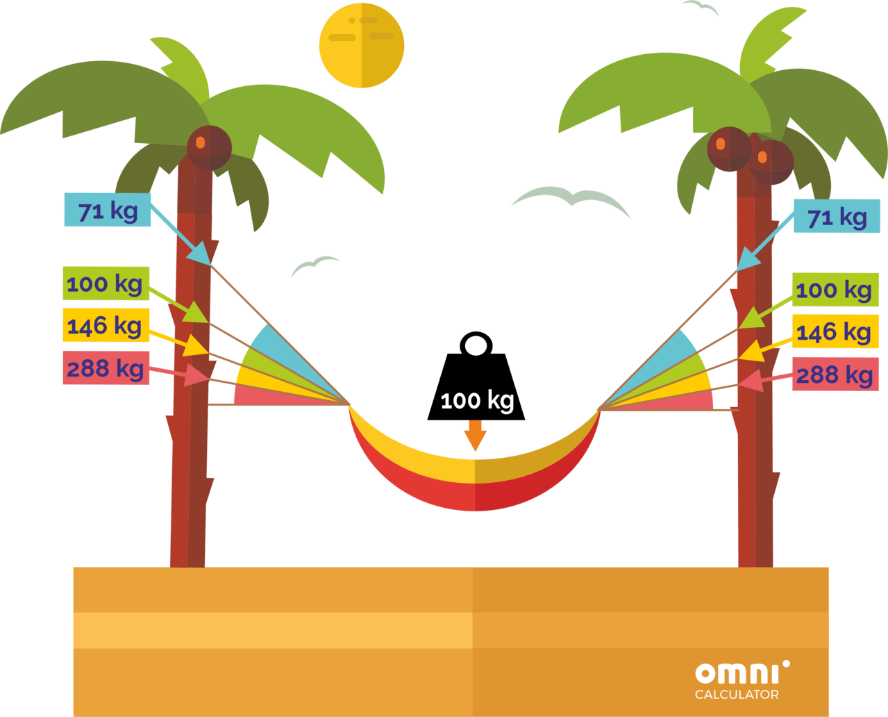

    Keep in mind you can adjust the force felt by the roof rack by changing the angle of the dangle. Here's a diagram to help illustrate it.

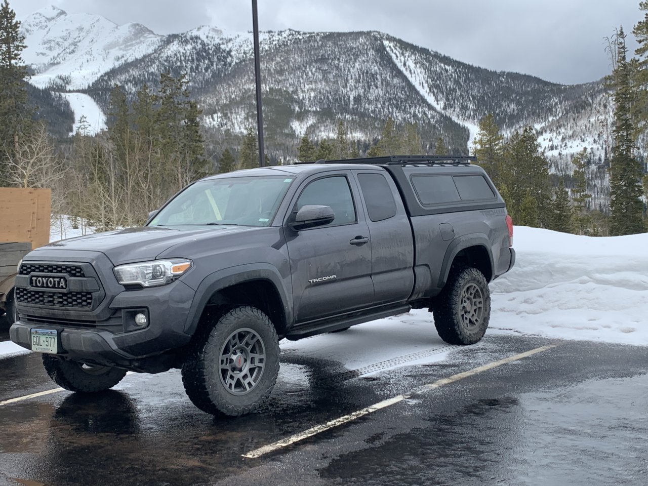

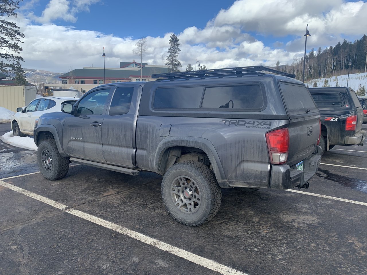

    I mounted up my new prinsu top rack last week, it's much more solid than I expected! It looks a lot better than the Yakima bars I had up there. The tracks on the topper couldn't have been mounted even a little bit wider or it wouldn't have fit, I got lucky.

    May be a dumb question, but from the angles of the photos, I can't tell if you have the long bed or short bed.. Which do you have?

    that, is an access cab long bed :thumbsup:

    never dumb questions, just dumb answers :rofl: yeah it can be hard to tell with the bad angle, but is indeed the long bed -- access cabs are only long bed, and if it's a double cab you can tell it's a longbed or not by looking in front of the rear wheels, longbeds have about a foot in front of the wheel, the shortbed basically ends at the wheel.

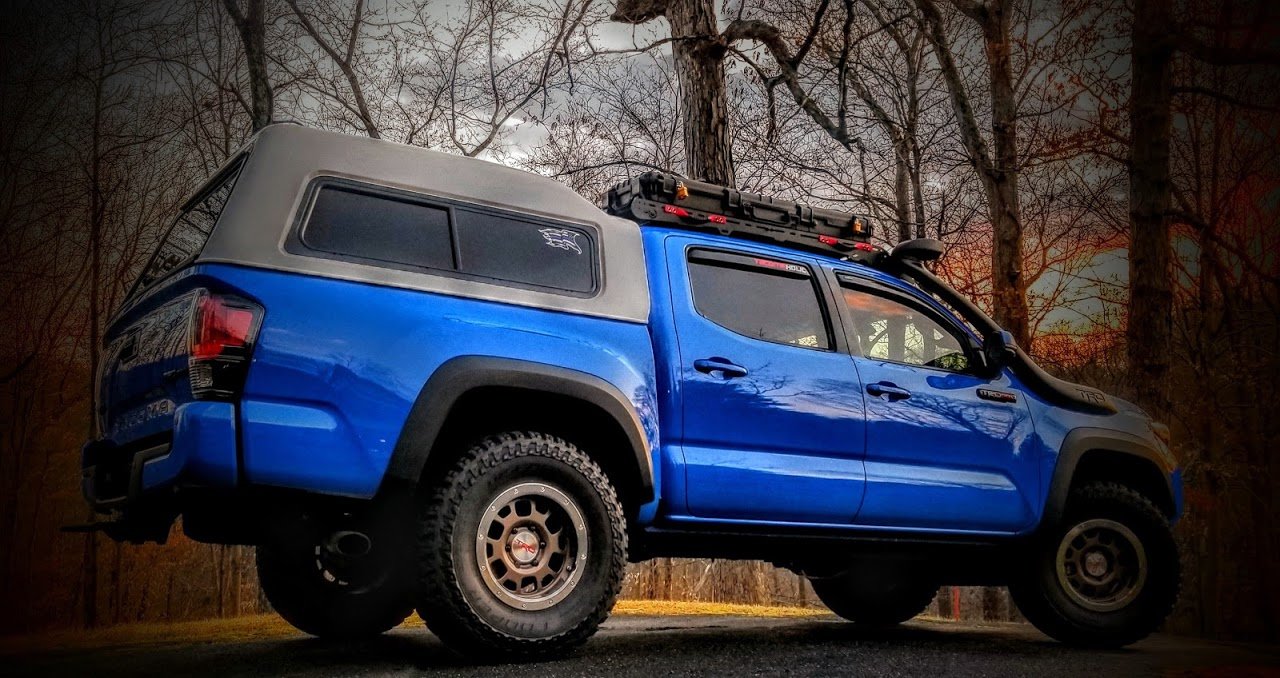

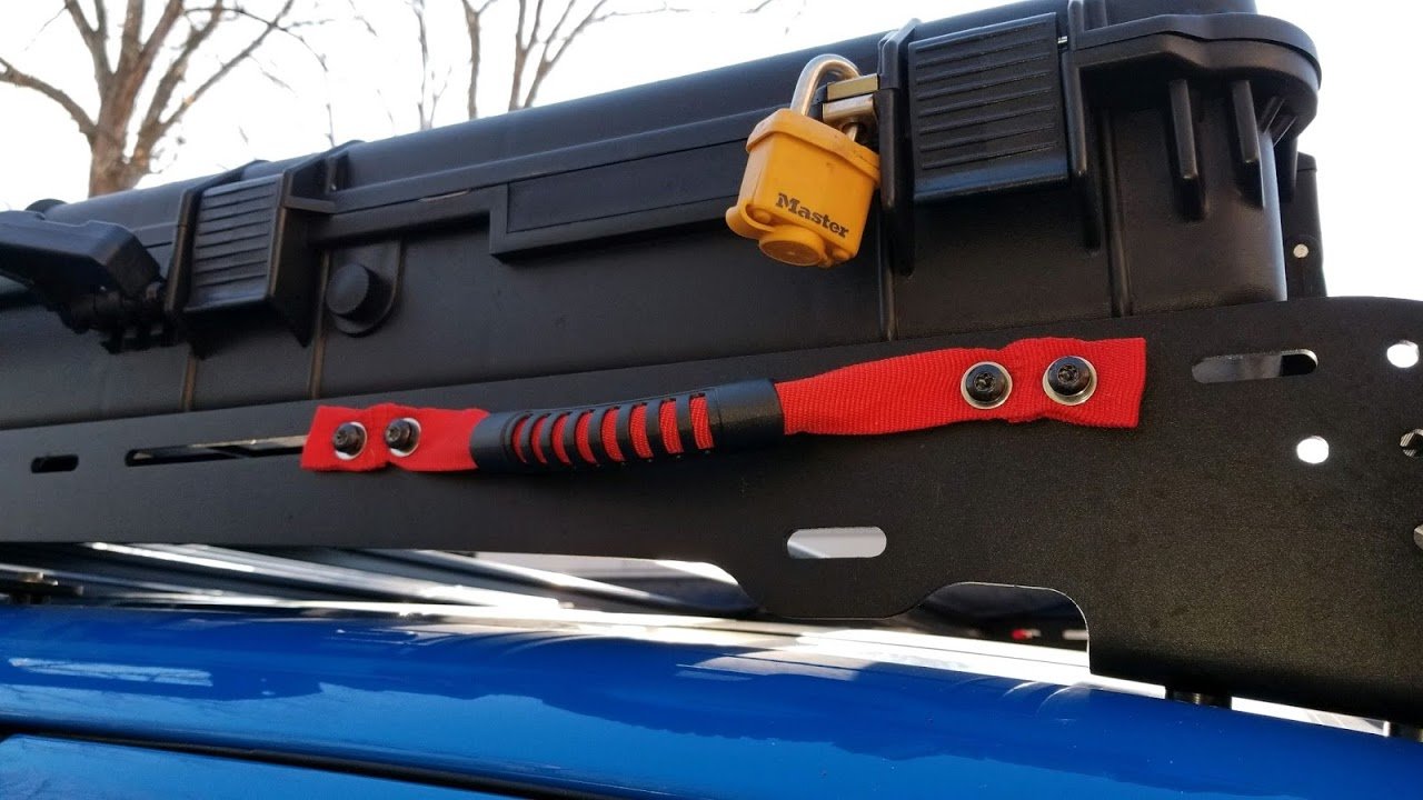

    Yea, After spending way longer than I should have trying to make them look good on there I decided to remove them. I ultimately bought more, only this time in red, and sorta minimalized things a bit.

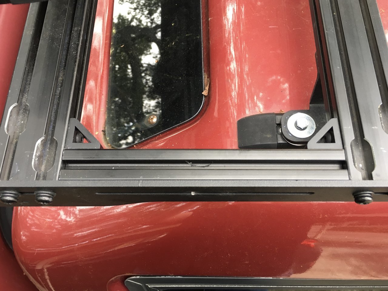

    I got some 8" 1010 extrusions and some corner gussets to reinforce the front overhang of my top rack.
    I know they started to ship some flat plates with new racks to prevent side to side movement, but this takes up less space and bolts to the cross bars and side rails.

    Anymore info on this?

    What do you want to know?
