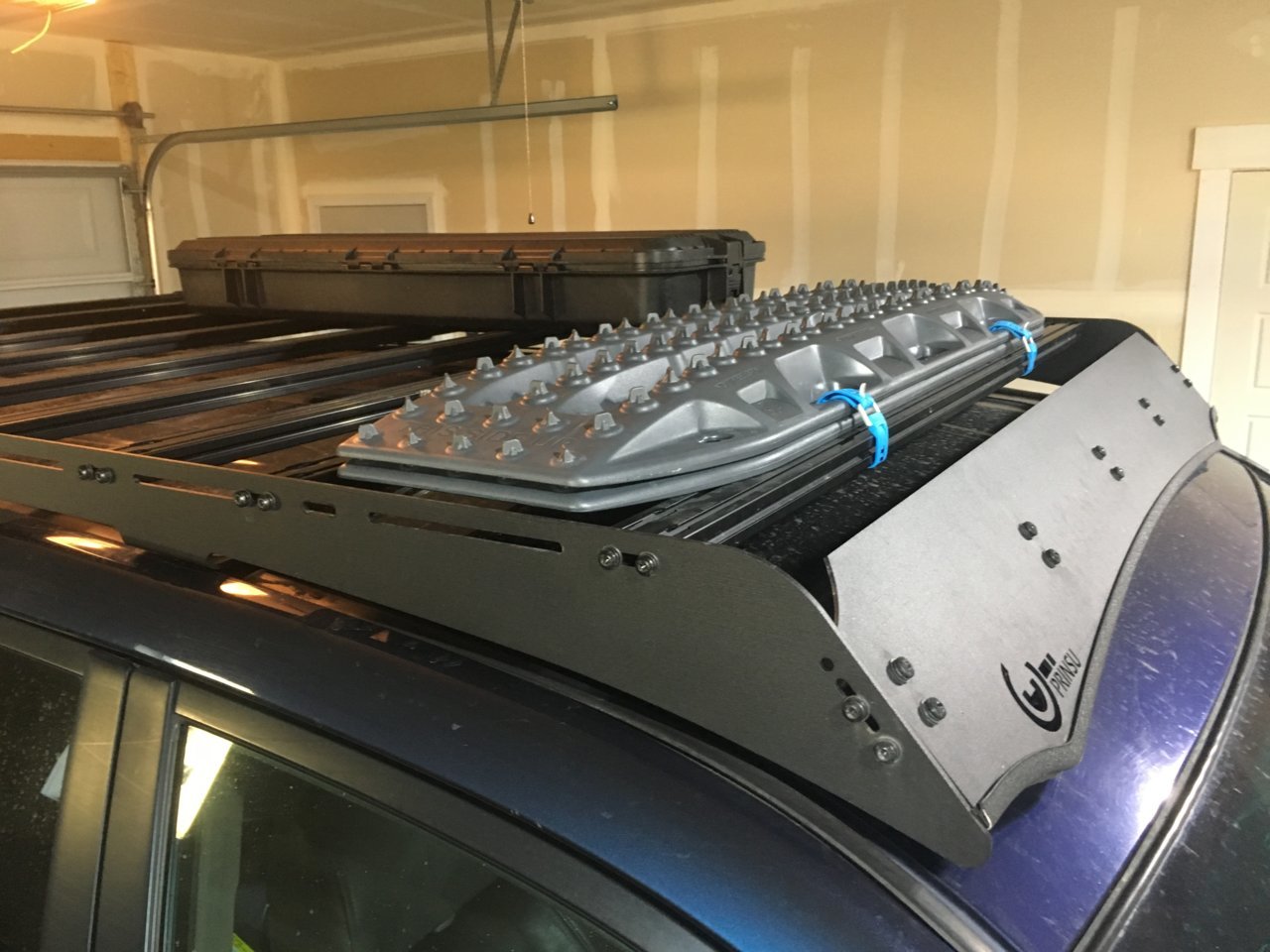

    Switched to black oxide stainless screws 2 year ago. Color faded to dark bronze but no corrosion. (Photo reflection makes them lighter, actually look black from a distance) You can get them and matching washers at McMaster Carr, should be a link earlier in this thread. With Stainless no worry about future rust drips on roof. Save some money and pass on the lock washers, Not needed if you torque bolts correctly and so far none have come loose.080CBD9A-0013-4D1A-8A76-AC11A907D444.jpg

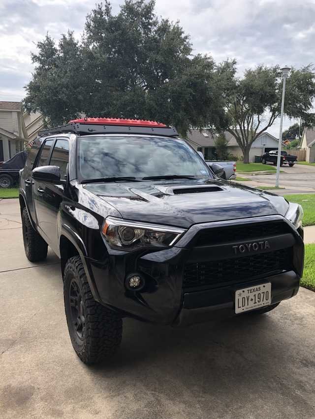

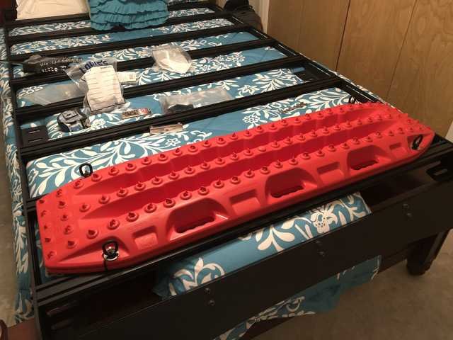

    Just ordered a set of maxtrax. Wanting to mount them just like this. Any better places to buy the tie down rings? Looks like they are $8.50 for two on prinsu’s website and I am sure shipping will be a lot.
    *Disclaimer not my pictures. Sweet 4runner though.

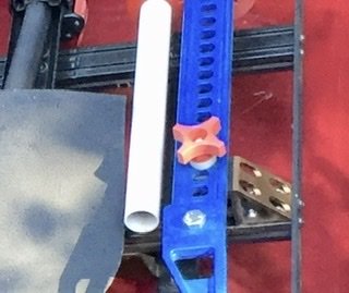

    For an application like that, I use threaded machine knobs like this on a carriage bolt. You can get them at most good HW store or McMaster Carr at $2.37 each in your choice of colors plus shipping. For your proposed application, I’d be worried about it vibrating loose if there is any flexing of the Maxtrax so you may want to get one of the anti vibration knobs with a nylock feature, also McMaster Carr for about $1 each

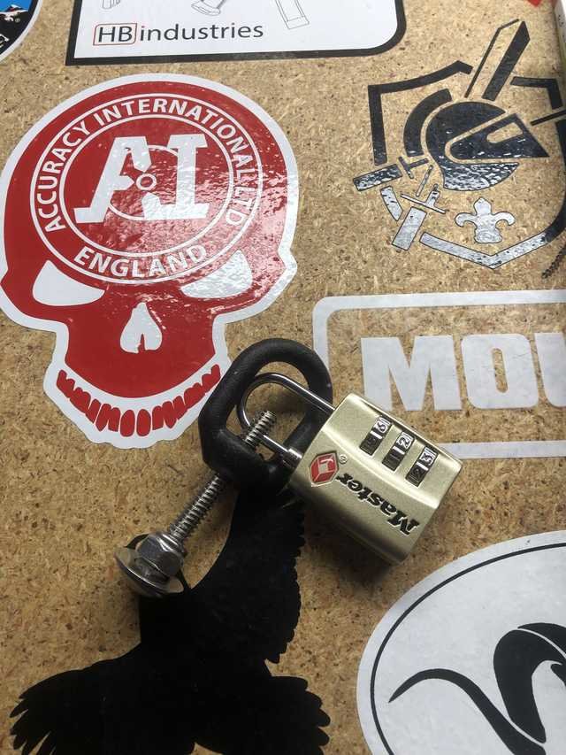

    I was thinking if I went the tie down method I could drill the screw and put a safety pin in. Might as well just buy the maxtrax pins for $50 though. Just hurts spending that much money on mounts.

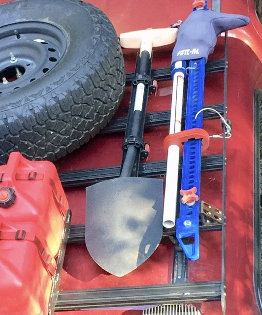

    I used a wheel tray from an old Yakama bike rack. Cut into 12” length for the axe and remaining 24” for the shovel and bolted to the Prinsu bars. Found some extra Yakima wheel over center straps on EBay to hold them in place. See post 331 in The Prinsu How page for details.
