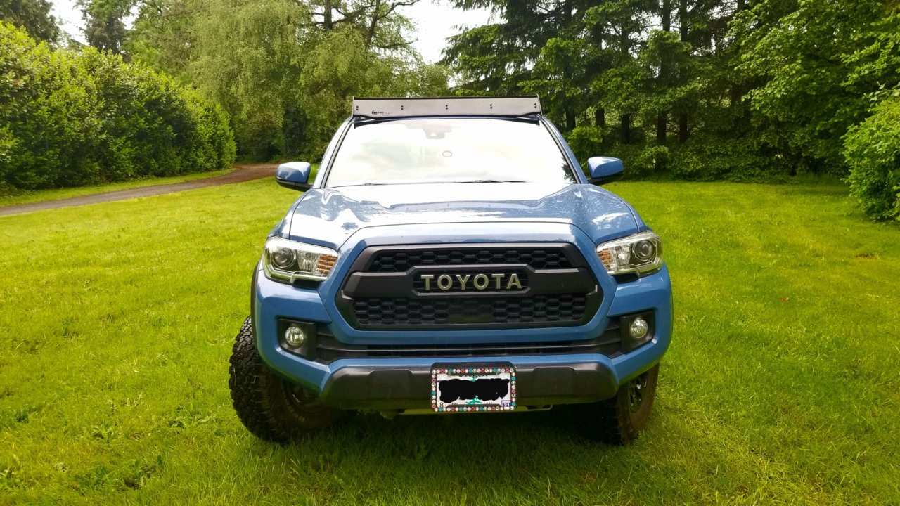

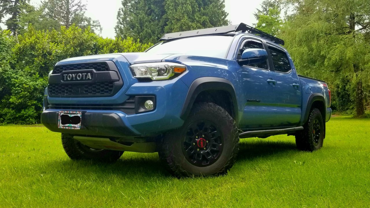

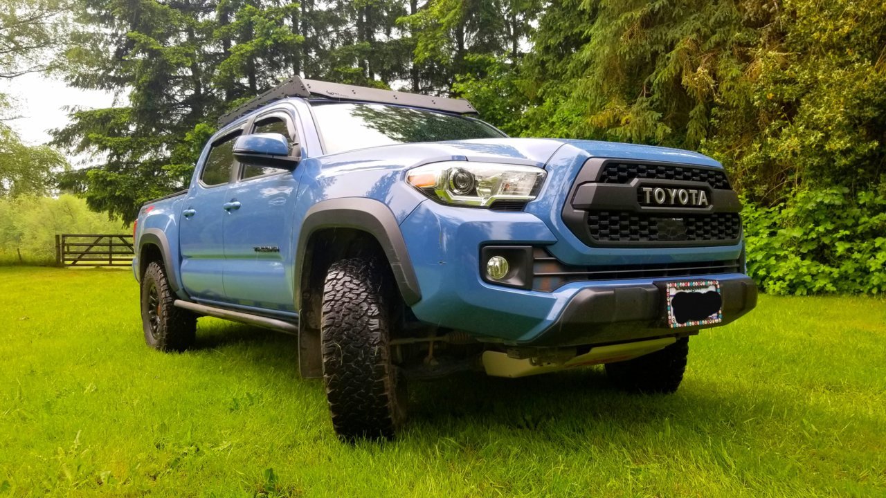

    Got my rack on today :D:D:D

    Nice! On sale? How much?

    Thanks. Not on sale. Normal price. Worth it in my opinion :)
