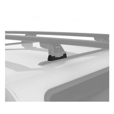

    I have a set up with 65” bars to carry my 2 wide kayaks. I have a set of 4 Yakima landing pads from my old roof rack set up that I attached to the Prinsu crossbars with carriage bolts. Only problem I had was a finding a nut small enough to fit in the landing pad hole. I ended up finding some threaded rod couplings that worked perfectly.
    Now I can add/remove my 65” round bars/Yakima Control Towers as needed. I hauled 2 heavy kayaks 5 hours to the beach and back last summer, doing 80 mph on the highway with no issues.

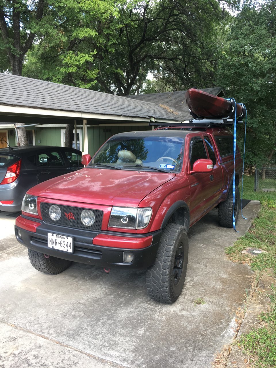

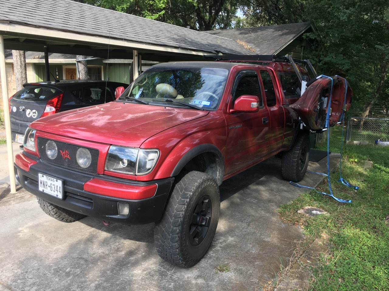

    Made some brackets to bolt a Thule Hullavator onto the Prinsu. I basically needed to add 5/8" so it could wrap around the bar.
    I read a lot about the hullavators and that it needs to hang way off the side of the vehicle. This isn't really the case with a truck topper since the sides are relatively straight. It still clears my bedside by a few inches.
    Test fit the kayak

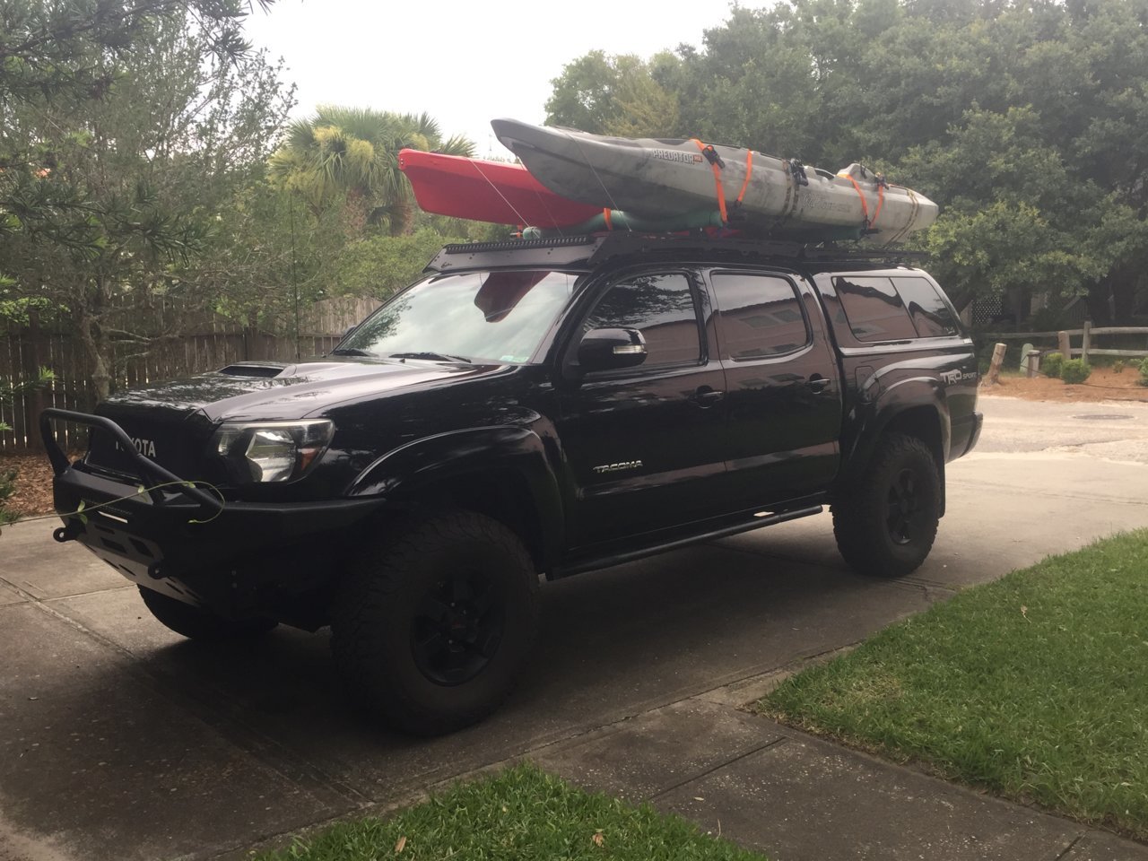

    Right now for one boat I've got lifters and a Malone gunwhale kit;

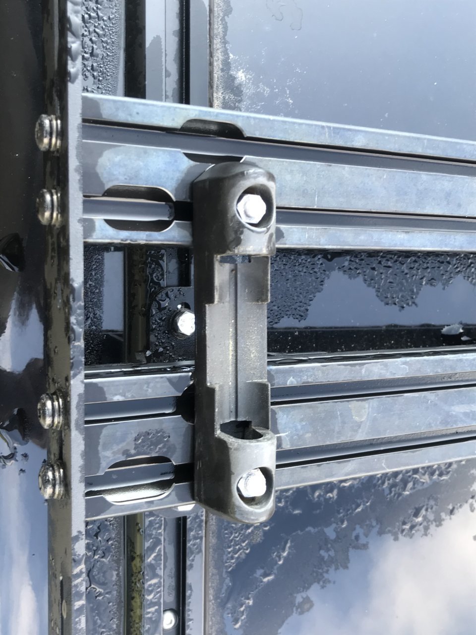

    See mine above carriage bolts and star knobs

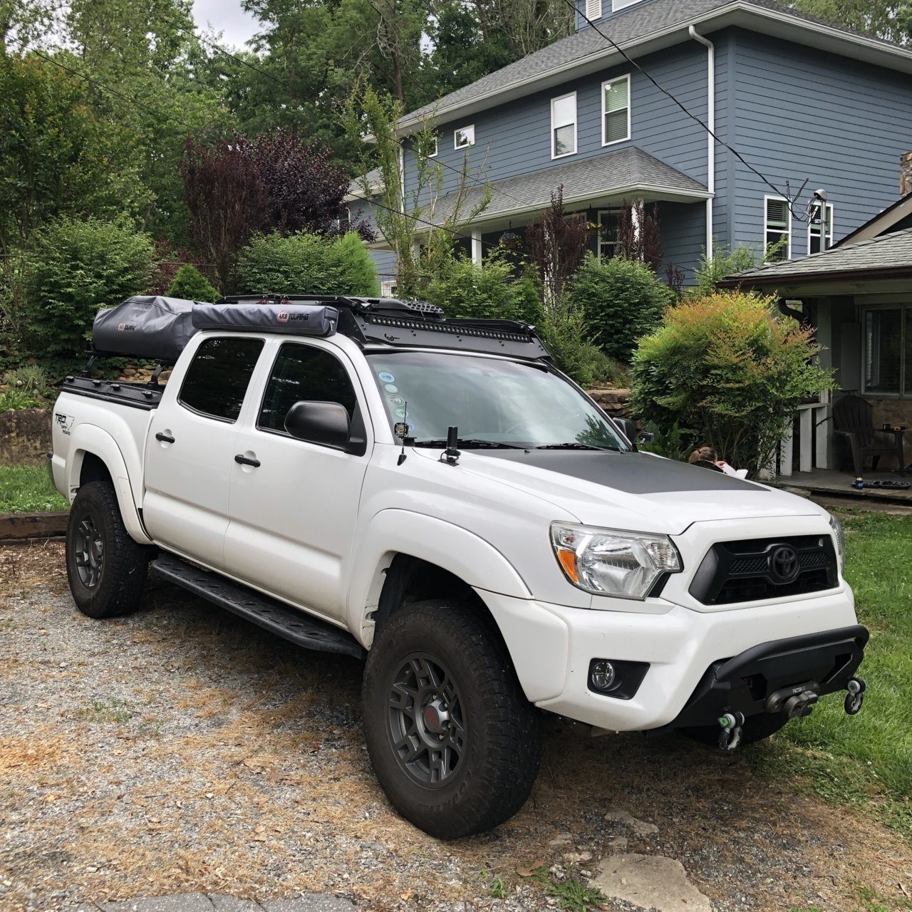

    4' ARB awning fits damn near perfect on the cab and still allows access to bike racks.

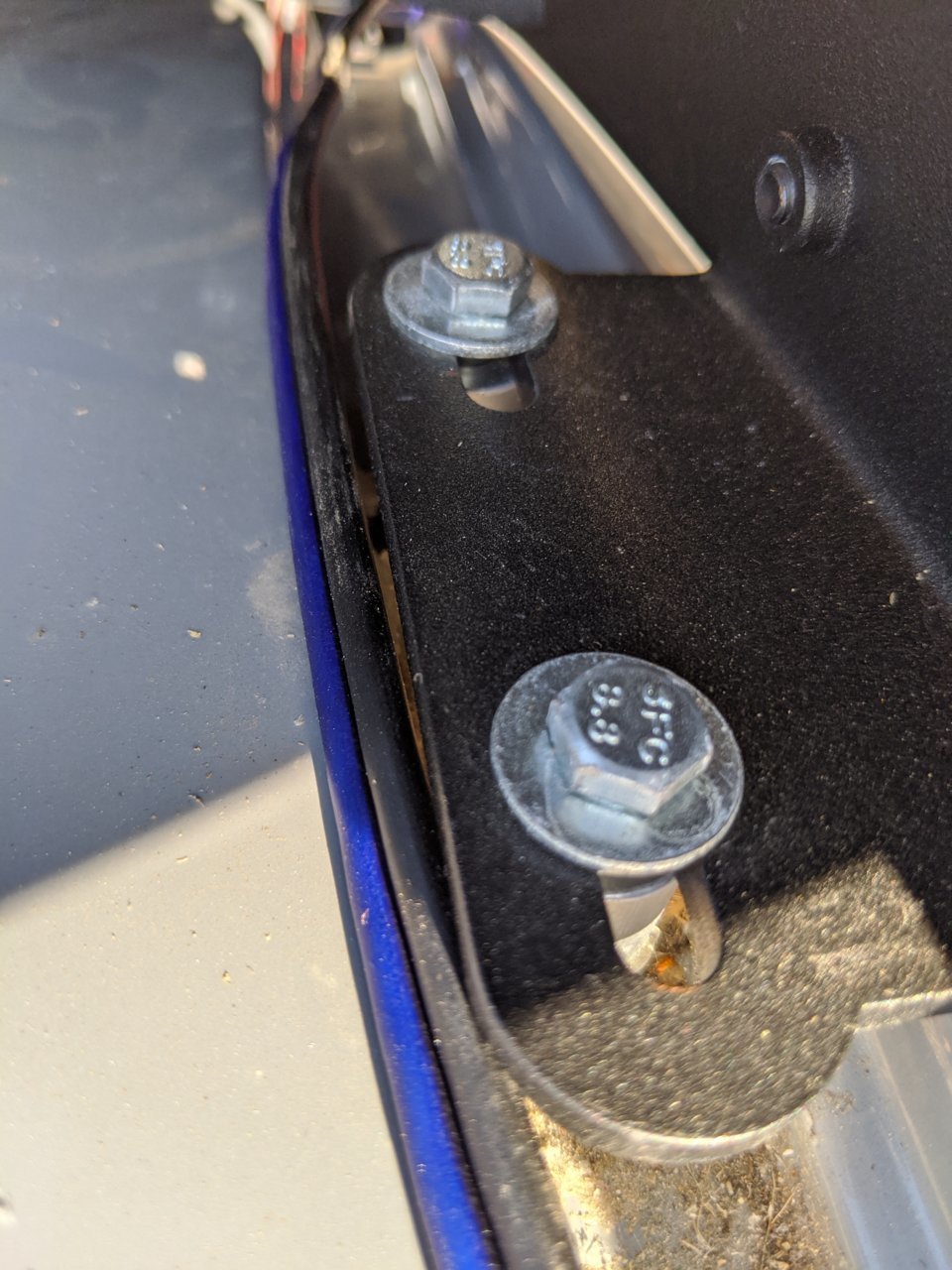

    Can ground the light bar to the prinsu rack bolts? MVIMG_20200627_075456.jpg
  9. Jun 27, 2020 at 8:19 AM
    Matmo215
    Matmo215 Well-Known Member
    Sep 15, 2016
    #197333
    7,646
    Matthew
    Waco, TX
    2015 Sport DCSB
    I tried and didn’t get good luck.

    2019 toyota tacoma trd sport long bed (cement)
    What did it do?
  11. Jun 27, 2020 at 8:23 AM
    Matmo215

    Flickered
  12. Jun 27, 2020 at 8:24 AM

    Where did you ground to?
  13. Jun 27, 2020 at 8:24 AM
    Matmo215
    Sep 15, 2016
    #197333
    7,646
    Matthew
    Waco, TX
    2015 Sport DCSB
    The bolt as it is the only unpainted surface

    It works fine for me, but my rack is raw aluminum. No powder coating or paint.

    Thanks I just ran another long cord to a ground under hood. Works perfectly
