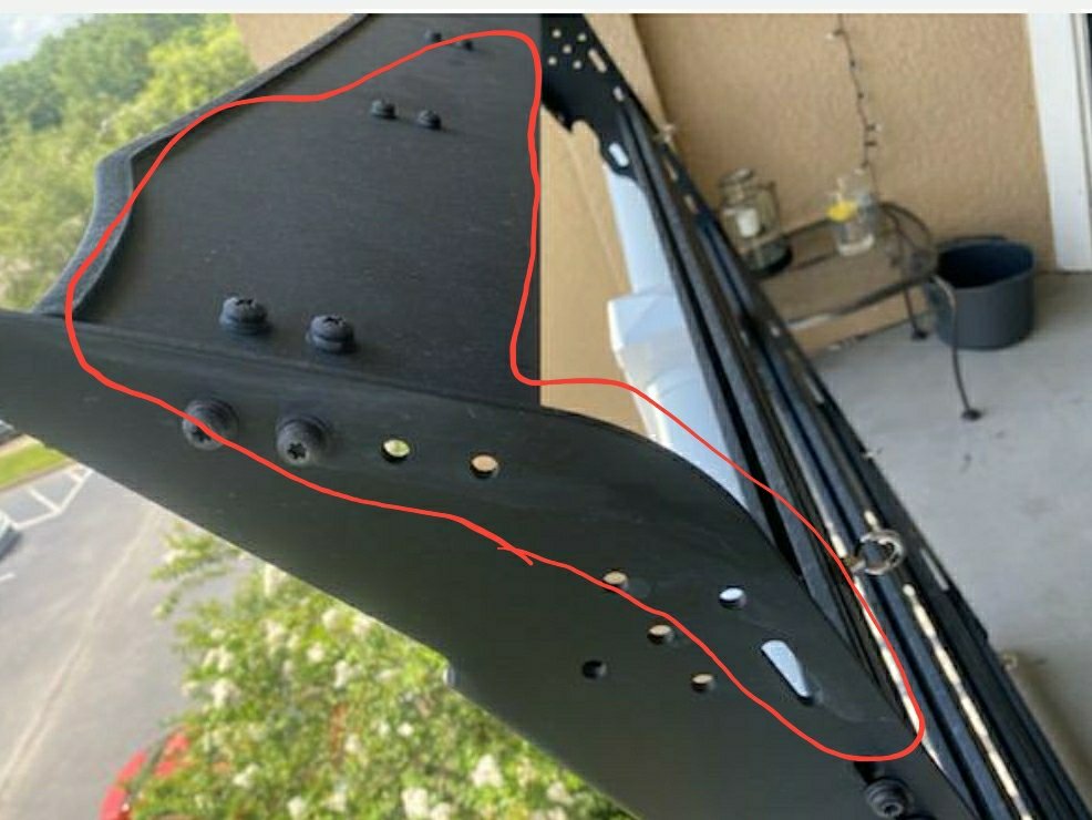

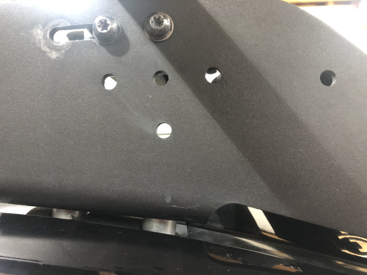

    Anyone experience staining or turning white on their prinsu rack? Any suggestions on trying to remove/clean/bring back dullness? I have never cleaned before, not sure what its from.

    I think it could be soap or a chemical reaction. I’ve had the same issue, but it usually washes off.

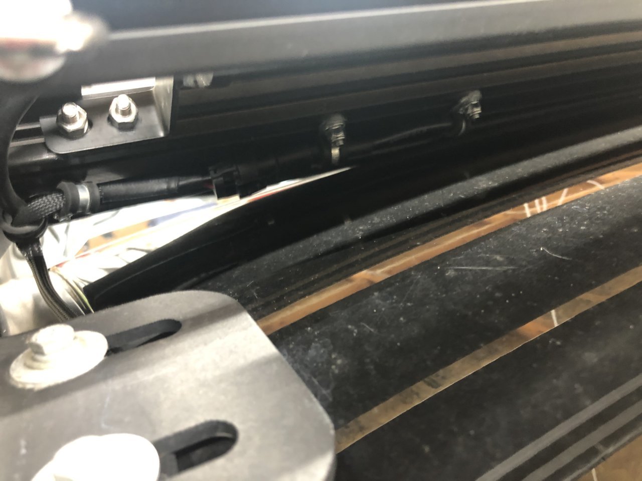

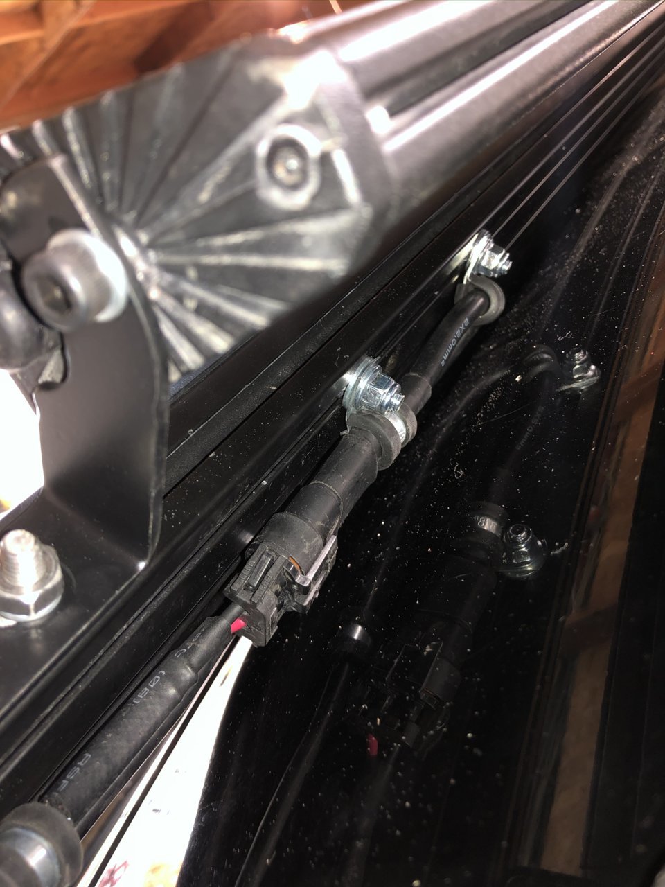

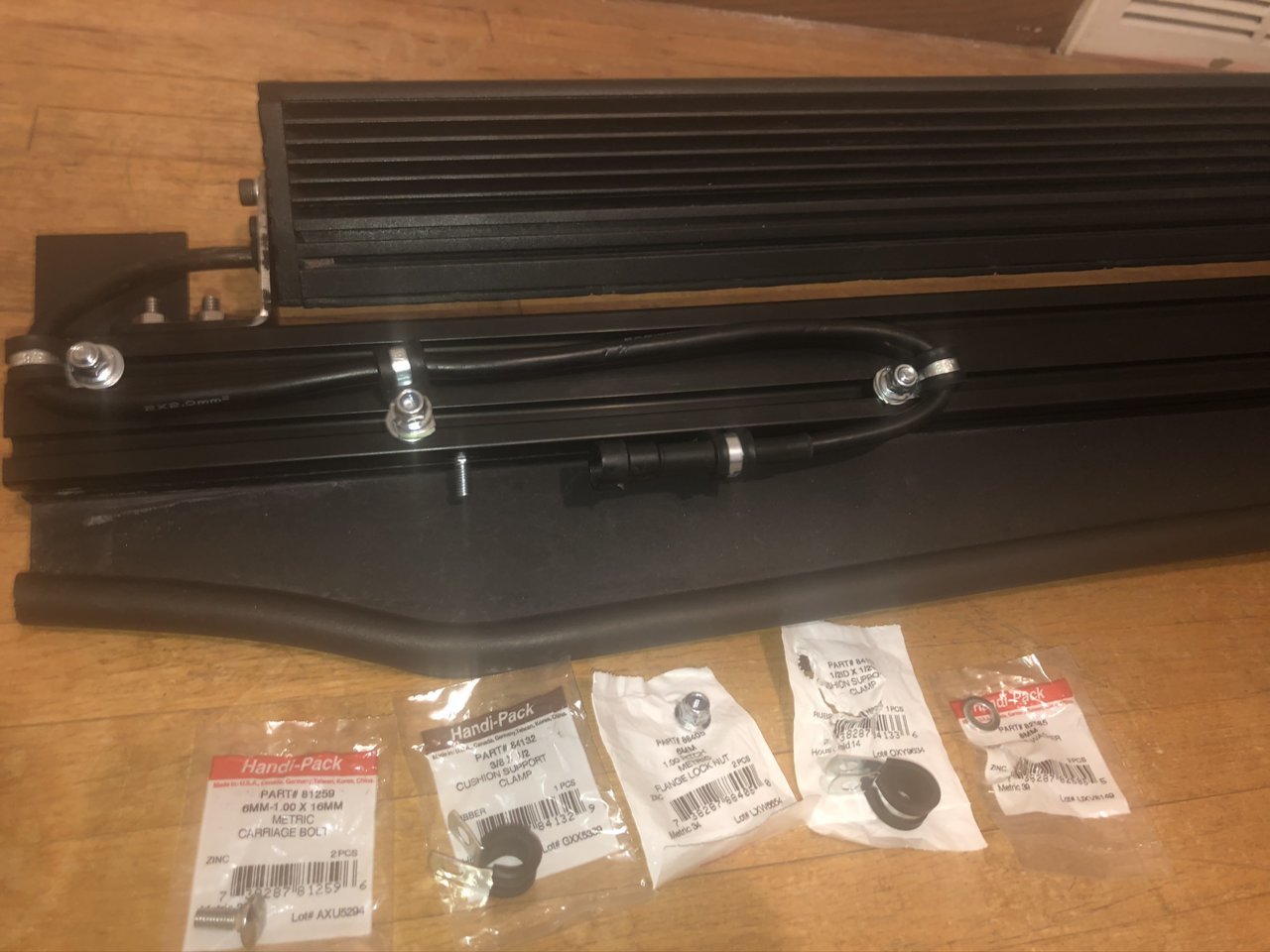

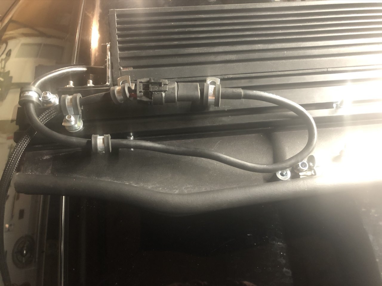

    I’ve been meaning to post this for a while. When I first installed my prinsu, I zip tied the light bar wires to the rack. After cutting myself on the zip ties every time I washed the truck, I bought a few carriage bolts and clamps and was able to clean up my wiring. No more cuts when I wash the truck!

    Damn I really need to do this, great idea!

    It's literally road grime. Look at the edges of your windshield where your wipers don't touch... same thing. Soapy water should remove it. Bug guts take more elbow grease. I'd suggest hitting the front and side panels with a light coat of spray wax that's safe for black plastics (Ice Spray Wax works). It'll cut down on the UV fading and darken it up a bit each time you wash.

    This set up is ridiculously clean. Any chance you can post links to the screws/washers?
    This is what I found so far
    https://www.tannerbolt.com/default.aspx?page=item detail&itemcode=25C62MFTS#
