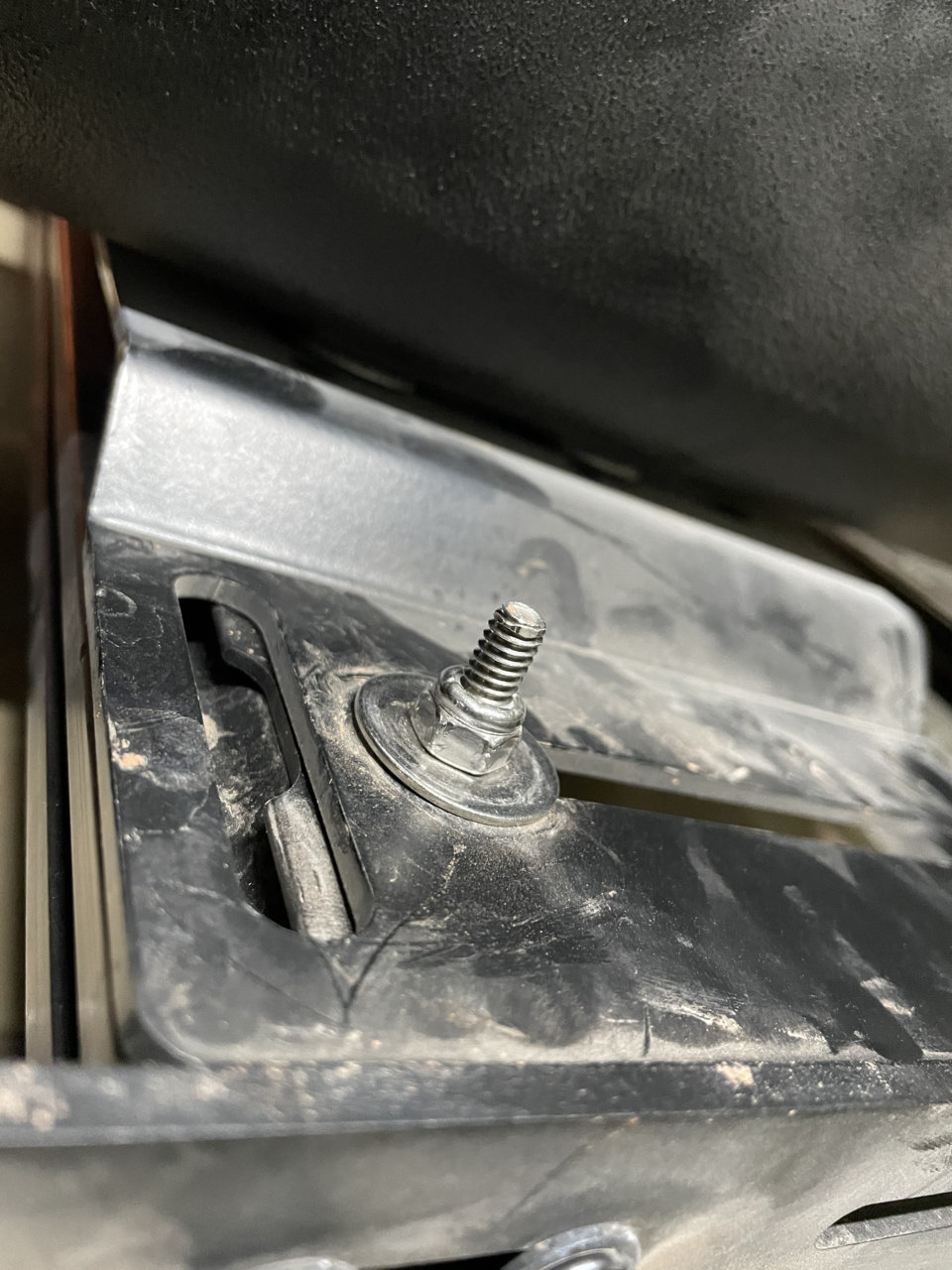

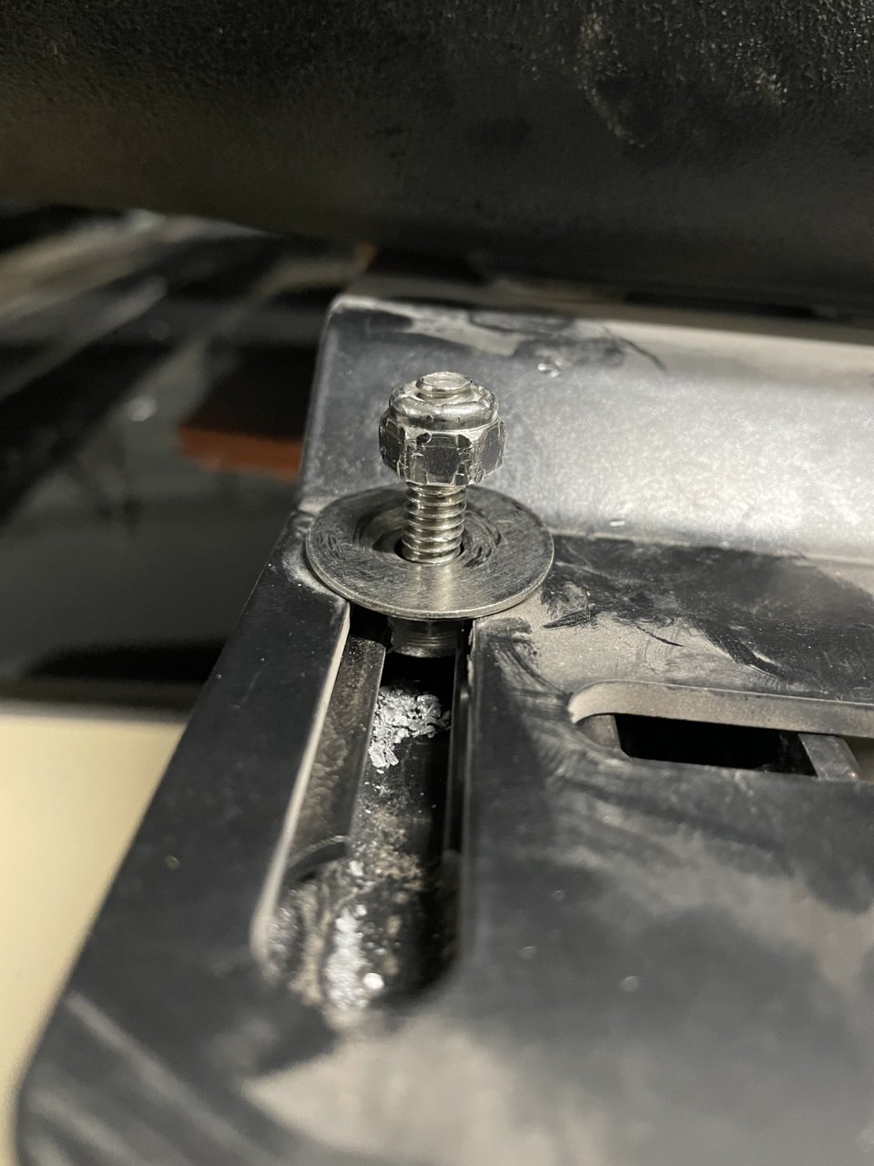

    So I ran into a little issue trying to remove my waterport from my prinsu last night so I can fit the truck into my garage. Looks like the square head on the carriage bolt is stripped which is causing the bolt to spin. I was able to get 1 but off but the other 3 are damn near impossible. My last resort is to just cut the bolts with a sawzall. Wanted to see if anyone has ran into this issue and has found solution. Any feedback would be appreciated!
    pics of bolts.

    Could try using a vice grip to hold the bolt (threaded part) while you use a wrench to get the nut off slowly :notsure:

    Did you get it off. I would remove the bar from the rack. If it spins freely it might just slide right out with a little encouragement. Or grind two of the sides of the bolt so you can get vice grips to hold tight enough so you can get the nut to spin off. Or just cut the bolt with a Dremel and go visit a hardware store.
