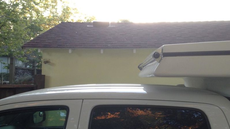

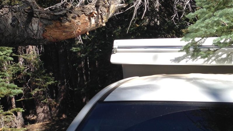

    Zach, has anyone approached you to see if the rack would work with a Flippac? I couldn't find anything using the thread search.
    I want to mount heavy- duty drawer slides under two cargo boxes. I can slide them out to the sides when the Flippac is deployed. There is plenty of clearance under the lid when it's deployed. It will be a tight fit under the portion that hangs over the cab on my DCSB camper. A shorter rack would work, but I want to use the rear mounting points.
    I can provide measurements.

    From your pic it would be a very close fit IMO.

    The clearance is a little higher where the side rails would mount. About 4". I'll measure tomorrow. The cross bars would probably not fit under there.

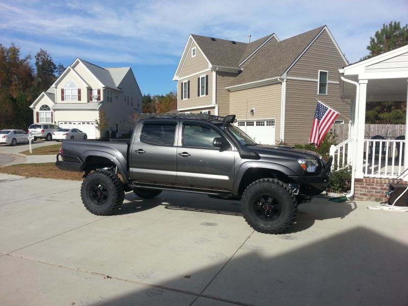

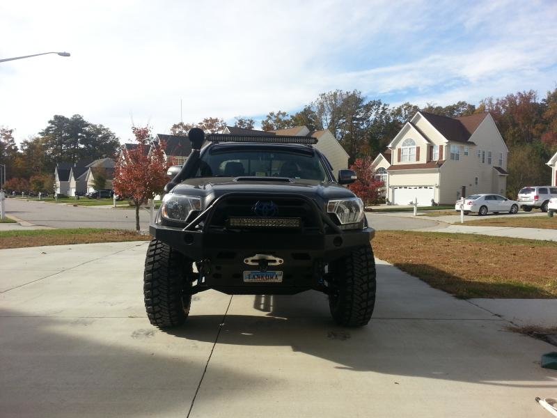

    Ummmm 50" on a Prinsu rack is sexy...

    NICE! Not going to lie, when these racks end up on trucks I have drooled over for some time it makes a monday that much better. What light bar did you use?

    50" Sidetracked Offroad. He made me a deal I couldn't refuse!
    I do however need to 2 more crossbars now...it's almost even all the way down and the OCD is driving me mad already.

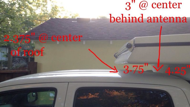

    It will be very close. Under the rearmost bar, what is the height from the bottom of the bar to the roof? I was thinking that the rear bar could be lowered. There are no concerns with deflection since that bar will never be loaded and just used to tie the sides together. The rest of the bars would be forward of the Flippac nose. Please see the attached image.
    The drawer sliders would either be mounted under the boxes or attached to aluminum angle vertically. That would increase the bar's rigidity and reduce deflection, so maybe the rack could be mounted 1/2" lower. Maybe bend the angle 1/2" higher? Please let me know if that's an option.
    I would probably only put light things on the roof (tow straps, fippac rain fly, dirty clothes, extra diapers) in lightweight aluminum or plastic boxes. Definitely some thing to be concerned with though.

    Did some measuring and we should be able to make something work. These are my measurements in the approximate locations you are showing.
    2.375" = 1.875"
    3.75" = ~3.375"
    3.00" = 2.5"
    4.25" = 3.75"
    The first measurement is the most important since the crossbar can't go any lower on this one without worrying about defelction. The others can be lowered.
