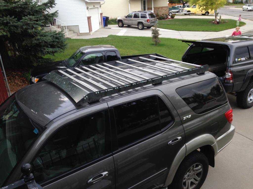

    Hey Scott. I need this rack in my life for the first gen sequoia and it’s not listed on the website. Sequoias are starting to make their way into the overland scene and I’m sure that wasn’t the case back in 2014!!!

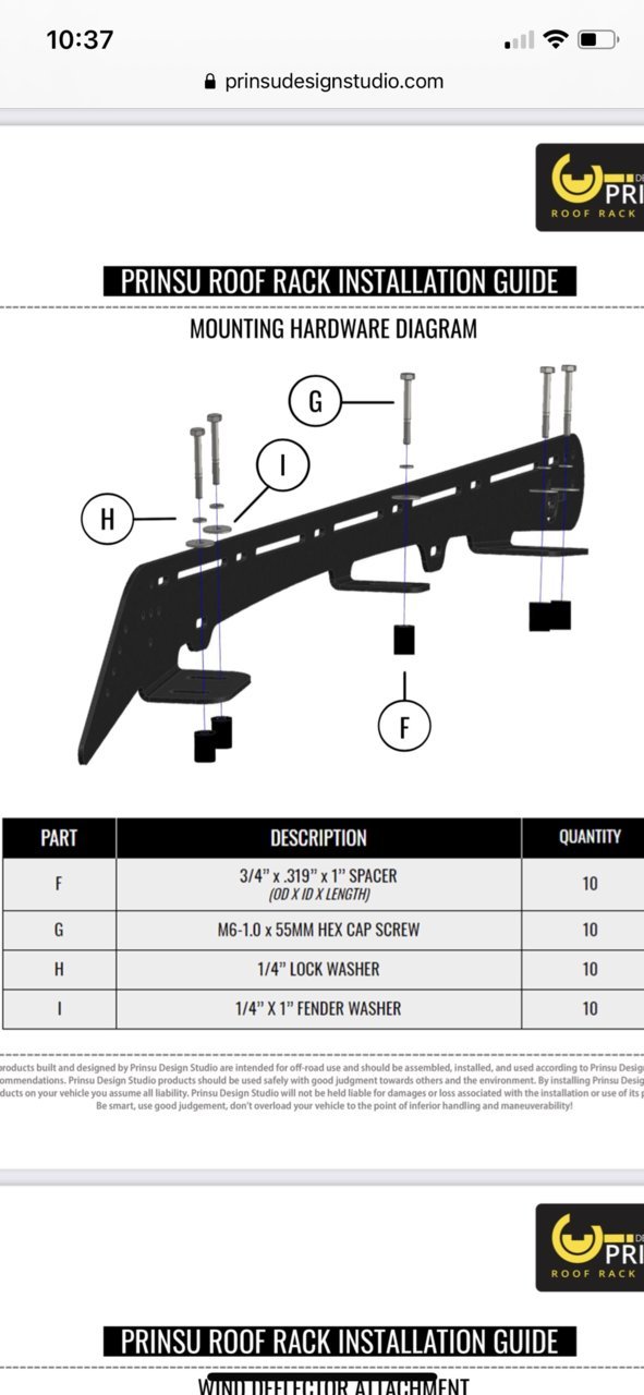

    Heres the hardware list for the mounting points. I ordered these to use on my home made rack I’m building.
    M6 x 55mm (Pack of 20) Flat Head Hex Socket Cap Screws Bolts, 304 Stainless Steel 18-8, Countersunk Connector Screws for Furniture Baby Bed Chairs, Bright Finish, Full Thread https://www.amazon.com/dp/B08JCC3778/ref=cm_sw_r_cp_api_glt_fabc_QA436VMR361ESPMVAN6Q?_encoding=UTF8
    As far as the spacers go, I was going to cut some 3/4” aluminum tube spacers.

    Thanks @Gregthespy, appreciate the link. I’m going to look around more for something to use for the spacers — I’d already quickly searched online and found some decent leads, but nothing in the exact right size that Prinsu listed there yet.
    Still can’t believe they won’t just sell extra hardware…

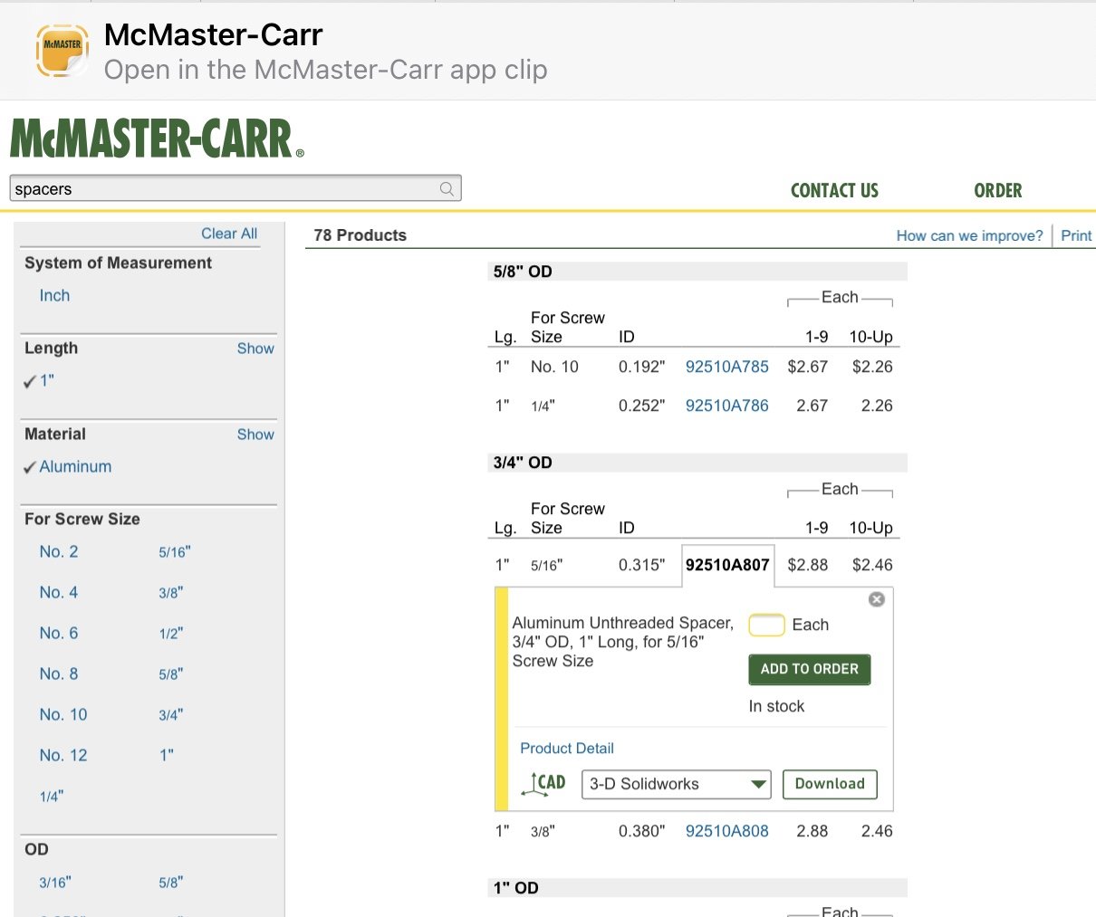

    McMaster Carr is the go to place for unusual hardware. These spacers should be a near exact match. ID is slightly smaller but still oversized for a 6 mm bolt
    https://www.mcmaster.com/spacers/length~1/material~aluminum/
