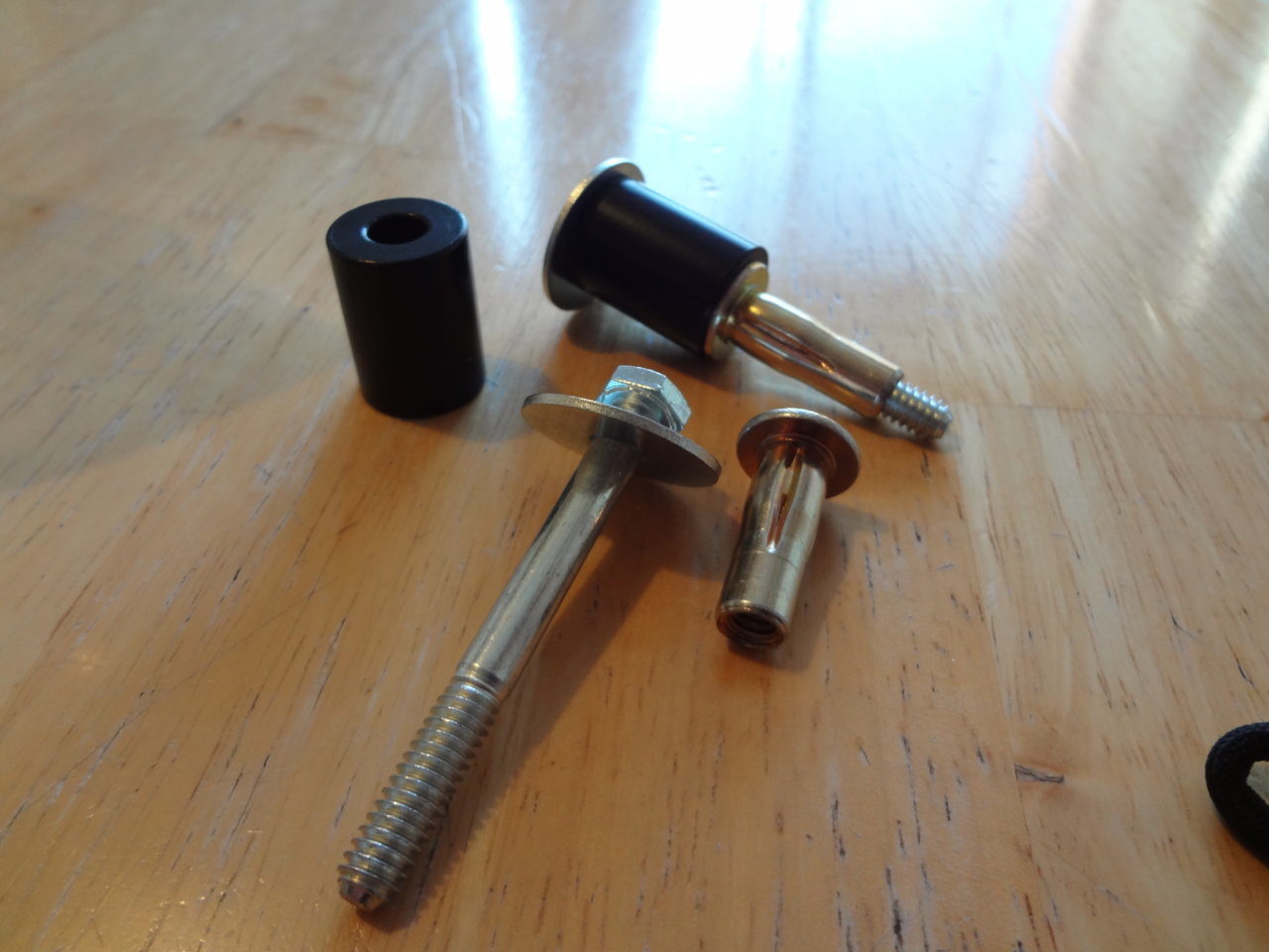

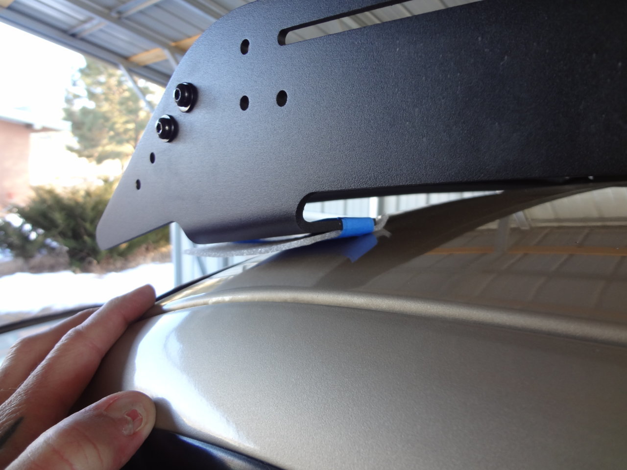

    Great 1st gen rig you got there. I have a 1st gen extended cab like yours and am wondering- how you accounted for the angles not matching up, the gaps between the rack legs/feet and the contoured sheet-metal roof (can see in pic). It seems if I drill and put the plus nut/spacers they will come out at the same contoured angle(s) of the metal roof they go into.
    I'm not too sure about these 1" black spacers that came with mine, seems like they are for the newer trucks with channels/gutters and weatherstrip possibly.
    I love the product, just need to figure out how to install right.
    Any info. much appreciated!
    Really nice truck there.

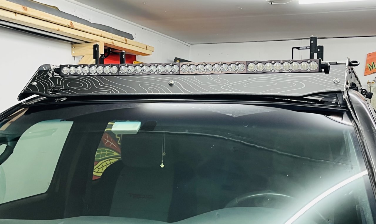

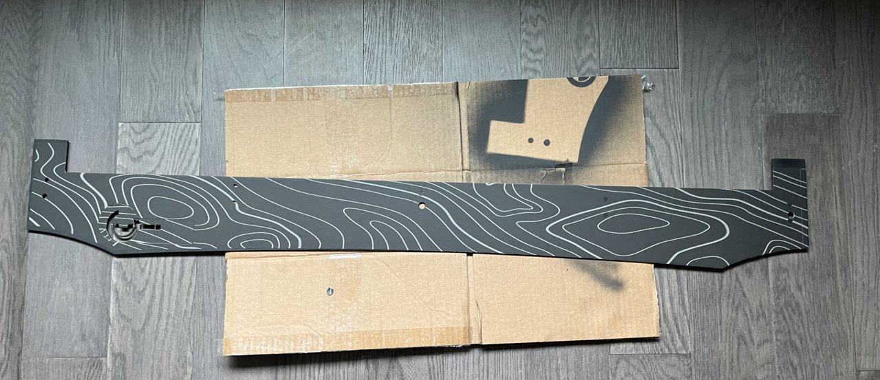

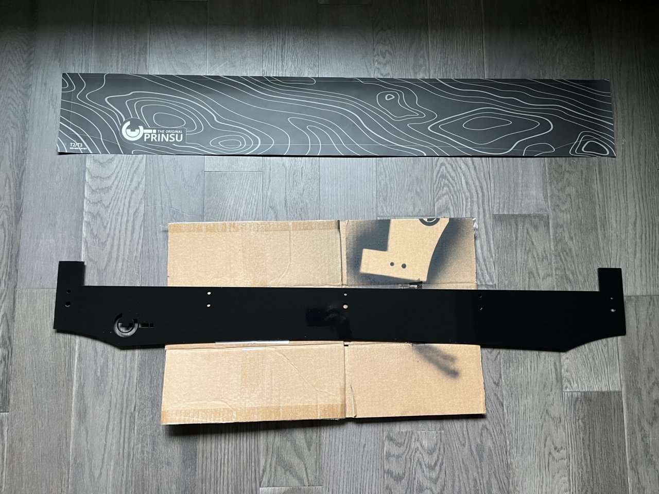

    Clean and subtle.. although, being an OG prinsu customer, the vinyl didn't line up perfectly.

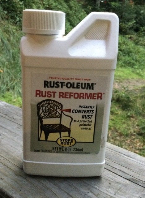

    I have some rusty hardware that I was going to replace, but read somewhere that people had issues with them rusting and breaking when trying to remove them. I would want to avoid that altogether as it would be a headache to replace all the hardware on a full rack. Is there some type of black paint that I can use to paint over the rust and have a decent looking finish that will last a while or allow for future touch ups?

    You can try this. Supposed to neutralize rust and turns it black in the process. Rustoleum recommends painting afterwards. They also have “Rust Stop” spray paints in different colors that claims to do same for light rust. Neither dissolves rust, so if you have a rough surface build up of rust, that will remain rough.

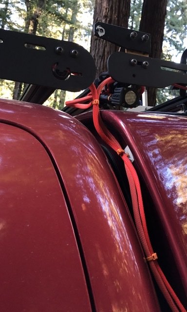

    You may want to consider the Rigid Ignites to illuminate the bed. They put out a lot of light for their size. I got them under my Prinsu and above the camper shell and you can eyeball from this pic if they would fit your location.

    Thanks for the pic. Would you be willing to take a measurement between the bottom of the rearmost roof rack rail and the roof? I’d like to figure out my space constraints before committing to one light or another.
    *Edited to add*
    It doesn’t look like Rigid makes snap-on opaque covers for their Ignite light series, so those won’t work. Gotta make sure I have the option of legal compliance.
