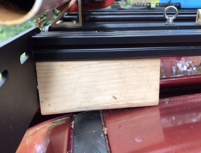

    This should give you an idea of the space. This is a 5-1/2 by 2-7/16” piece of wood. It’s a tight fit under the bar. Roof curves down further back so you might get something larger to fit if you hang it behind the bar.

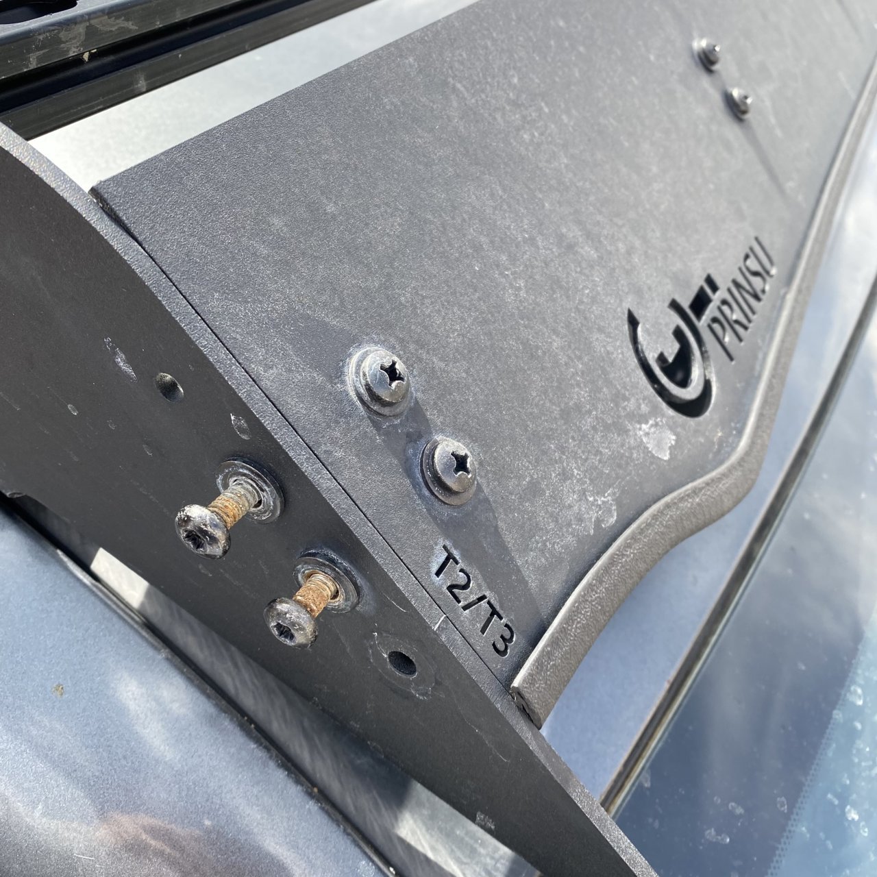

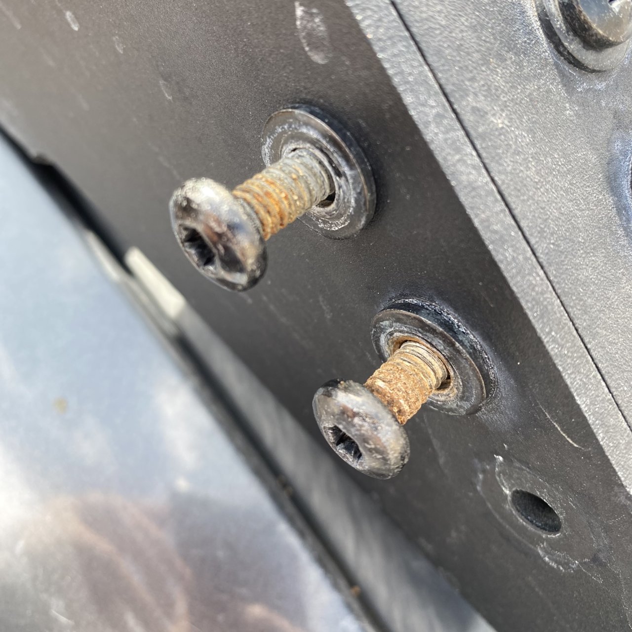

    8 months of ownership and I’m greeted to this.
    5C1976A8-EC65-4176-B7A5-0398EADDE277.jpg 34CBEB75-4712-4BC3-BB0C-BE19498FCF8C.jpg
    The quality of the hardware has gone down to shit with CBI taking ownership. It’s rusted on all my bolts.

    Not surprised. My CBI swingout rear bumper started showing rust about 2 weeks after install (plates, welds, and hardware). The prinsu/CBI awning mounts I have are rusting. The Prinsu rack hardware is rusting. In contrast, the Saints Off-road steel front bumper I've had for almost two years (and beat the heck out of) is showing zero rust issues.

    I got my rack from Zach in 2016, and those bolts weren't stainless back then, either; I haven't pulled any of mine out lately but I wouldn't be surprised to see rust on them. I also ended up having to swap in Grade 8 hardware for some of the mounting bolts after one of the bolts in the kit had its head shear off when I tried to torque it down.
    I can't speak to CBI's quality since I've never bought any gear from them; I'll likely be in the market for a rack for my T4R sometime in the next year or so, and haven't really though too much about whether to get a prinsu or get one of the knockoffs (I've got a rear bumper/swing-out and several rigid molle panels from Victory which have held up pretty well). If there has been a drop-off on Prinsu stuff though, it doesn't look like the hardware in the kits has changed.

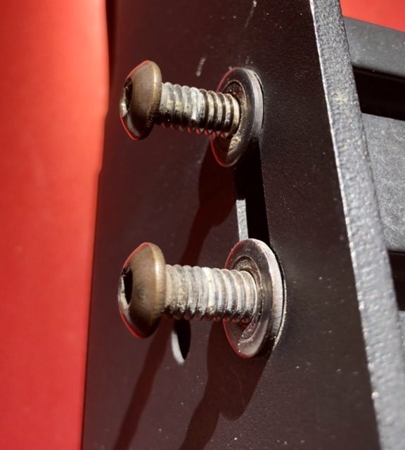

    Replaced mine with 18-8 stainless with black oxide finish from McMaster Carr about 4 years ago.
    Took this picture today to compare to GumShoe. Screws look good but did see white flakes while unscrewing which I’m guessing is aluminum oxide corrosion off the aluminum. Going to have to do some research on best anti seize to use for stainless in aluminum. PS: Black when installed, color on heads faded to brown after about 6 months in the sun.

    Aluminum will corrode at some point if it's got any kind of conductive path to the body of the vehicle; boats use aluminum for galvanic anodes when they're operating in environments where zinc or magnesium are considered to be insufficient. Good news is that in many conditions, the roof rack will provide some degree of galvanic protection to the frame and body panels.

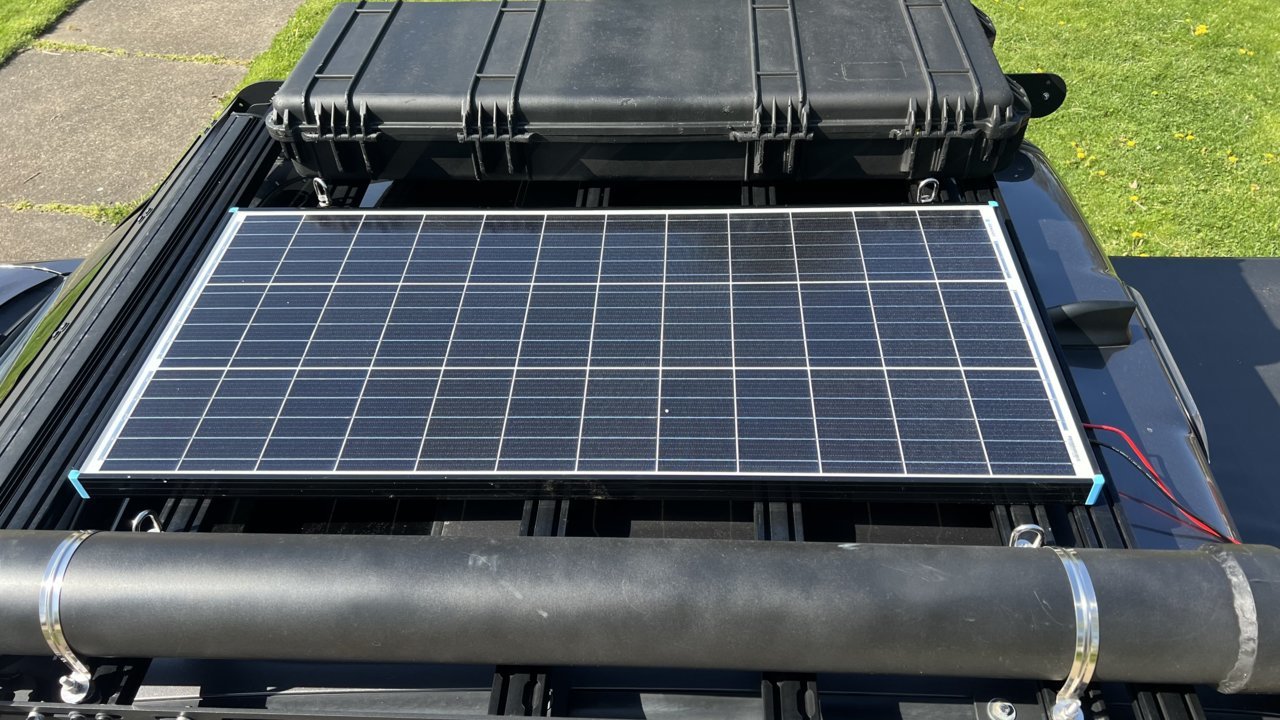

    Got me a solar panel today. Any suggestions on how to mount to the prinsu for easy removal?
