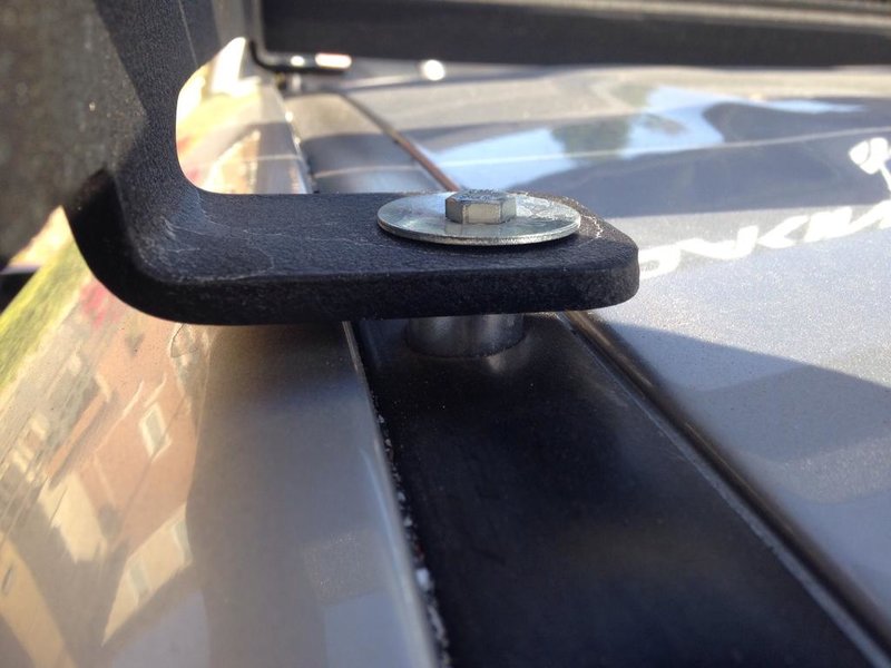

    Pull the whole weather strip off, peel the tape off that is covering the OE holes and then put painters tape on the roof of the truck adjacent to the OE holes. Next use a builders square or a speed square butted up against the body line of the rain gutter to make marks on the painters tape where the center of each OE hole is. Then replace the rubber strip and transfer your center marks from the painters tape back onto the weather strip. Take the weather strip back off once you have it marked and use the punch on top of a softer wood surface IE a scrap 2x4.
    I used this method and my marks turned out perfect - see photo.

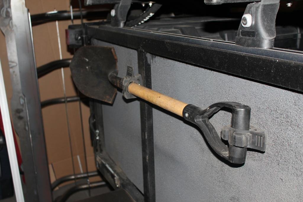

    Yep, that's how we do it Zach. The options with QuickFists is endless!

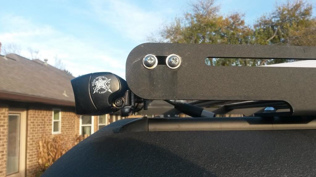

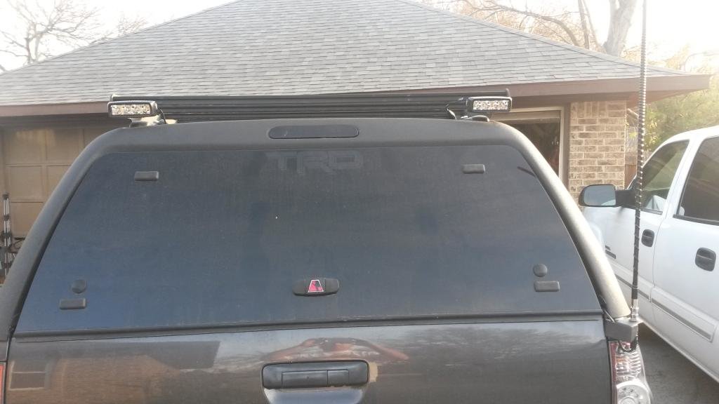

    I added some Rigid SRQ2 in wide for reverse lights. I will finish wiring them this weekend. Way over kill for reverse lights but why not.
    How did you mount the pelican? Drill through the bottom? I am considering doing the same to store my recovery 1st aid gear to get it out of the bed

    I considered running back up lights like this. How did you run the wires?

    I zip tied them to the front of the cap then down between the bed and body to my fuse panel next to the master cylinder. I don't like it so I am going to redo it with the wires going down into the cap the rear cap window then under the bed from there.
    I hope that makes sense
