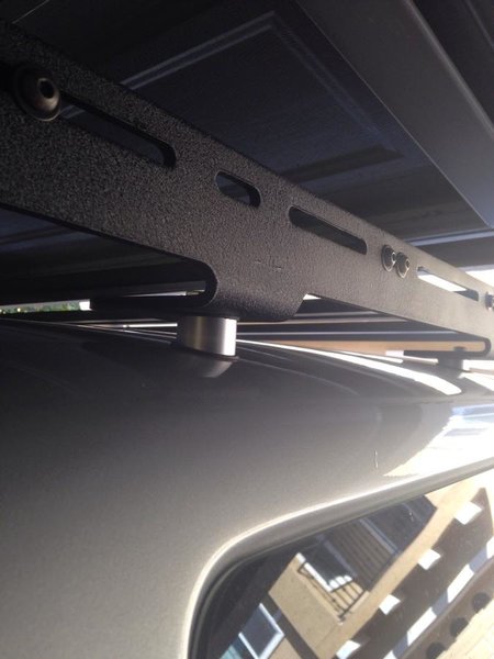

    Zach,
    Just wanted to leave this photo here, had one of your customers contact me about mounting the caprac without Thule rails. Basically just use a chop saw to cut 1 1/4" OD aluminum pipe to create wedges. If your shell is convex in all directions all 3 pairs of spacers you cut will be different heights to truly level the rack. I also bought 1 1/2" rubber washers at Lowes and punched the center holes much larger so the rubber washer could be more adjustable to move with the spacer as you adjust the spacers and level the rack...hope that makes sense.
    I mounted my cabrac first and then clamp an aluminum yard stick to the cabrac across the top of the cross bars sticking off the back toward the shell. That gave me both a lateral and vertical mark to align the caprac with. You could probably get away with laying a couple of 2x4's across the cabrac and use them as guide to align the cap rac.

    Nice job! Looks clean

    Awesome, thanks for posting that up. I am in the process of making a table of contents in the beginning of the thread so info is easier to find.

    Thanks ! ...it was admittedly my second idea, the first idea was urethane spacers I got from energy suspension but it was impossible to cut or sand them to appear as clean as I wanted them to be....damn OCD ;)
