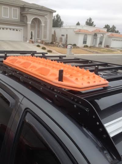

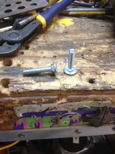

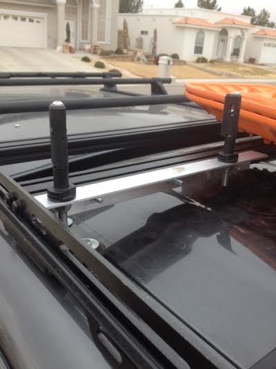

    I posted earlier about grinding elevator bolts to fit into the track, after cutting and grinding I found an easier way to attach stuff the tracks on the rack.
    1/4 carriage bolts slide right into the tracks.
    I attached angle iron to mount my Maxtrax bolts to, I didnt want to drill a hole thru the cross bars.

    Nice! Came out pretty awesome.

    +1! I think I am going to go this route. Would the slot nuts that came with the rack no work in those tracks on the side?

    the tslots are the same on all sides of the cross bar so any hardware you find that will work should work on all of them.
