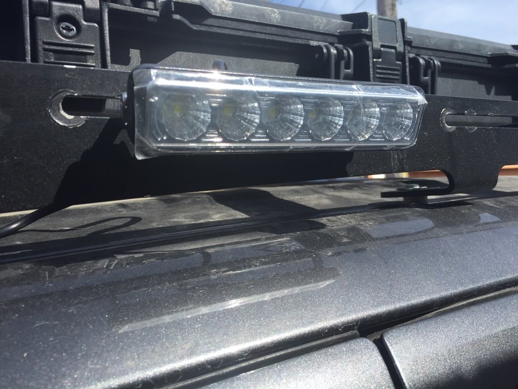

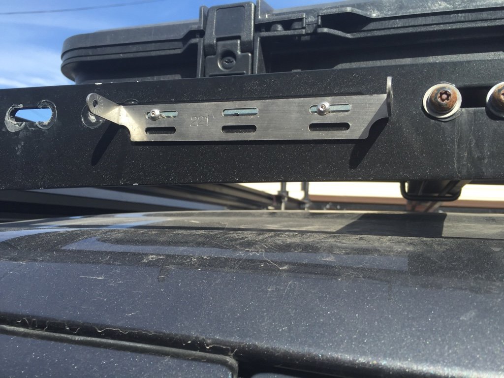

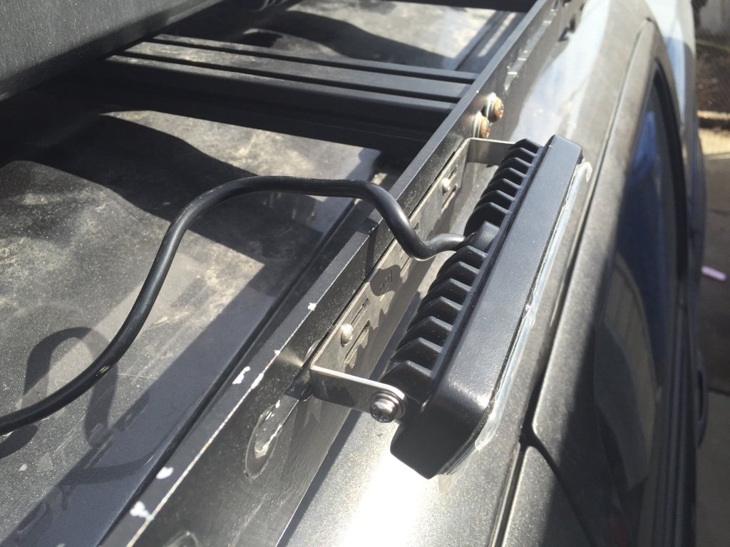

  9. Mar 14, 2015 at 2:56 PM
    #1669
    geekhouse23
    geekhouse23 The "Liftman" - @DrFunker
    Jul 14, 2013
    #108251
    15,719
    2GMGMDCSB4WDTRDFTMFW!! TL;DR
    mostly stock, grocery gettin' Prius
    Just wanted to share what I am working on for lights off to the side of the roof rack..still a rough draft :eek:
  10. Mar 14, 2015 at 5:04 PM
    #1670
    loco
    loco Who wants to ride my Brack Burrito???
    Dec 2, 2012
    #92254
    6,351
    Phil
    Virginia Beach, VA
    1996 Diesel Land Cruiser AKA Brack Burrito
    Well its a land Cruiser with a diesel so I've got that going for me.
    I really thought about doing lights off the side like that but didn't see the reward vs having a light hanging off the side of the rack. I carry a big Ole spot light for that kind of stuff and am wiring some high powered rock lights up next week.

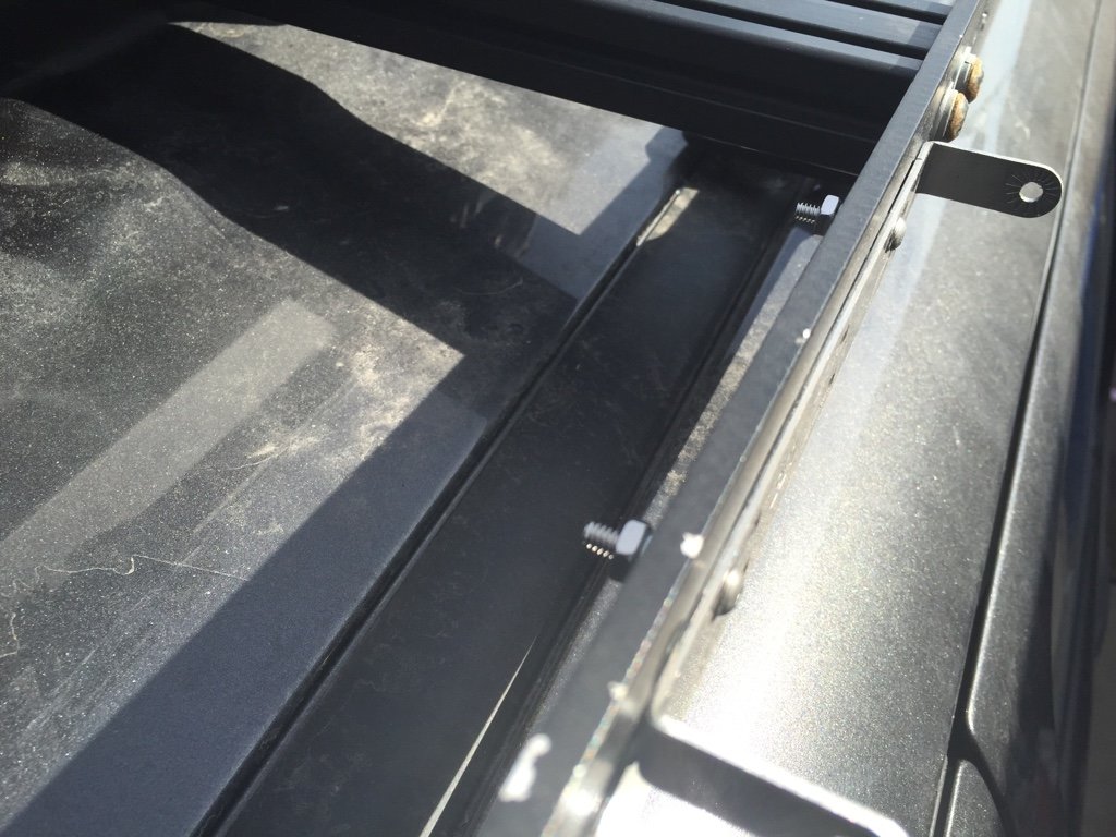

    What kind of bolts are you using in the channels to secure it?
  19. Mar 15, 2015 at 4:21 PM
    #1679
    zscott
    zscott [OP] Well-Known Member Vendor
    Jul 16, 2013
    #108365
    3,742
    Zach
    Utah
    13 DCSB Off-Road 4x4
    A 1/4" or 5/16" (depending on the model crossbar) stainless carriage bolt will slide on as well. Then stick a washer and a nylock nut on and call it good.

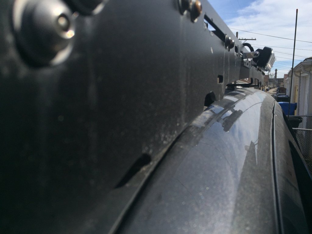

    What is everyone doing about touching up the side rails and preventing the oxidation issues once you install and remove hardware? Looking at that last pic, it seems that there may even be that issue after tightening down the bolts for the first time.
    Would you think maybe some rubber/nylon washers would resolve this problem?
