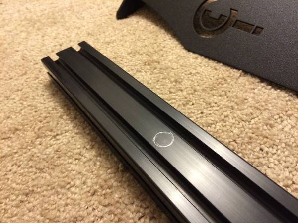

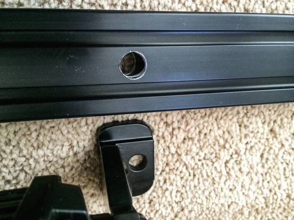

    assemble the mounting arms onto the light bar.
    center the lightbar on the crossbar and measure dimensions of where the lightbar mounting holes end up. measure twice.
    use a center punch and mark the center of your drill location.
    drill through the crossbar and mount using heretic-provided bolts (size M10, pitch 1.5 mm). the photo shows the standard nuts they sent, but i opted for security tamper-proof nuts. i bought a large washer for the backside.
    waiting on my OTRATTW switch and remaining tamper-proof bolts for mounting the crossbar to the rack itself.
    hope that helps.
