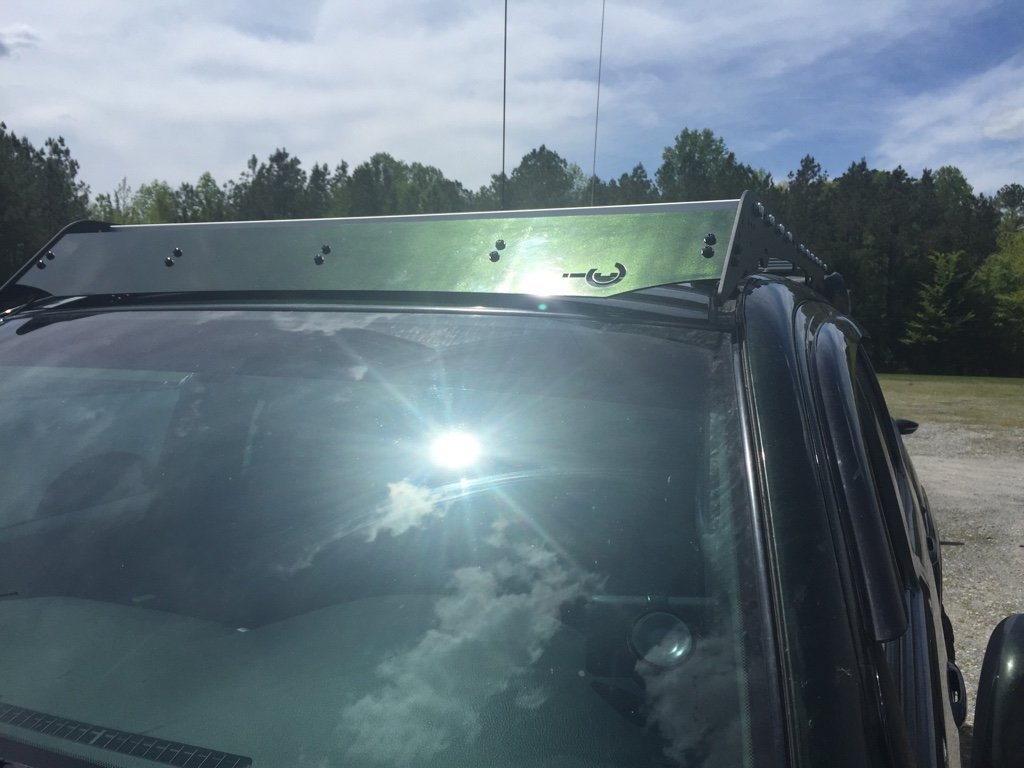

    Thanks dude! Rain finally stopped here so I'm clear coating the fairing then should finish up once that is cured.
