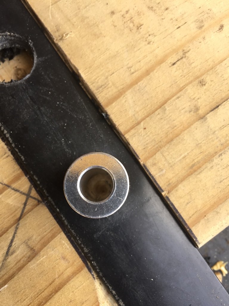

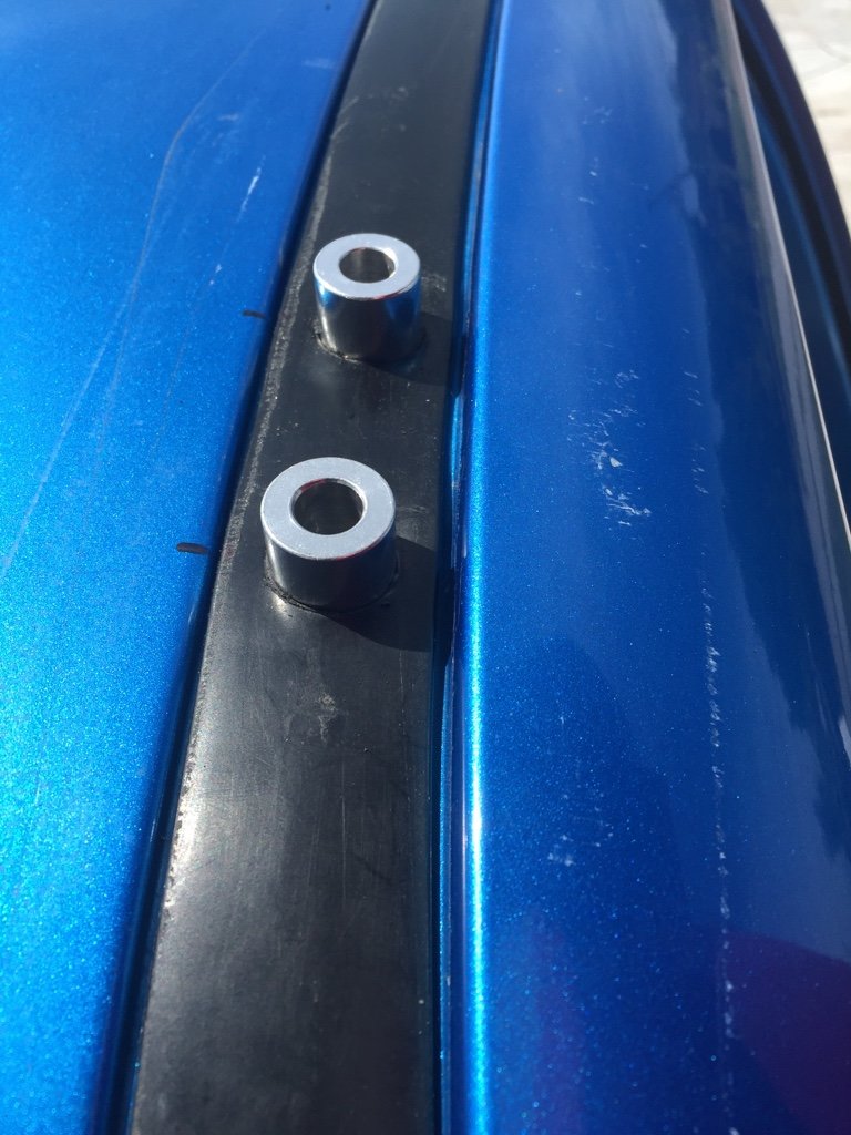

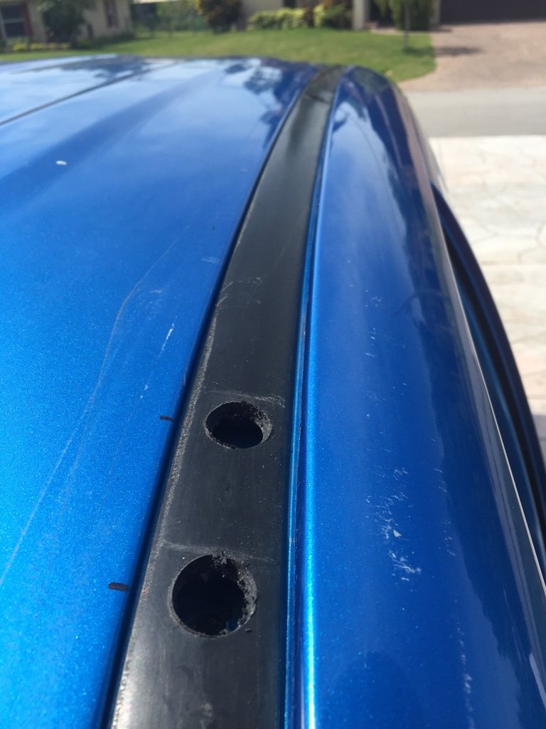

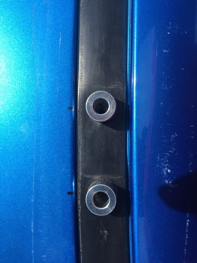

    When I installed mine, once I had the bolt holes in the roof exposed I ran a bead of silicone around them and pushed the spacers into it. So far the truck has stayed dry inside

    I recommend using a glob of silicone or RTV sealant on the hole. Then stick the spacer on and set the rack on top. After it is centered go around and thread each bolt in. Once they are all in loosely, tiighten them up which will work the sealant down into the threads as well as smash it between the spacer sealing around that surface where it meets the truck roof

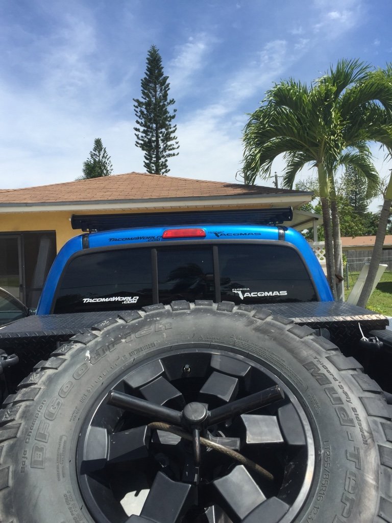

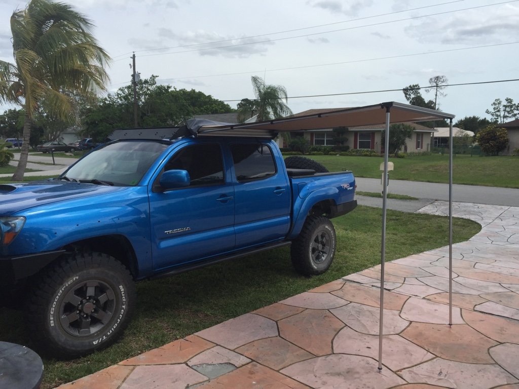

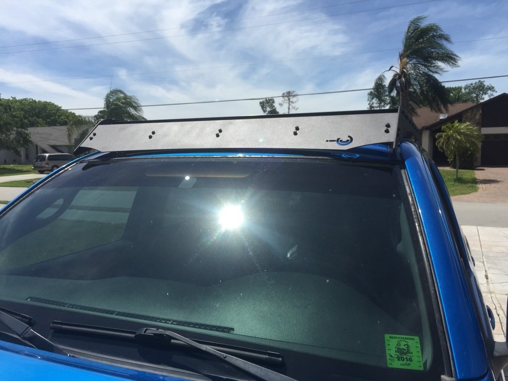

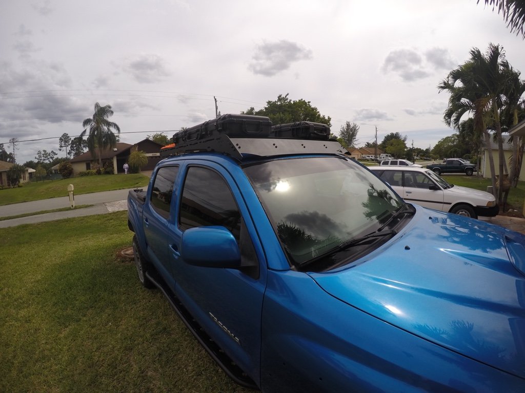

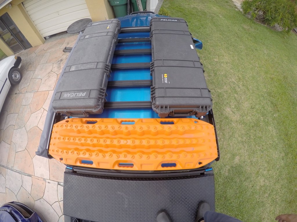

    Love this rack , sill have to figure out how(where ) to mount my maxtrax and pelican cases I maybe mount it this figuration maxtrax on rear and pelican on the sides

    Awesome, clean and neat install man. Can't wait to get mine!!!

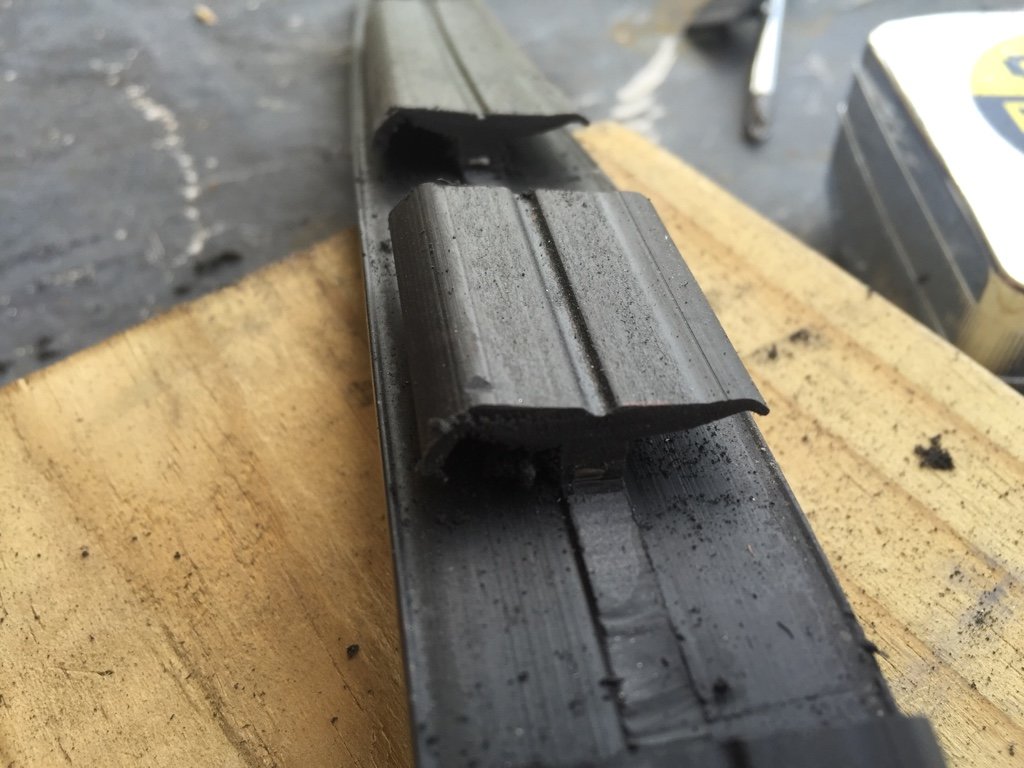

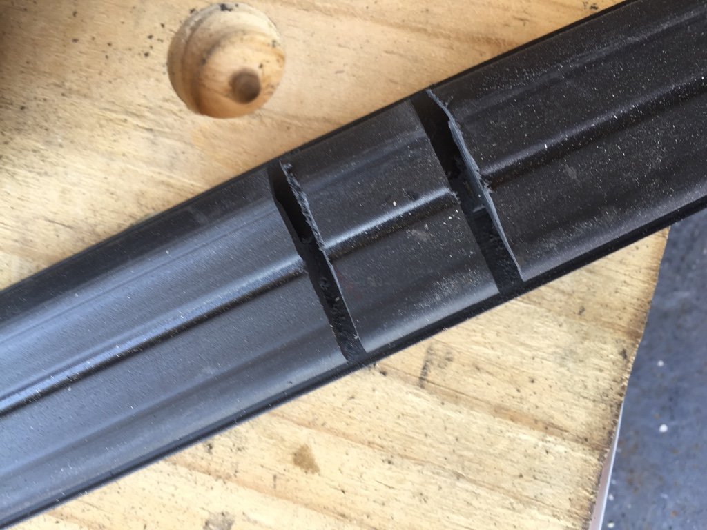

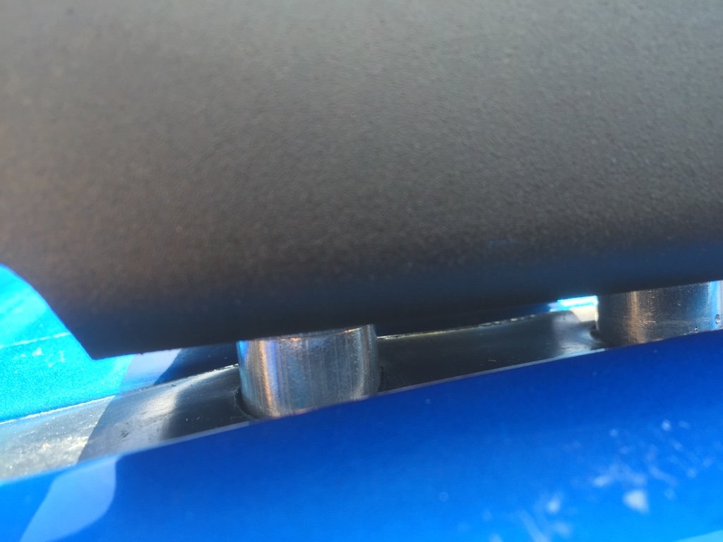

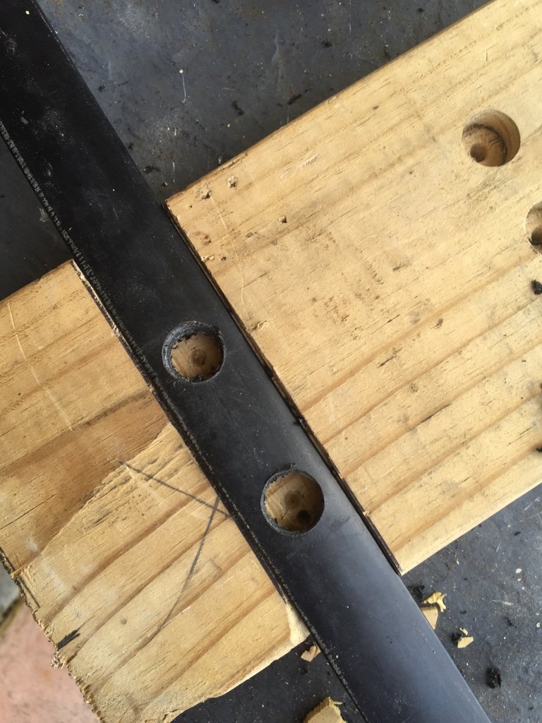

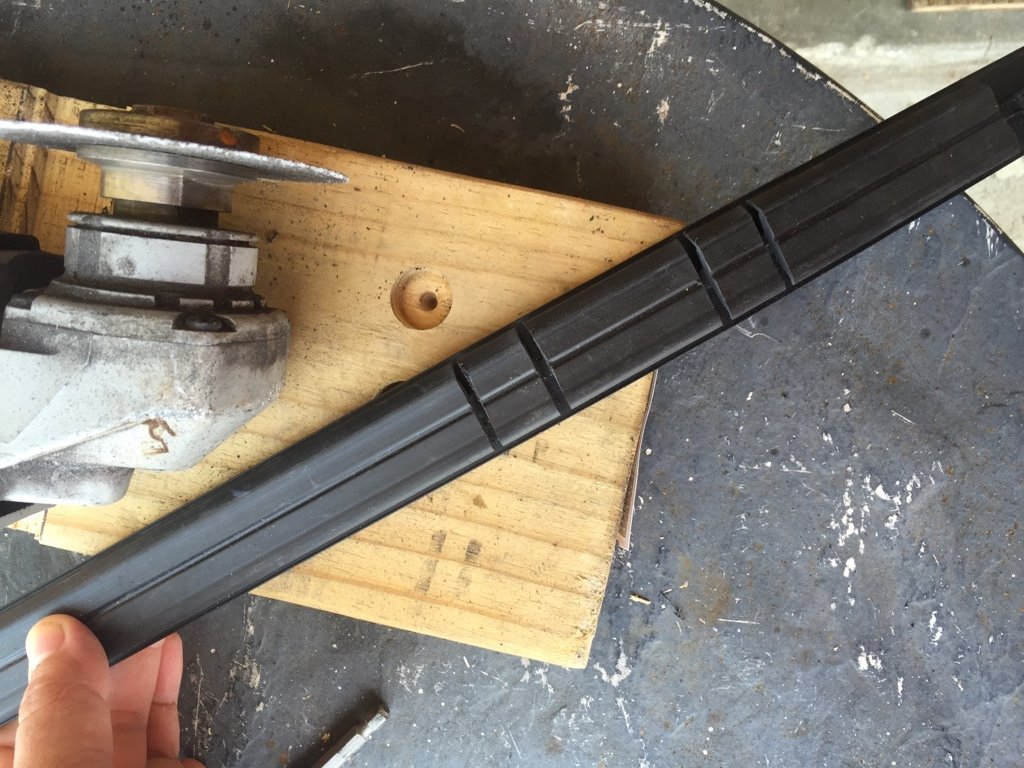

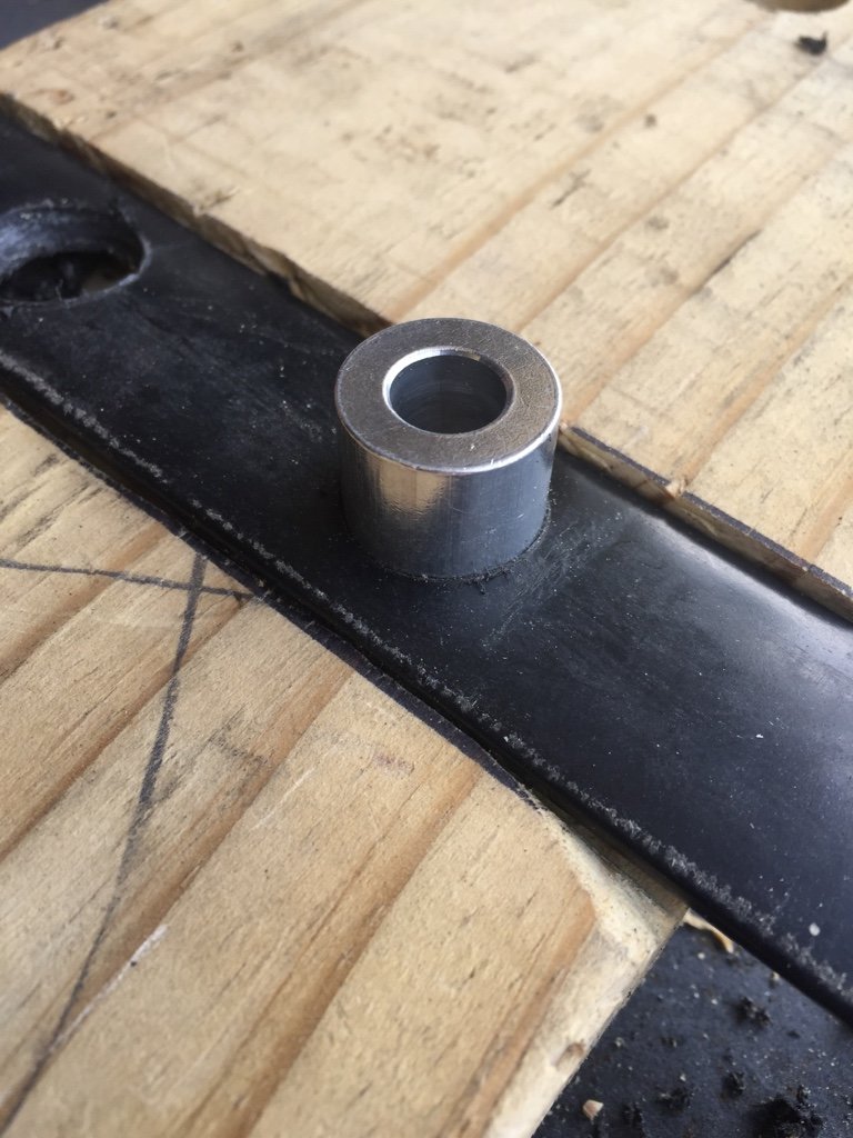

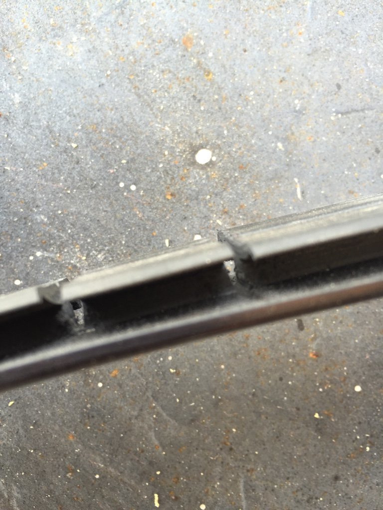

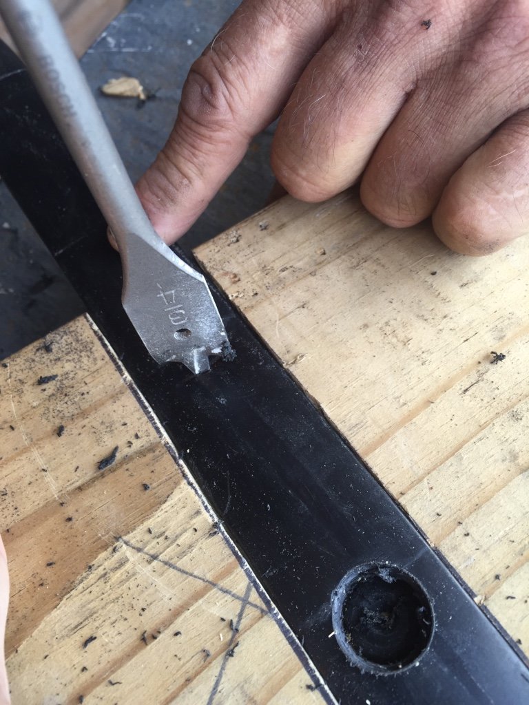

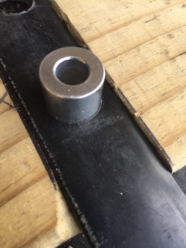

    I didn't have the right tools to get through that metal piece in the weather stripping without destroying it. So I put it on without. I'll just cut it in to strips and 3M tape it down.
    Did it get installed though, it looks bad ass. Thanks !
