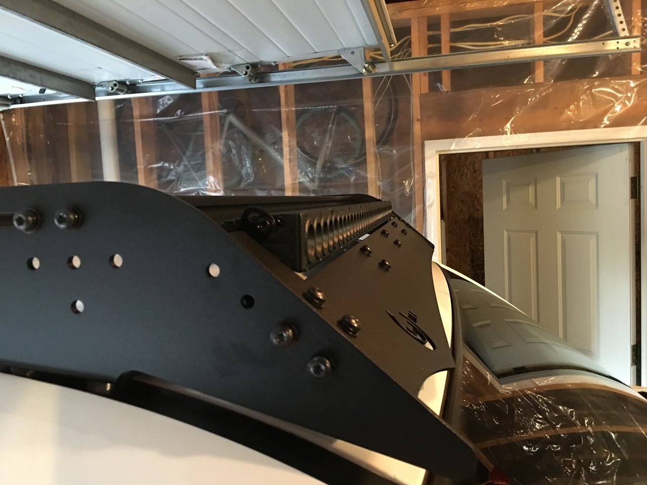

    I'm having some trouble mounting my Morimito light, I feel like the brackets are too short? How did you attach yours?

    I think I flipped the mounts around and used them backwards. Worked for me. Whatever way you have to turn the mounts to be able to have a little bit more of the mount sticking out past the rear of the light bar
    I was ready to make my own mounts but it ended up working

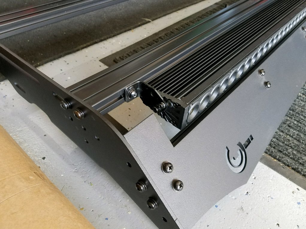

    Hmm, I don't know man. Would be pretty easy to Fab one up. Make an L bracket with a couple holes in it. One to mount to the light bar and one to mount to the Prinsu. Tighten them nice and tight so the bar doesn't swivel at all

    Yep, already started on that with some scrap 2" aluminum that I have. Thanks!

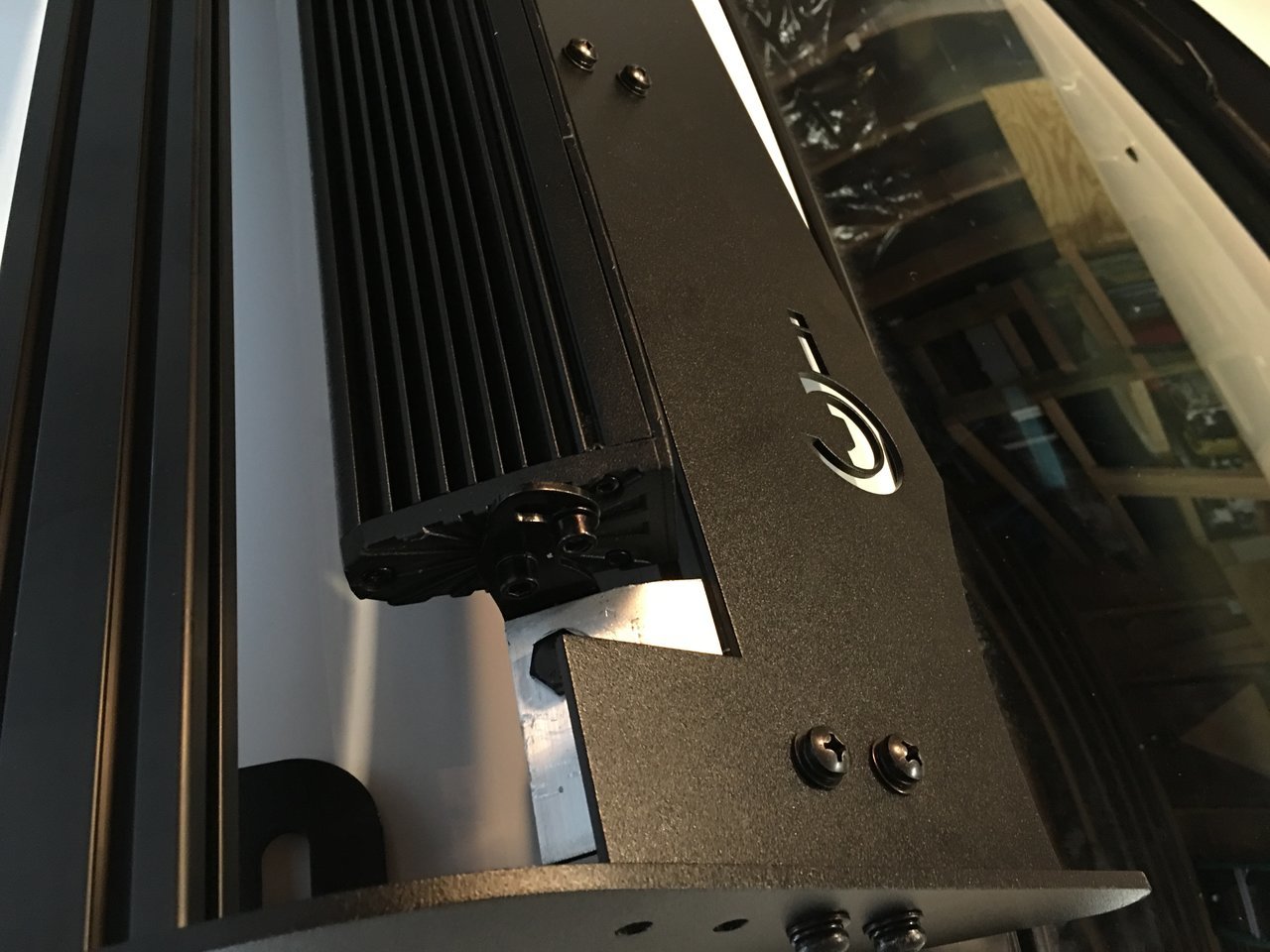

    This is what I did. I used one of the end screws to keep the light straight....
    The light bar barely clears the cross bar.

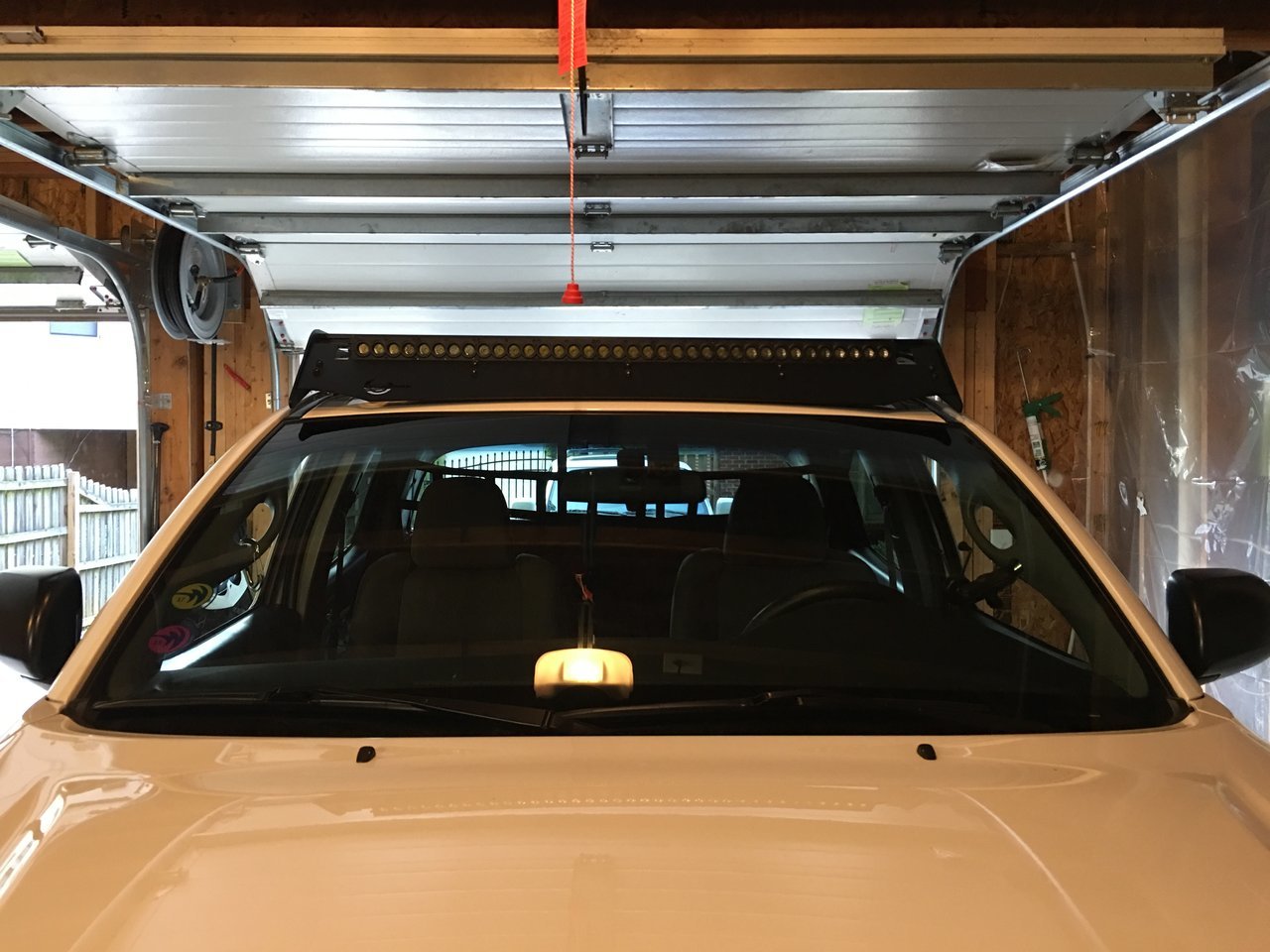

    Made brackets and I'm really happy with how it turned out. Thanks fellas!

    Very nice!!!

    That looks so good!!!
