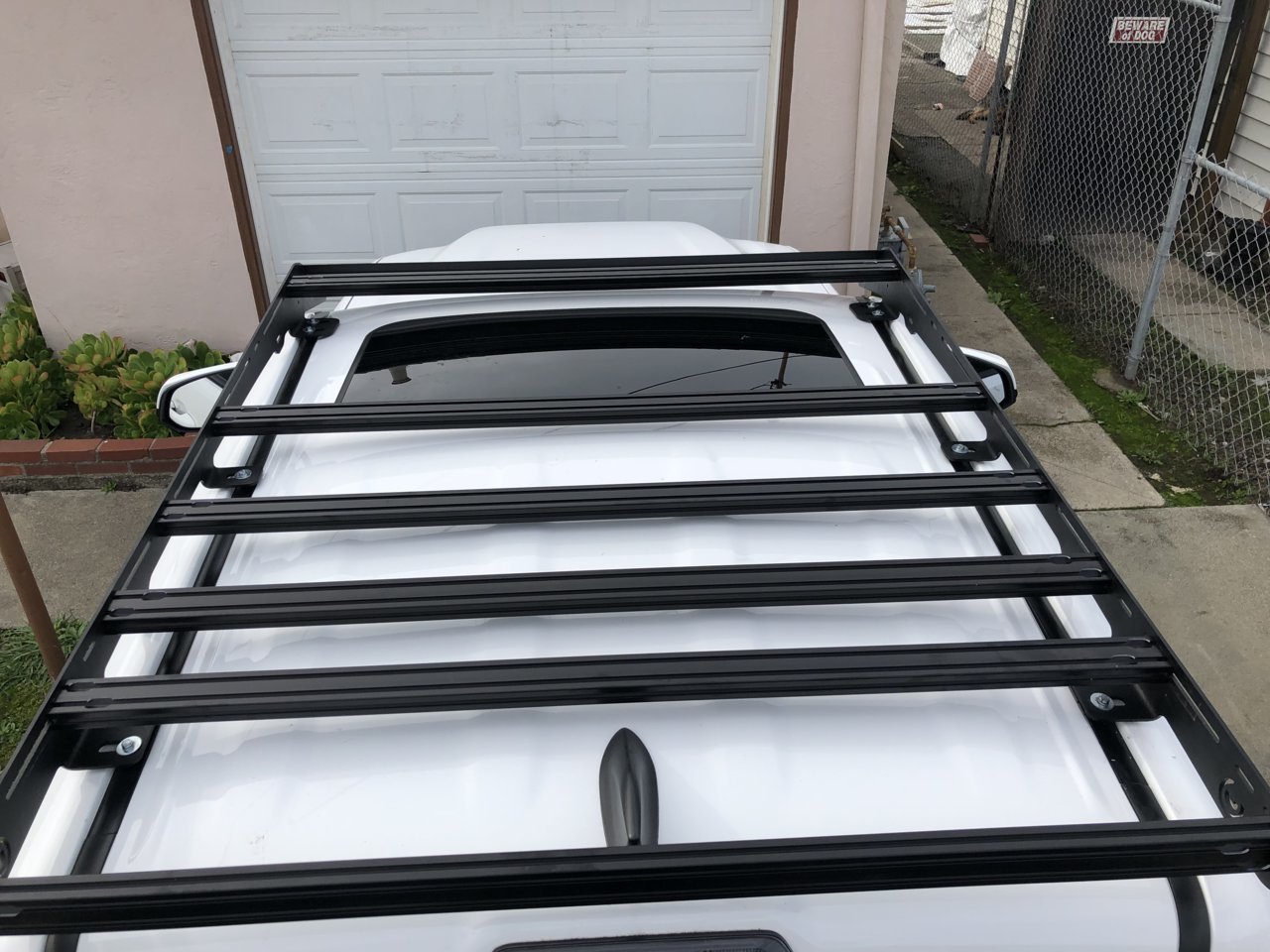

    I called CBI and got their installation instructions from them. I can send them to you if you like. It's very informative. I haven't installed my rack yet tho, weather is terrible.

  8. Jan 9, 2019 at 7:06 AM
    medicfung
    medicfung [OP] Well-Known Member
    Nov 21, 2018
    #273365
    1,031
    richie
    2019 DC TRD OFFROAD 4x4 6ft bed quicksand
    Is your last bar above the shark fin mounted vertically or is that the 1” bar for that spot?
    Did your gas mileage drop dramatically because of that?

    It was mounted vertically.

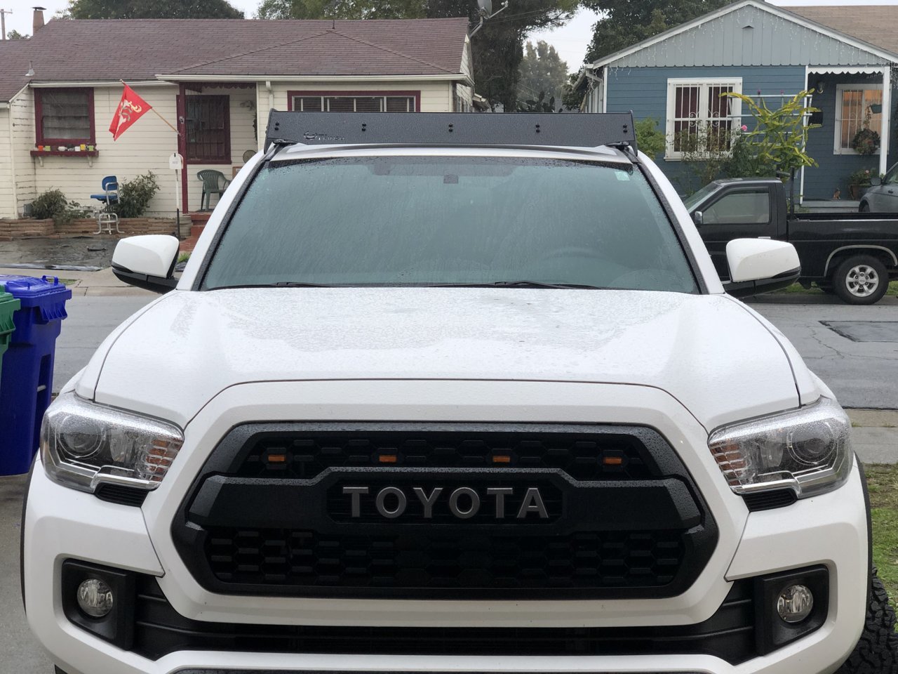

    Aside question, did your prinsu rack come with crossbar behind the wind deflector clear anodized not black anodized?
