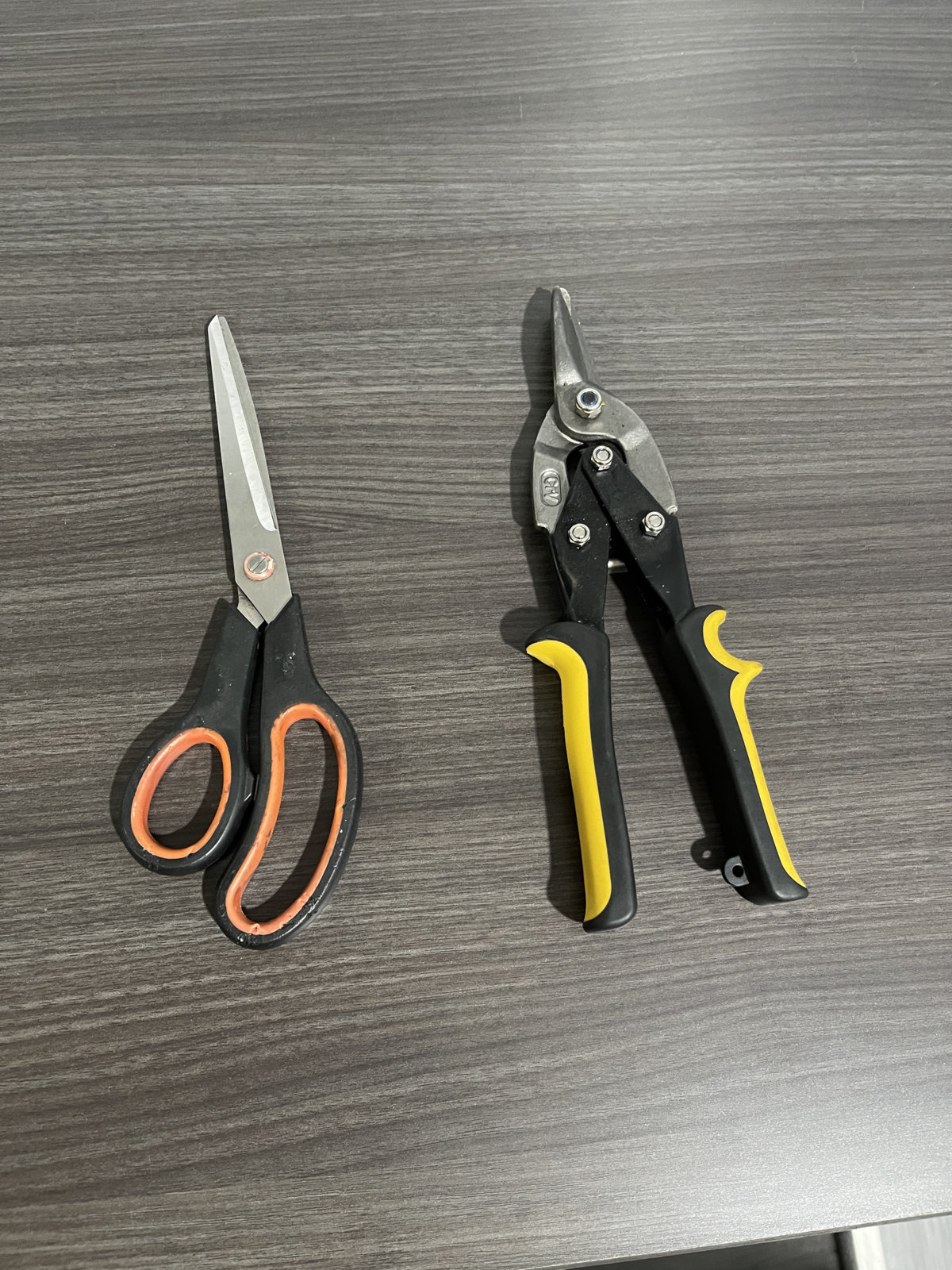

    The Dremel will work, so will both of these.C2FC9D7E-6096-454C-9D7B-32DF5D612B2C.jpg

    the scissor don't work or maybe I'm just not strong enough to get them to cut the metal. I also don't know what the tool is on the right. Prinsu video instruction also assumes user know what tools are needed to cut it but I don't. I'm female. so I need the name of the tool to ask for it at the store for purchase.

    Those are metal snips, but you have to get a pair that open wide enough. The scissors worked but strong grip required
