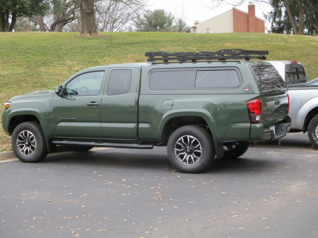

    Leer cap
    I have a Prinsu rack on my Leer topper with Thule factory tracks. Everything went together perfectly. The Leer factory installed the tracks correctly (flat side up and the correct 42" between tracks). The only wrinkle is that the tracks are slightly arched, front to back, on the topper. Since the Prinsu topper rack for a 6' bed has 6 feet, spacers must be used in mounting the front and rear feet. I just used a stack of 4 washers in each location (32 washers in all) for a 1/4" rise at the ends. (Also, 1/4" longer bolts must be used there.) My rack also has the Cargo Basket option. See picture.
