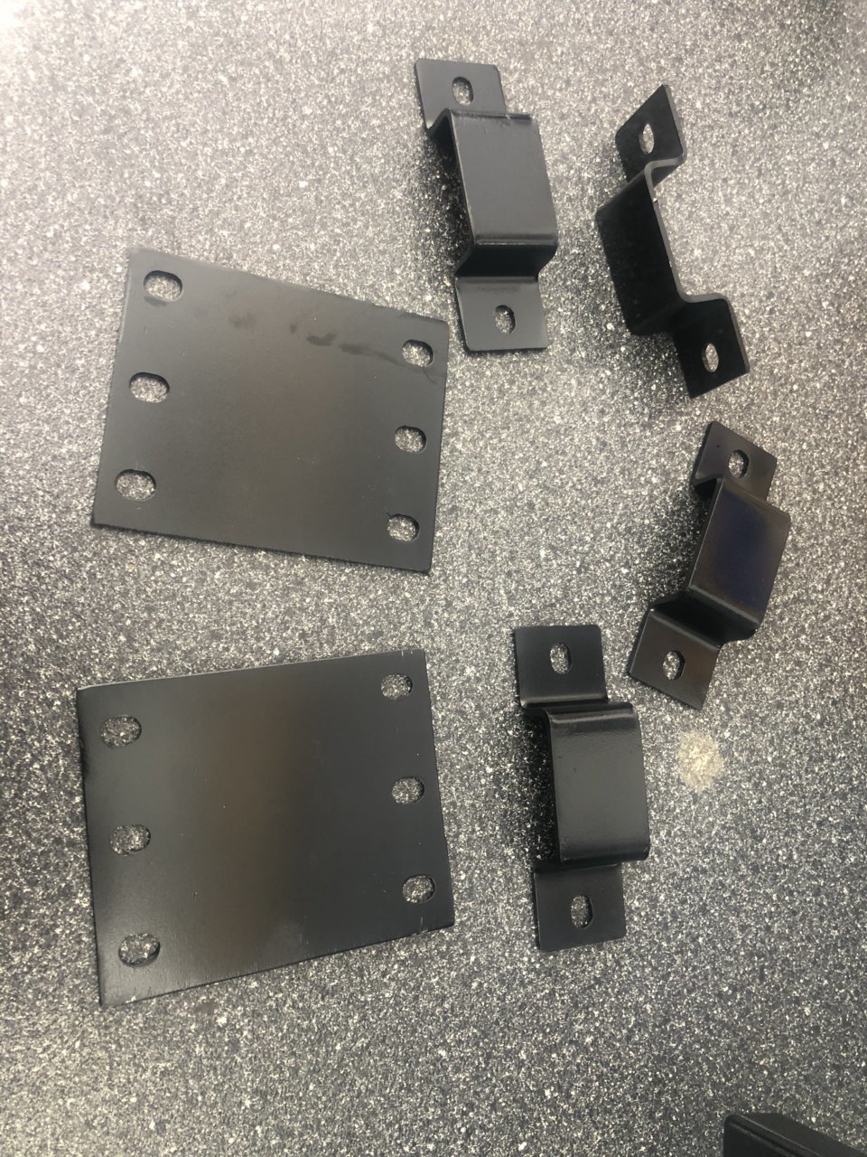

    I use cheap J brackets (Amazon) to haul (2) 12’ kayaks on my Prinsu rack.
    I did make new mounting brackets for the 1 x 2 prinsu bars. 591B6DBB-F9E8-4B6B-A0E0-29045DA65D99.jpg

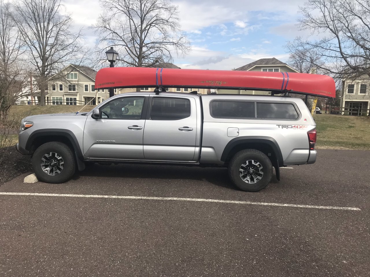

    A pair of Hullavators will require crossbars a minimum length of 60+", as each Hullavator is 28.5" long. Yakima now has a landing pad that is specifically designed for the Tacoma. It attaches directly to the factory mounting points.
    Landing Pad 24: https://yakima.com/products/landing-pad-base?variant=31843565240368
    Combined with StreamLine Towers and JetStream (aluminum) or CoreBar (steel) cross bars, you will have a very secure, strong system for mounting Hullavators.
    I have 65" crossbars, which are a good width for carrying boats side by side without extending out beyond the mirrors. If you want custom width crossbars, simply buy bars longer than you need and cut them to length. (I don't have Hullavators, but several friends do. They really like them.)

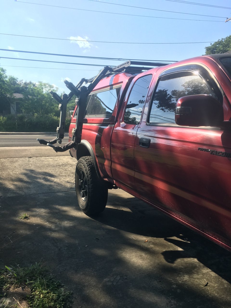

    I’m also using the BaseLine w Q clips as I didn’t want to risk water intrusion with the factory holes. This system provides very solid attachment and I’ve had B99AF20B-C0EB-4D3A-A9FC-5D794D0C4322.jpg absolutely no issues w paint damage. I ran a similar set up on my 08 Tundra for years with no problems or paint damage.

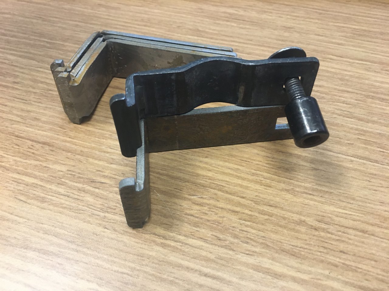

    I made some brackets to mount the Thule Hullavator bars to the prinsu bars:https://www.tacomaworld.com/threads/tiffany-the-taco.374490/page-13#post-23538387
    I also had to get longer M6 carriage bolts as well. I then designed some small plastic spacers that I 3d printed that fit under the bars to space them up and over the 1/4" lip that the side of the prinsu has. That way it's not digging into the aluminum.

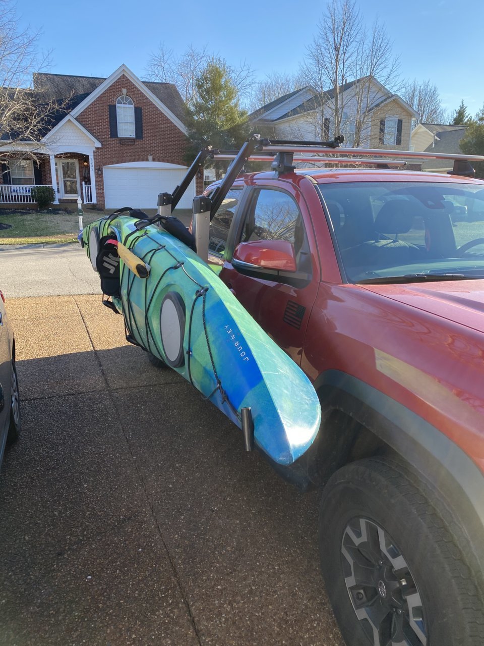

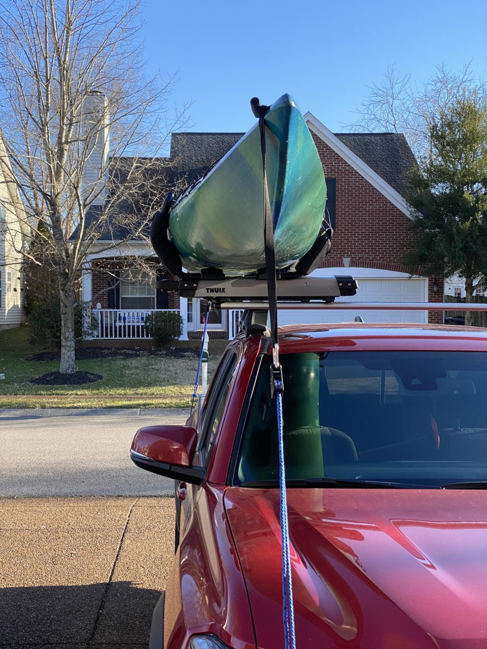

    I ended up going with a full Thule system. I found a local (but not as known) dealer that happened to have most of what I needed in stock. All we had to do was order the locks and the fit kit that works with the Tacoma doors. I went with the Thule Wingbar Evo bars and put the Thule Hullavator Pro on top.
