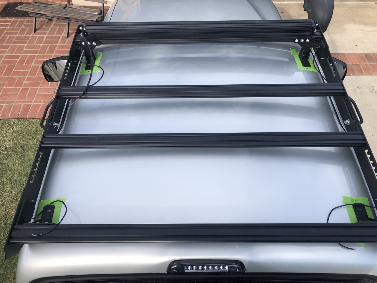

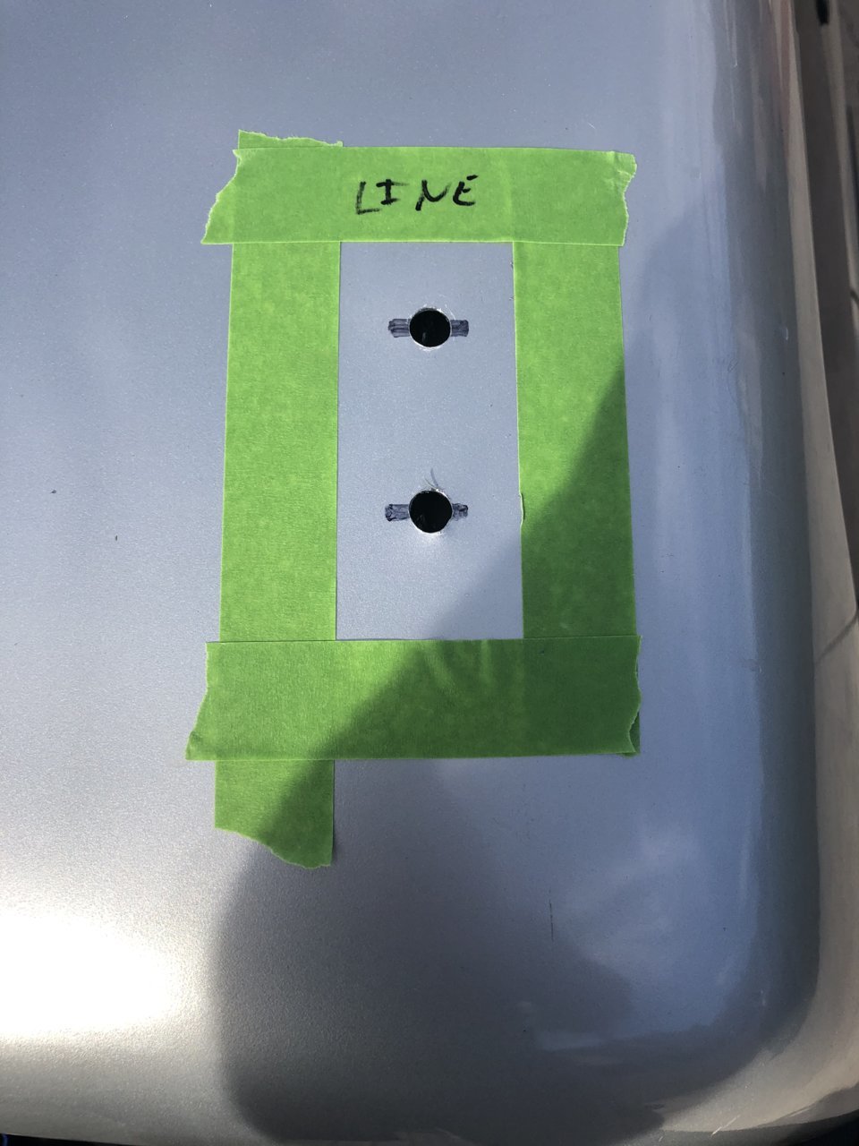

    6A4B7741-76DA-42F1-945D-3D3932DA654D.jpg 57CFB52C-3BAB-4133-BB66-470AEA93DC4E.jpg I went with the Upland Overland rack which required the same type of installation (drilling, installing rivnuts, etc.), but is relatively self-explanatory. I remember being hesitant the first time I drilled into my truck, but now I don't care LOL. Just take your time, measure it out, and be sure it sits exactly where you want it prior to drilling. Once you get your rack's "feet" into position, "box" them in with masking tape so you know exactly where they should sit and mark the location for the holes with a sharpie.
    Also, no need to remove the headliner as long as you don't do anything stupid like pushing too hard on the drill and blast through it. Like I said, just take your time.

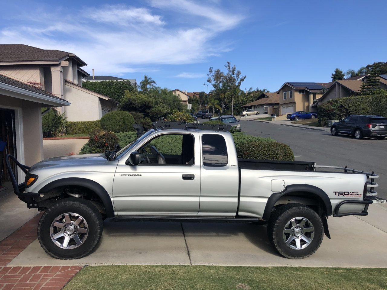

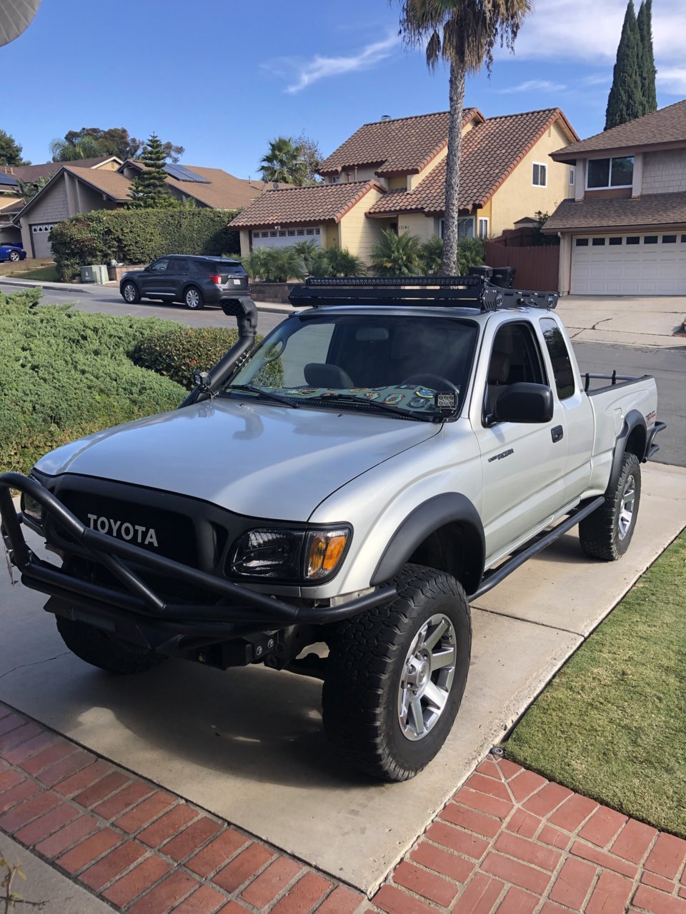

    Have a pic of it all finished?

    I used the supplied rivnuts which offer quite a bit more reinforcement than nutserts. Without measuring, they looked like they would spread to a diameter of about an inch which beats out a nutsert of similar size by at least 50%. When I grab the grab handle, I can shake my truck without any flexing of the roof's sheet metal. Super scientific, I know...
