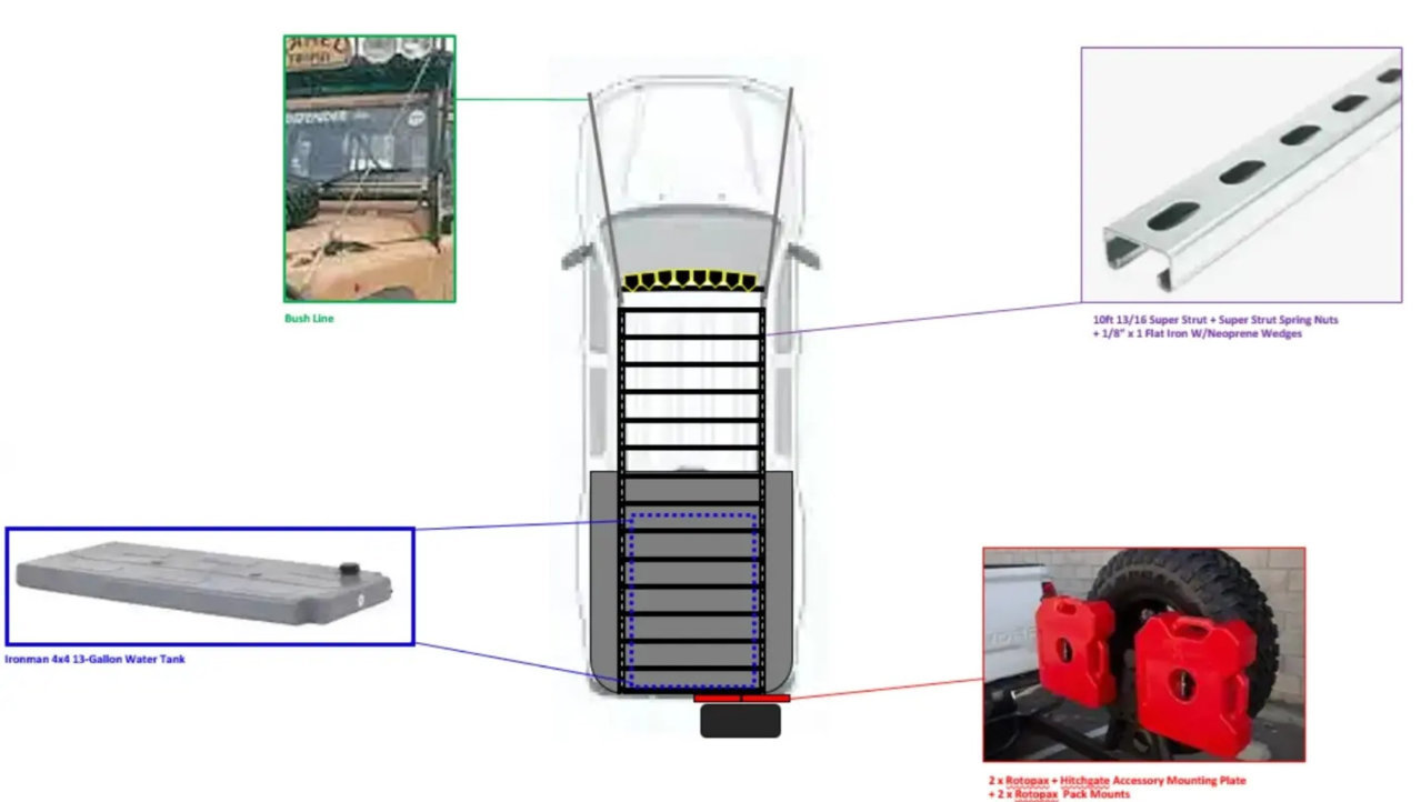

    Just a few DIY ideas on "the drawing board"

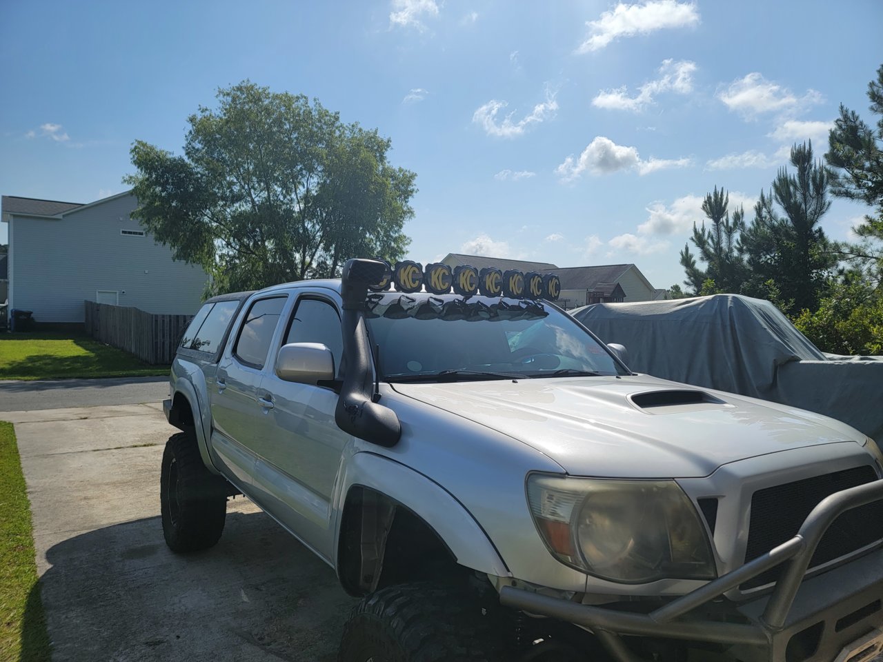

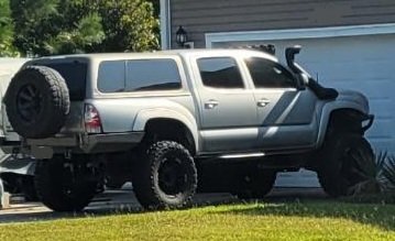

    Top Left: Brush Wire inspired by thr Camel Trophy Trucks.....limbs smacking the windshield are a real thing in the Carolina Woods...replaced glass as a kid (Pic-2 with my HS '93 P/U...RIP Uncle Billy) never again do I want to do that!

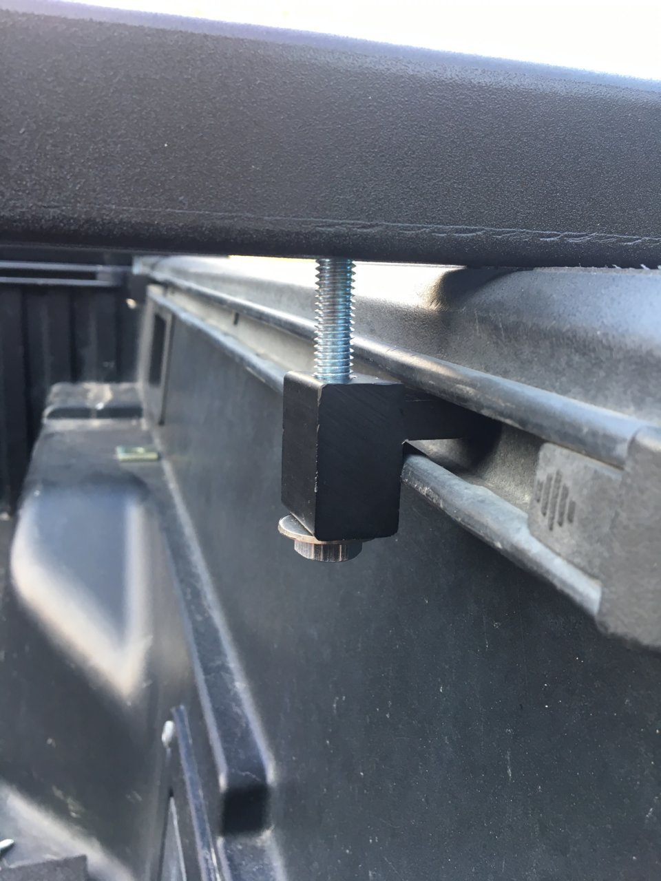

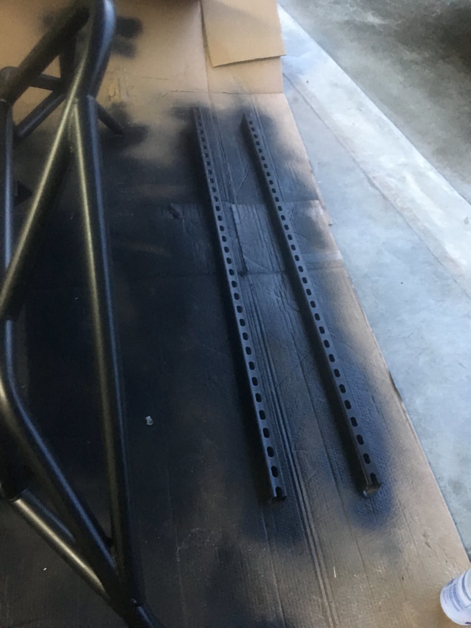

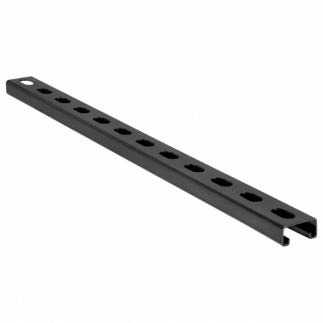

    Top Right: My SuperStrut obsession...came from the pics of my black tacoma when I made my own bedrails using Strut, Super Strut Spring Nuts, and drilling out Tacoma Camper Shell Clamps to keep everything torqued down. Plan is to get 13/16" Strut and use that down the roofs seal lines and bolt directly into the OEM roof rack holes. Bottom Left is a water tank (Whole reason for the rack project) Then Bottom Right will be my DIY plan fpr fuel mounts to keep Gas "outside of the hotel room"
    My Vector Animation for the plans I've got

    What Started my Super Strut obsession
    Bolting the Super Strut to the Rig

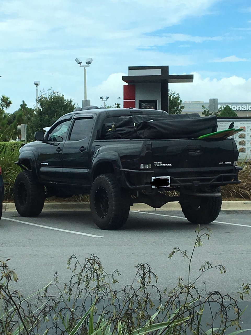

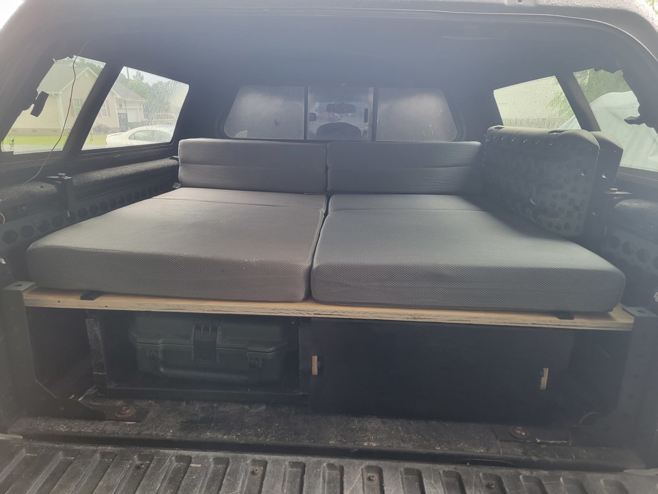

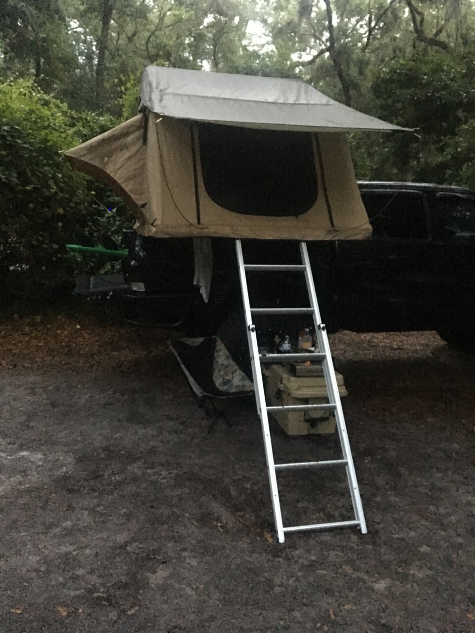

    RTT in use on an expedition.....also the reason I decided to design a decked system under a camper with a compact mattress set up.....ease of use/packability.....this trip was gun but made it apparent that an RTT isn't my style.....over the top would have been expensive to mount and cut on MPGs (Drove from NC to PCB, FL and back for this expedition)......flush with the cab was neat but I had virtually no bed....then had to air out the tent after heavy rain.....not ideal for my uses.
    No matter what COA I go with....my ultimate goal is a 24/7 paid-for-hotelroom-enough set up to pullover on the side of the road and get a nap in, next to my glock.....and then to have an elevated/enclosed set up to take the wife out overlanding.....she doesnt do bugs/bears haha (This thing is "totally bear proof babe")
