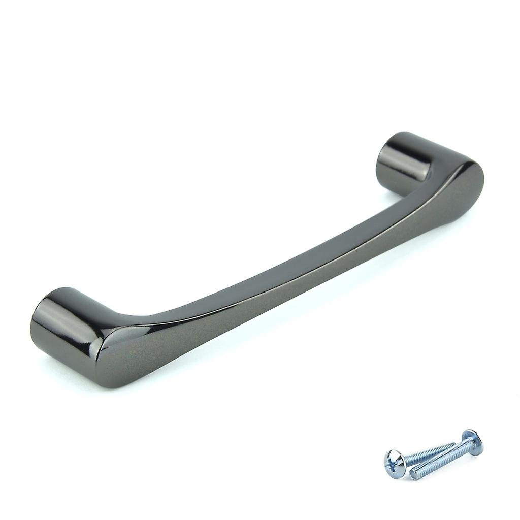

    Why not a regular door handle lol? Has two screws where you can throw some washers on the back...maybe durp it a matte black, tactical color?
    Come to think about it, not a bad idea? It’s aluminum so should hold up better to the elements lol

    Besides actually saying the same thing to a friend of mine about the cabinet hardware, I found these but the price!
    https://smile.amazon.com/gp/product/B008E9Z1FS?ref=em_1p_4_im&ref_=pe_27541410_472022050
    You could get two sets of a paracord versions and a 30 pack.

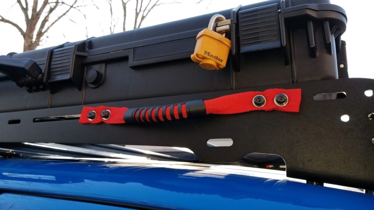

    I made my own. I bought the cheaper roll bar handles and removed the part that goes around the roll bar and used a soldering iron to melt holes into the handle part, and then added some larger washers to the existing cross member bolts. They might not be as cool as other types but for now they will definitely work and were cheap as hell.
    Tt6SszmdWq9MWw9IHmWZEG0I6XX7aCMWzIZ2jjlk_50a99739a36fb0a2ec6d08b577c82fa85ac53efa.jpg
    EDIT!!! These lasted about 5 months in the elements, became dry rot, and eventually just tore off. I do not recommend this mod.
