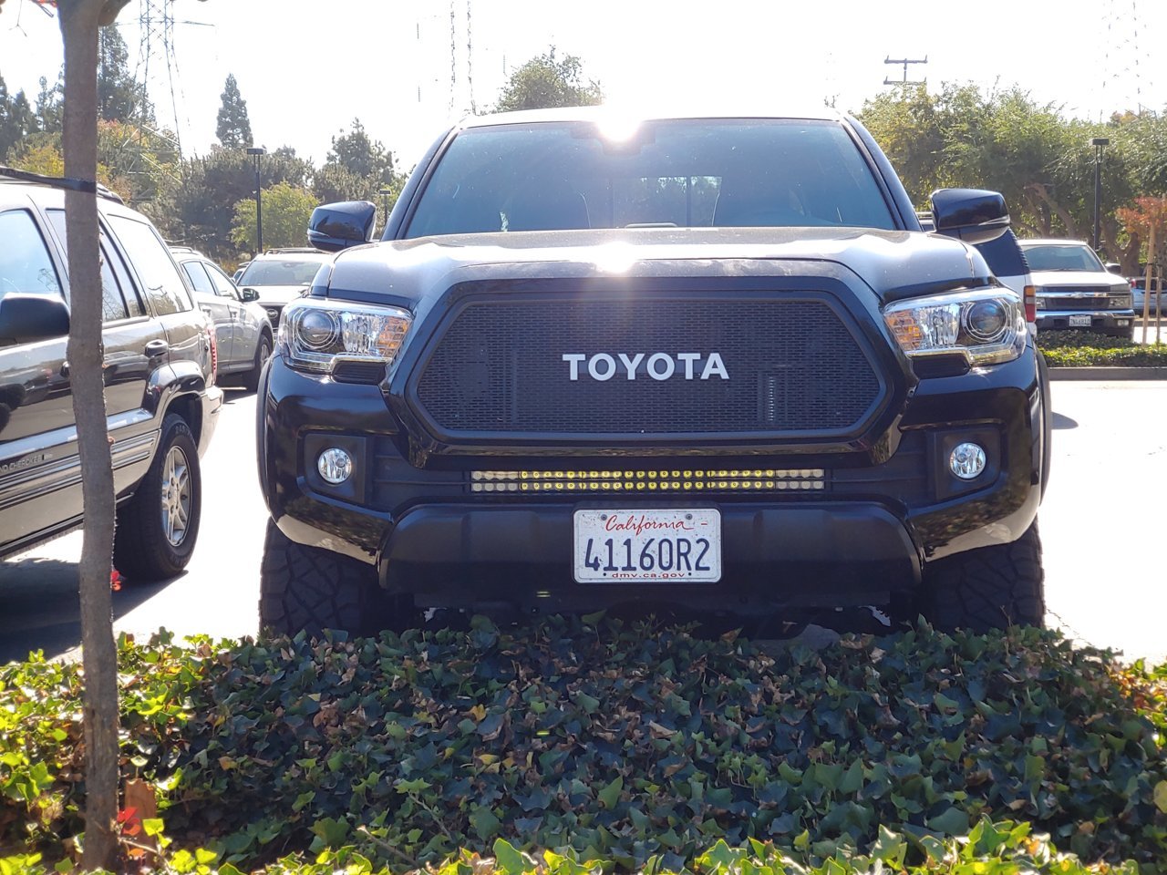

    My KC C30 is abour $300 and has 16k lumens. It's pretty badass. Taylor on KC has a garage sale going on with 7.5k lumen slimlites.20191029_124450_HDR.jpg

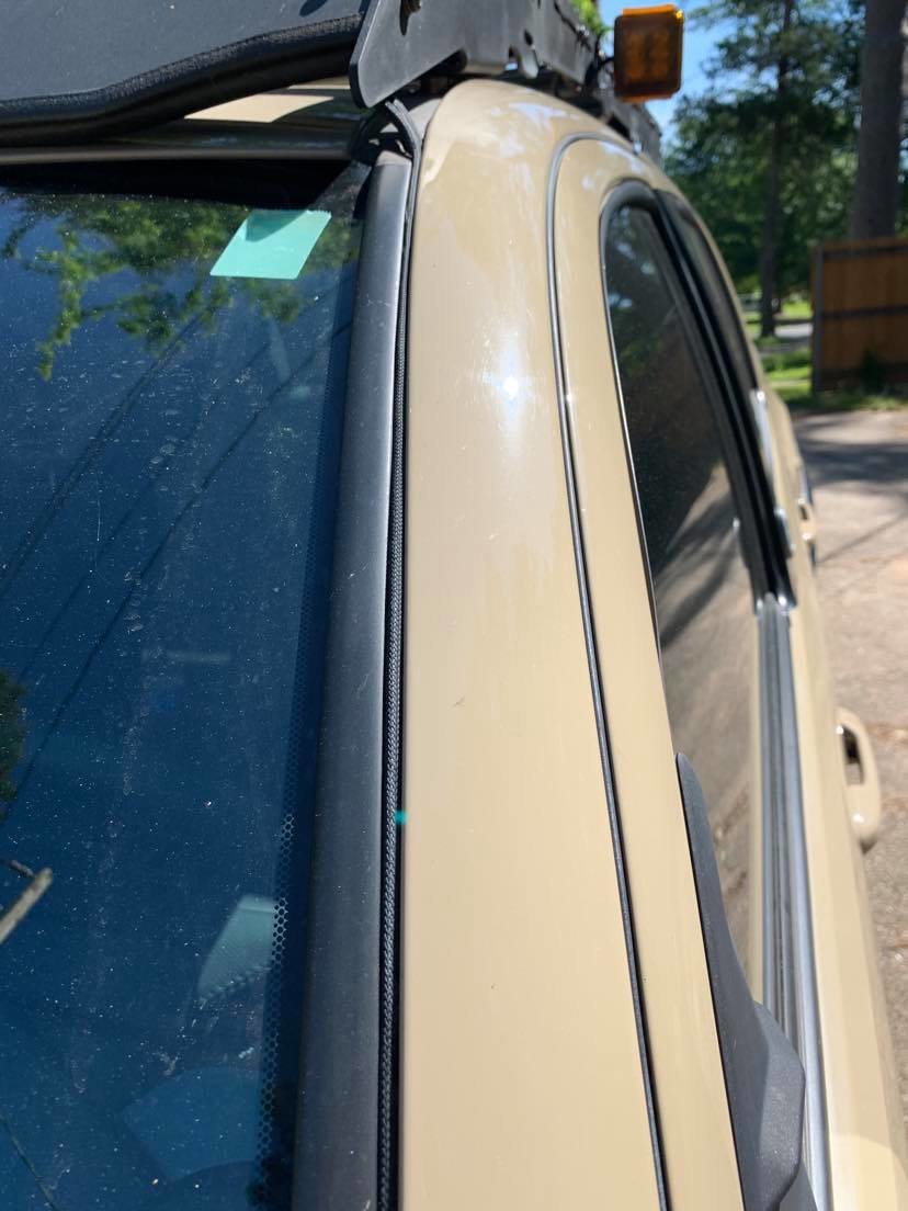

    How in the world did the rubber come off and go back on properly?
  4. Sep 8, 2020 at 10:51 PM
    #24
    aaronqn
    aaronqn Well-Known Member
    Jun 5, 2020
    #330474
    93
    Bay Area, CA
    I had to reloom the wires and just used a plastic popper tool to press them in carefully.. using a towel so it wouldn’t dig into the wire

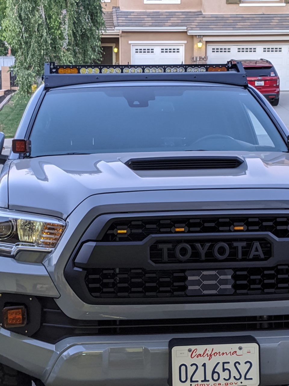

    Anyone else have the caliraised premium roof rack with the 360 lighting package? I have some questions about how did you run the wiring and why are the side light mounts wrong hole size from there pods?Screenshot_20200909-195815.jpg

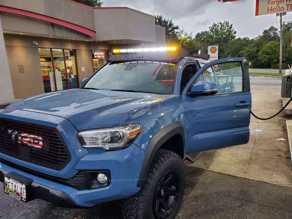

    RAVE OffRoad roof rack with their 43in light bar :)

    I used a plastic tool from a cheap harbor freight door panel kit. Allowed me to push wire loom as shown above.

    Like others, I ran it down the windshield molding on the driver side. For quite a while I just used electrical tape and had it contact the glass and the windshield molding with the wire harness under it. This worked fine until we started getting rain then it started peeling. Then I put some dabs of clear RTV on the inside of the channel the harness sits in against the windshield molding, put the harness in place, and taped it again. Took the tape off a day later and now the harness won't move!

    security was the primary motivating factor for the hidden bumper light bar. even with security bolts on exterior lights, they looked susceptible to theft.
    once you get the brackets from either Cali Raised or Rago Fabrications, the install is pretty easy. You also don't lose any light from the recessed position. simple bolt on and plenty of room to work by the radiator. the wiring was idiot proof easy. good luck!
