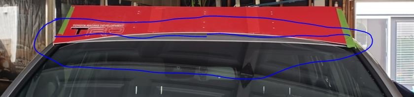

    similar complaint.

    Are you referring to the bottom of the side rail
    Or the back edge? The bottom is to
    Match the curve of the roofline. The back edge was to extend It past the back of the cab but not quite over the bed and be able to add another support cross bar behind the sharkfin

    This. A consistent spacing from the windshield would be ideal.

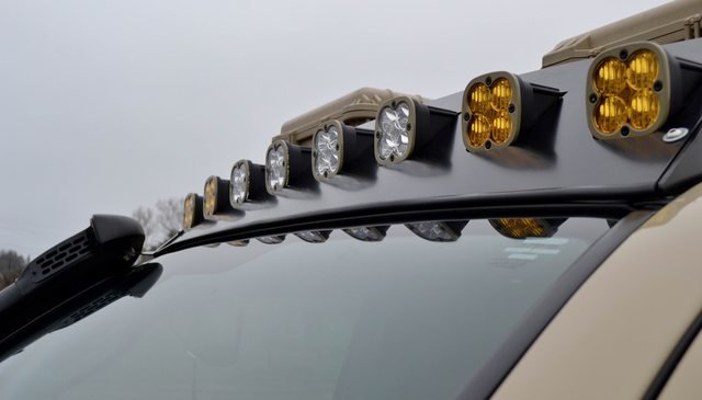

    So that curve was my best guess at allowing to match the curve of both the windscreen and roofline. I wanted it to sit as close as possible to be as aerodynamic as I could get it.
    Thanks @MESO that’s a beautiful example of how it could be done and I’m sure you are well aware of the difficulty in matching a compound curve. This gets even more difficult when all I have to use to measure this is some basic measuring tools like a 24” combo square and a 48” level. Plus cardboard, tape and a sharpie.

    All I used lolz

    Haha nice. Is that your creation in the photo? I’d love some help getting my design to fit that tight.

    Precisely. This is perfect fitment.

    @Billy_trd i agree that is super nice. Looks like it’s curved along the length of it I might have to do a rethink on my wind deflector.
    @MESO any idea where to get the rubber edge moulding for the wind screen?

    The big difference is Meso’s plate isn’t flat.... it has a bow and carved arch?

    Yes. It was just a lot of trial and error really.
    It's curved to match the windshield. Here's a better view

    But your sheet metal isn’t flat is it, it has some bow to it?

    Correct. Actually 3/16” steel

    Any more pics of the rack? The fact that the fairing is steel is even more impressive.
