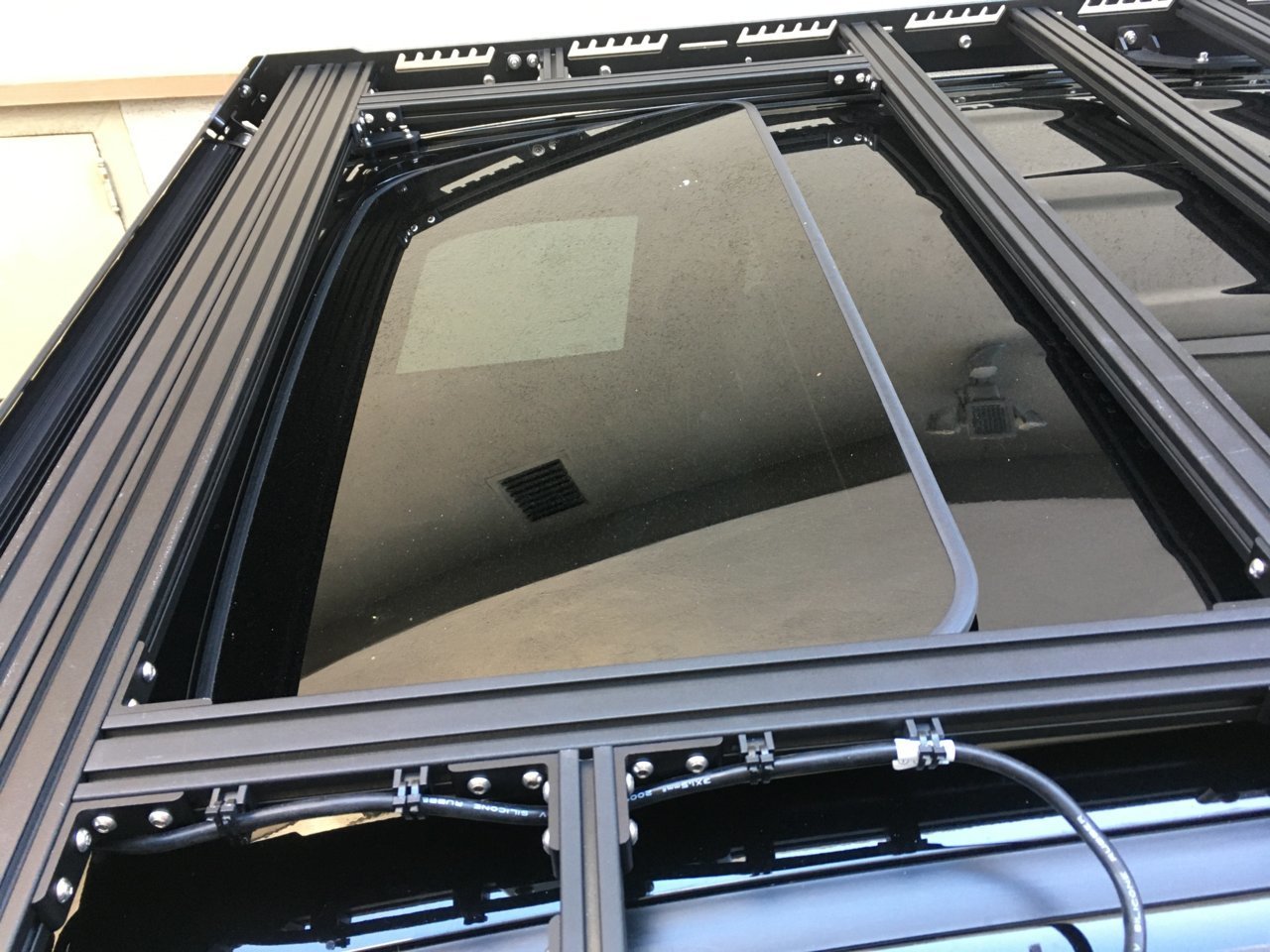

    I believe that the Bravo is already Sunroof compatible. I have the Alpha and this is the kit they sent for my sunroof. You can’t stand up in it, But you can tilt and open it. Maybe you can get some 8020 aluminum and figure out how to make that opening better and works for you.

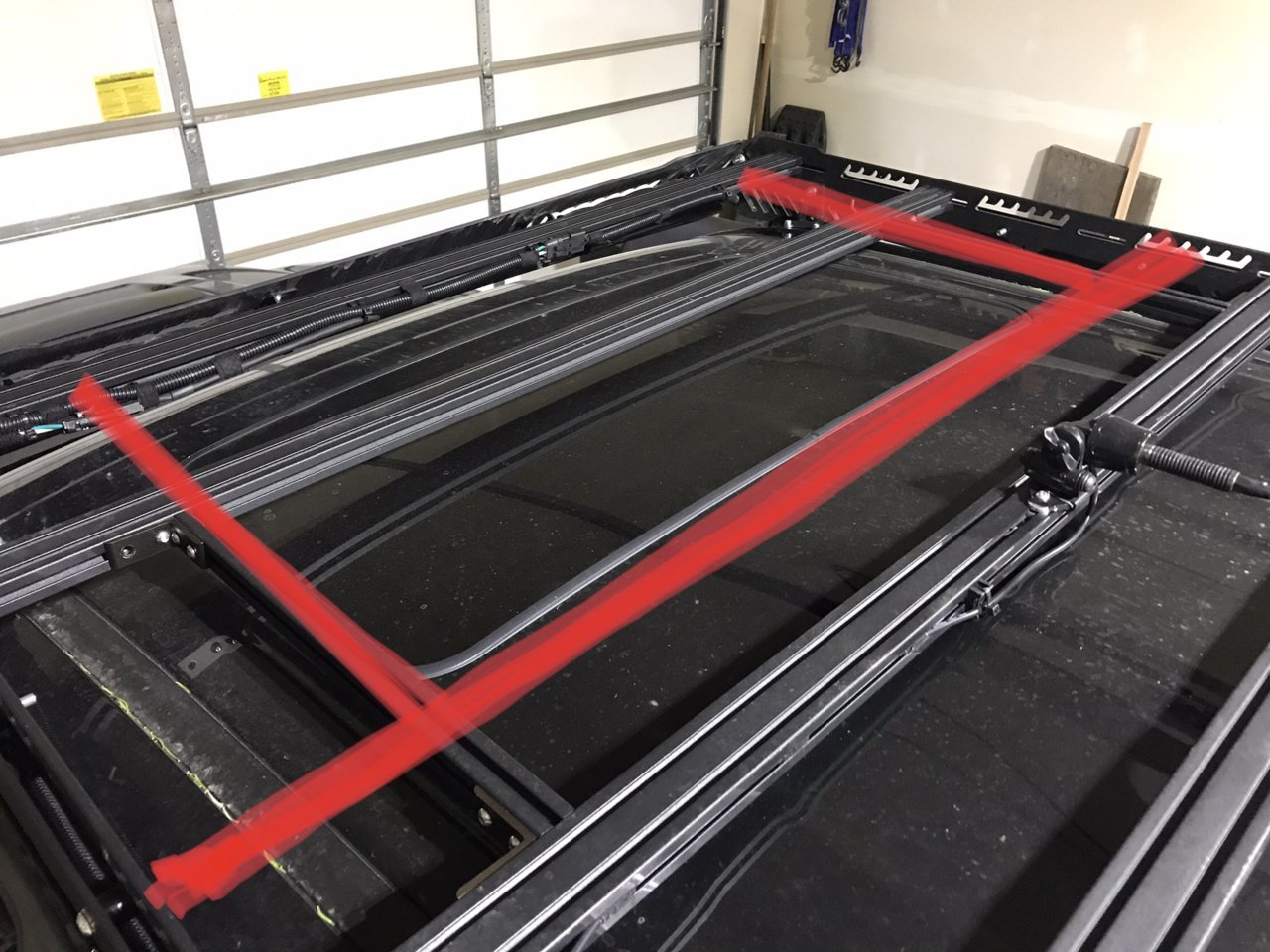

    it might be strong enough still if you do something like this. Getting longer struts for the sides and moving the bar to just behind the window, that will give you a unobstructed window. Not sure about the strength. That would be an UpTOP engineer question. This idea would probably take a redesign as to where the load bar mounting slots are located

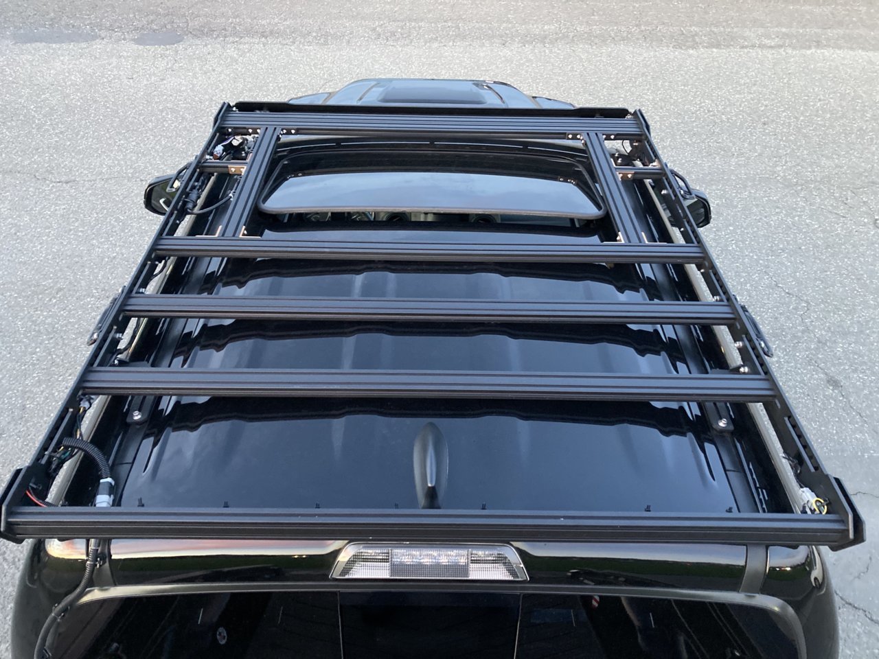

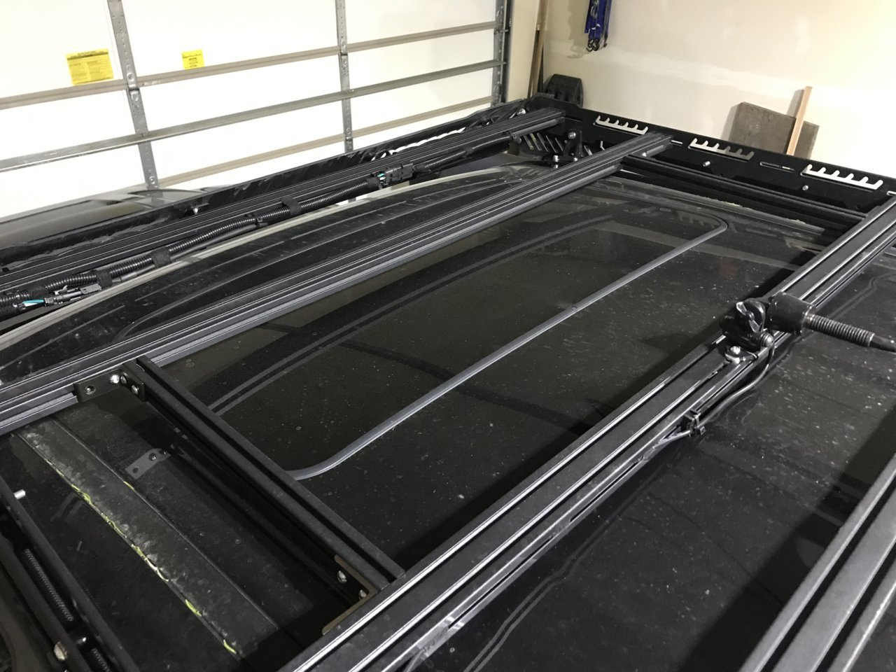

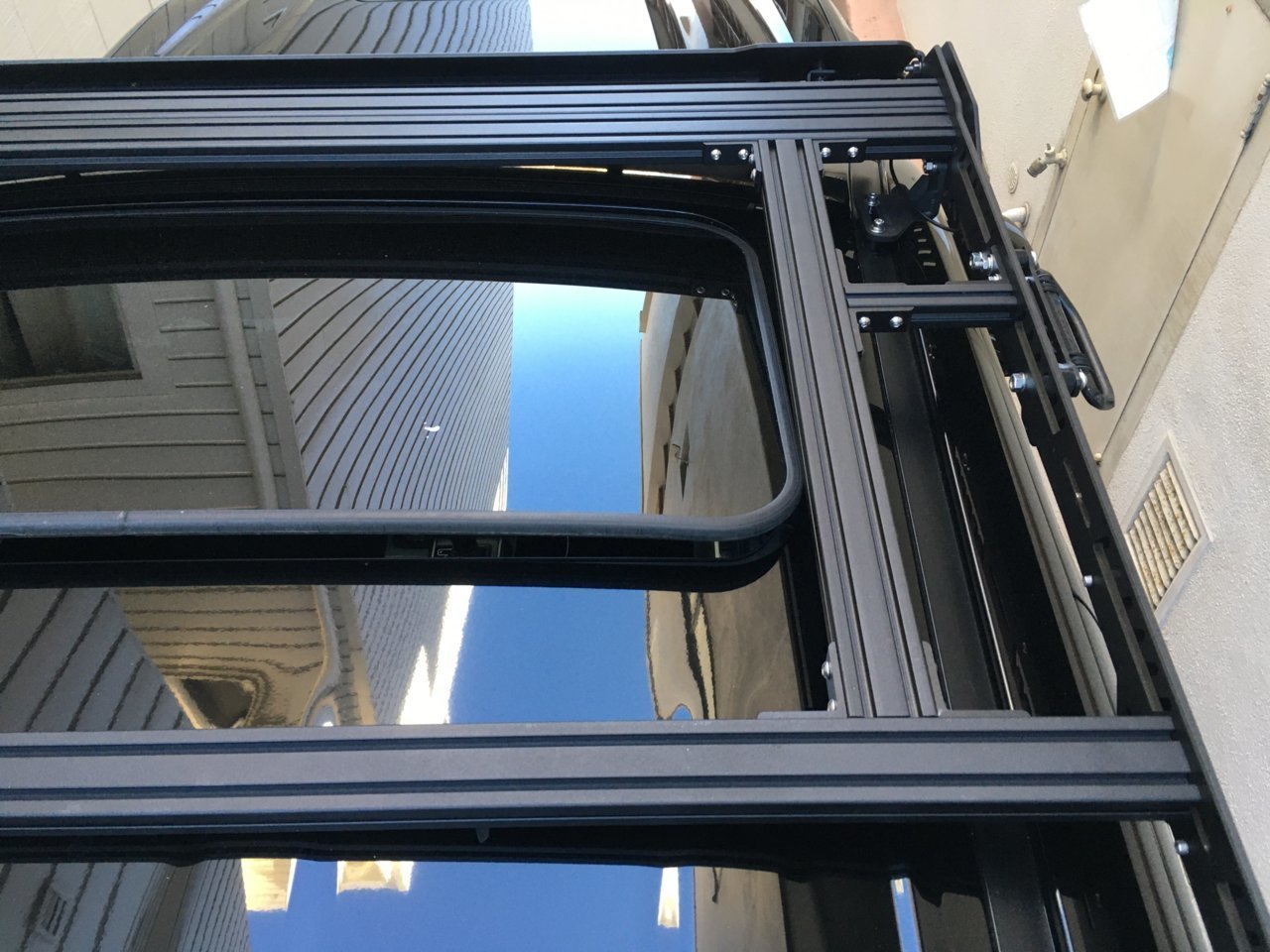

    Here is my solution for my Alpha:
    It really irritated me having the 2nd load bar cutting across the middle of the sunroof so I modified it by:
    Moving the 2nd bar to the most forward position next to the 1st load bar. To structurally reinforce the rack since there are no load bars in position 2 and 3 I purchased an extra load bar and installed it longitudinally (front to rear) between position 1 and 4 (see pic in my post.) The extra load bar I cut to fit and also cut the skinnier support bar to fit (from the fresh air option) for even more added structural integrity. Had to buy extra L brackets.
    Happy the way it turned out, it feels really strong/robust and with two load bars right next to each other I now have even more surface area at the very front of the rack just behind the light bar to spread and support the load I put on it.
    Best part about it is I can open my sunroof all the way without obstruction and stick my head through it:D.

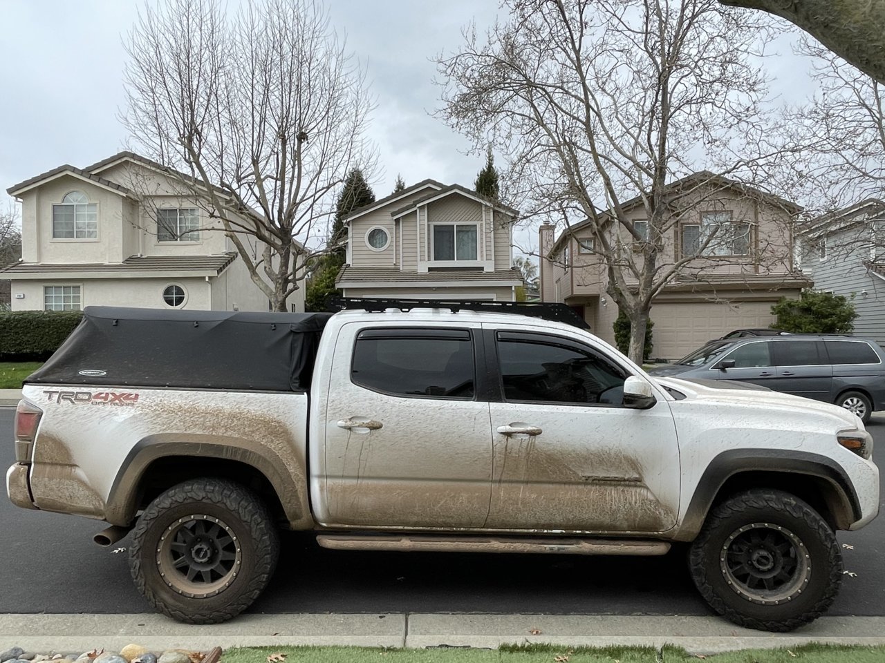

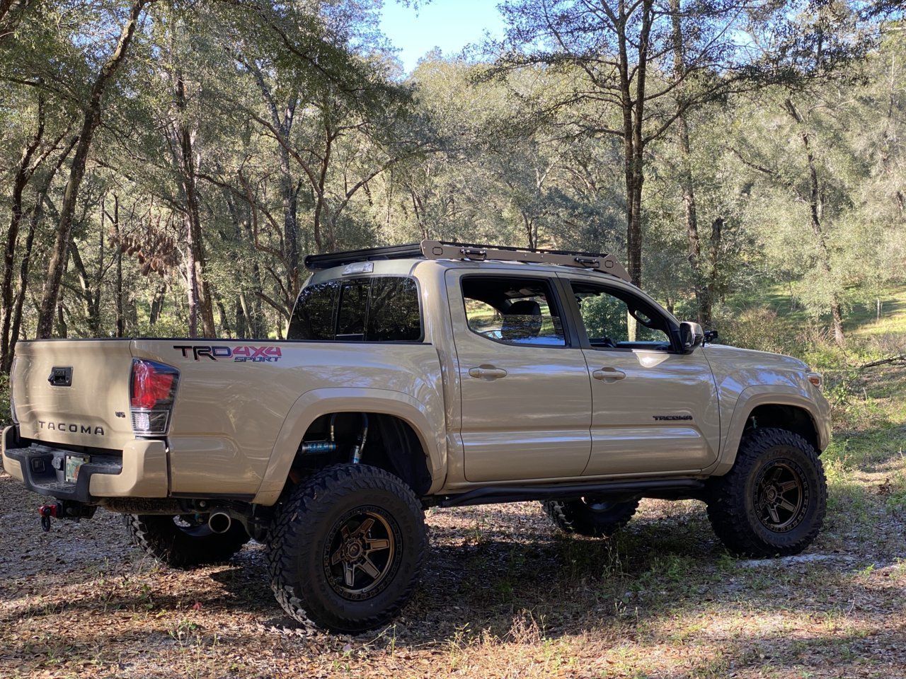

    Here is a Prinsu with the Uptop Overland AAP. Both installs are up on my channel, incase you want to check them out. Nothing but good reviews from me for both companies. I wanted the sleekness/tightness of the Prinsu and the side look/handles of Uptop Overland so that got me here. I think the Uptop racks look sick and are well made, just a little bulky for my style preference. Both are solid companies with great products.
