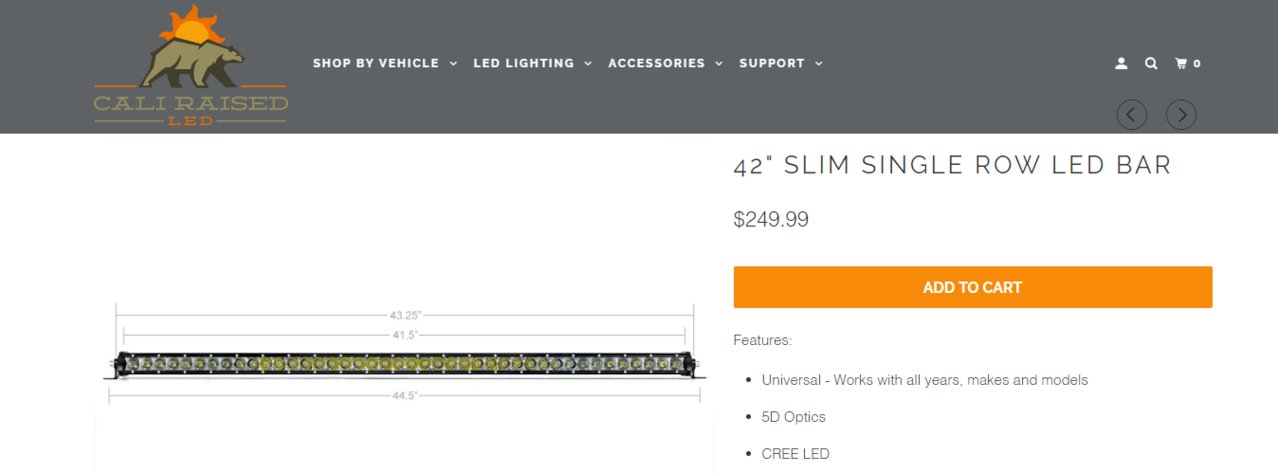

    Lighting: BD S2 Sport Flush Mount Rear Bumper Lights (Work) BD Squadron Pro Driving/Combo Fogs (Amber) BD S2 Pro Ditch Lights (White, Off Camber Hood Bracket) KC Hilites Cyclone Under Hood Lights KC Hilites Cyclone Pair - Shell Lights 30" Rough Country Black lower grill light bar Raxiom Bluetooth Light Switch Accessory Controller Suspension Teraflex 2" Falcon Load/Haul Suspension Tires BFG T/A KO2 C 265/70R-17 Wheels Fuel Wheels - Vector Gun Metal (17x8.5) MESO Mods Coin Tray Dome Light Map Lights Key Fob - Orange/Red Keys @OneMoreTaco Radio Knobs TRD Pro Grill - Runnin4Tacos ARB Single compressor (Underhood) GTFO Expedition Compressor Bracket Runnin 4 Tacos - White Grille Lights - 4 Caliraised Bed Stiffeners Redline hood struts Bedrug Bedliner KTJO4x4 Tail Gate Auto Lock Kit Dual camera setup - Anytime front/rear Camera Runnin4Tacos - TRD Off Road Emblems Victory Blitz Rock Sliders Victory Top Rack Ordered (delivered, need time) Victory 4x4 Center Console Molle Wish List Victory 4x4 Blitz Front Bumper Victory 4x4 Strike Rear Bumper
    The Light Cutout is 41", what is the bezel out-to-out on the light bar?
    Looks like the Caliraised 42" is 41.5 out to out on light, 43.25 on the edge of Bolts.

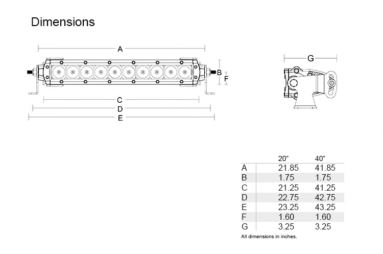

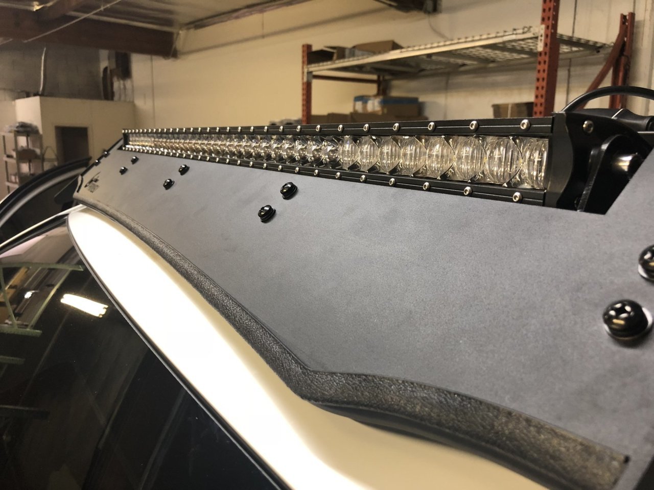

    Our rack is designed to fit a light bar with a maximum lens housing width of 41.25" That would be measurement "C" in this diagram of the 40" bar we sell.
    Your 42" slim will fit behind the fairing, but to set it inside the fairing as designed I think the customer will have to actually trim the fairing.

    We decided to go with the 41.25" opening width because it keeps the fairing tight against most "standard size" 40" bars. I say that in quotes becauase nothing is really standard, but most of the OG single row 40" bars are that mounting width. It not only looks nice, but it also helps keep any whistling noise down.
    We do offer a high quality (but imported) 40" single row if the price from Baja Designs or Rigid is too hard to stomach. There are a billion imported LED lights out there, but we spent some time choosing one that will last a long time and puts out a good quality beam.
    https://www.victory4x4.com/product/LED40.html
    Even though we sell those I'll be 100% straight with you, if you want MAXIMUM performance the Baja Designs S8 and Rigid SR Series lights are fantastic. There is a reason that they cost $1,000.
    The larger sized 40" and 42" bars will fit, but you will have to trim the fairing open for them. It's not a big deal, and the aluminum will easily cut with a hacksaw. File the edges smooth and hit it with some Rustoleum Textured Black paint and you'll never be able to tell.

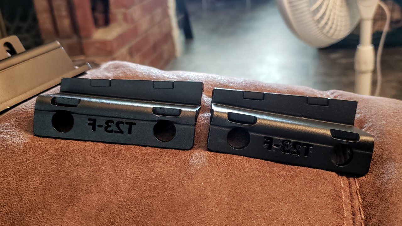

    Are the front brackets supposed to be the exact same like this?
  10. Jul 1, 2019 at 3:19 PM
    #250
    monkeyevil
    monkeyevil Victory 4x4
    Sep 12, 2016
    #197124
    953
    Daryl
    Kalamazoo, MI
    No they are not, I had another customer with two of the same as well. I guess we know what two orders got boxed back to back! So sorry for the hassles, if you could reach out to info@victory4x4.com with your order number we will get the correct part out to you ASAP.
