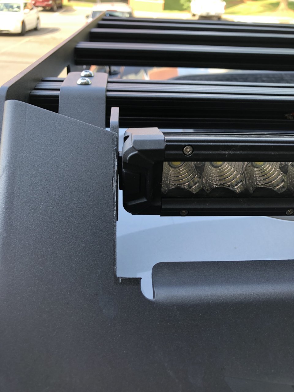

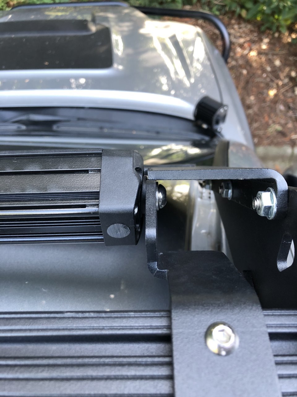

    Can you post pictures on how you trimmed the rack to fit that 42" bar? I think I want to buy the same one but want to make see how you did it first. Thanks

    Here is one side, but you get the idea. It’s a sloppy cut, but all I had at the time was a dremel.

    That doesnt seem to hard, thanks man. I just odered the same one.

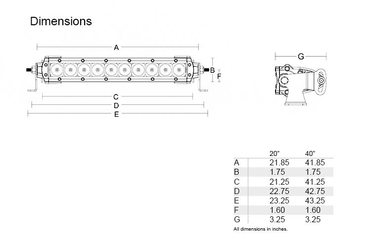

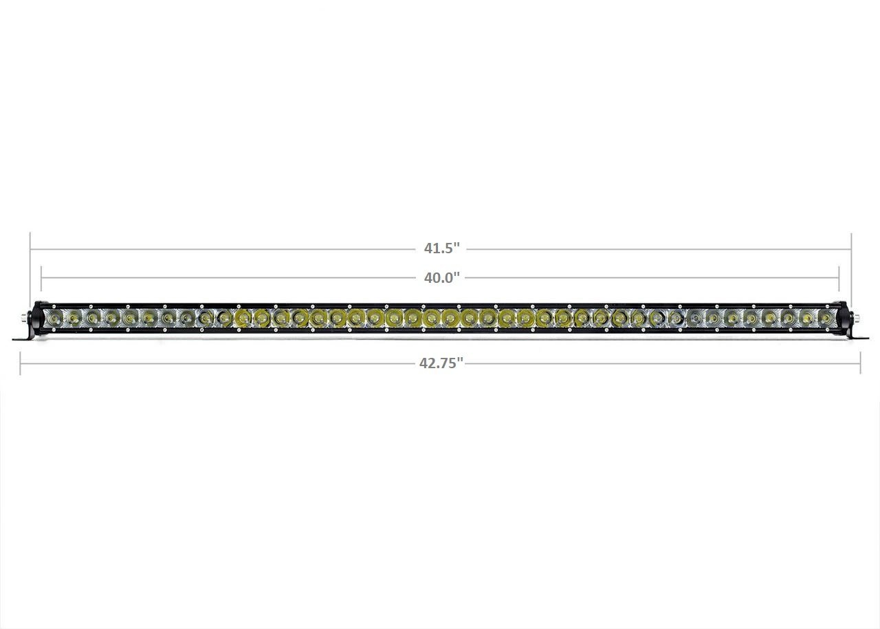

    Maybe someone can help me understand. I'm trying to compare these two light bars. Victory's says it's a 40" and Cali Raised says 42" but the dimensions of the Cali Raised appear to actually be shorter in length... I'm confused. I'd rather not trim my rack if I don't have to.
    Cali Raised:
    Victory:

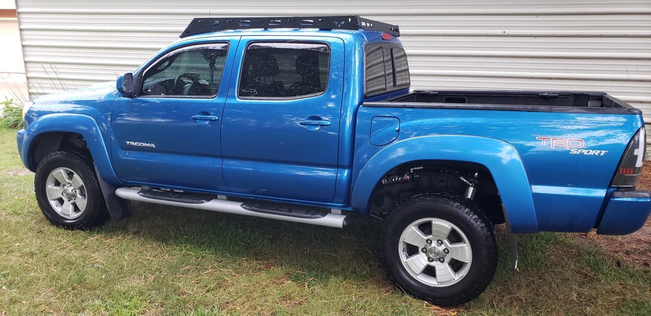

    I just installed the Victory 4x4 Roof rack. Assembly was easy, installation was easy as well. I did not have any help to put it on the roof, but it was light enough to lift onto the roof by myself without any damage to the roof.
    Quality is pretty good. Very solid. Powdercoating is consistant. I did replace the flat washers with lock washers, since I didnt use any lock-tite. (I may go back and lock-tite everything if I notice anything loosening up)
    I think the only issue I saw (painful one) was that they did not deburr the edges from where the shapes were lasered. This resulted is a pretty nasty gash in my left thumb. I still dont know what to do about it. I come from a manufacturing background, and so seeing this was a bit disappointing. Removing the burr's would also remove the black powdercoat. I dont want to do that...
    Below are pictures of it installed on my truck.
