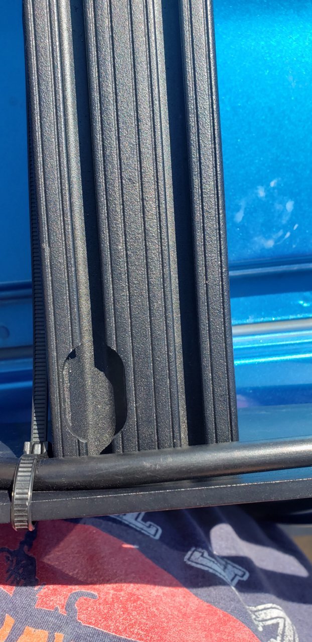

    Just so I'm not misunderstood, I'm happy with my purchase and would make it again. I'm hopeful my post leads to some qa improvement. When I purchase a cap I'll likely buy a matching rack for it as well.
    As an armchair engineer all I could come up with on the slot was a fear two cuts would weaken it. If that's the reason, maybe put one on each end?

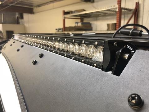

    https://caliraisedled.com/collectio...cts/prinsu-roof-rack-slim-led-light-bar-combo
    I am not to positive on victory racks, we do offer our 42" LED bar for the Prinsu racks that will fit there cutout.

    We are talking about both SLOTS not both sides so it wouldnt be a production set up issue, even on a manual mill.

    How often are you adding/removing t-nuts to really justify needing that additional slot? It takes like 30 seconds to unbolt one end and slide one in there. :notsure:

    Thanks @monkeyevil, glad that issue is resolved. @ChiefBrody my thing was:
    A.) Questioning the design decision
    B.) Minor irritation that cuts (plural) were explained in the install video as a production addition, specifically for the light mount and they seem half done.

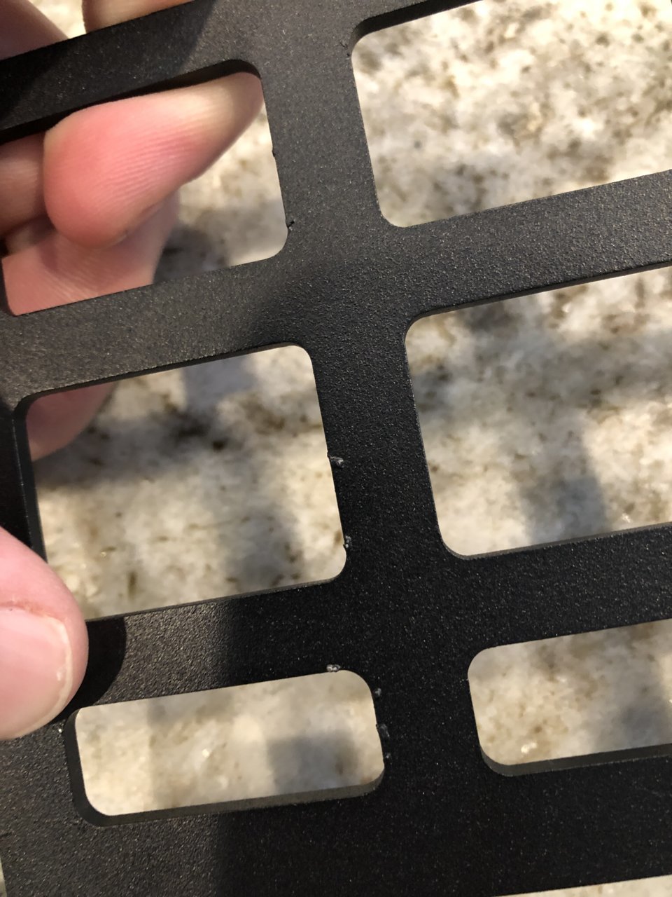

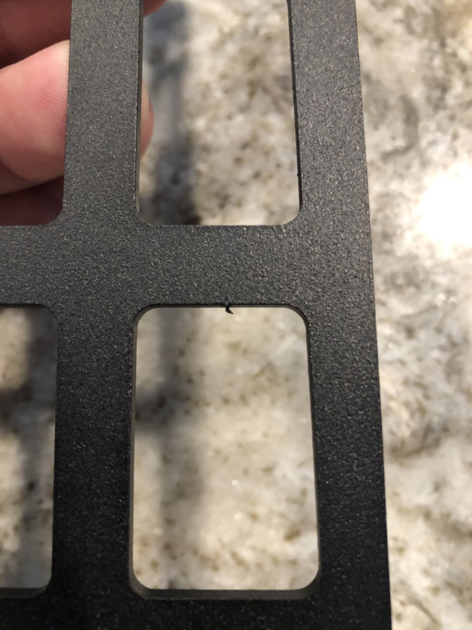

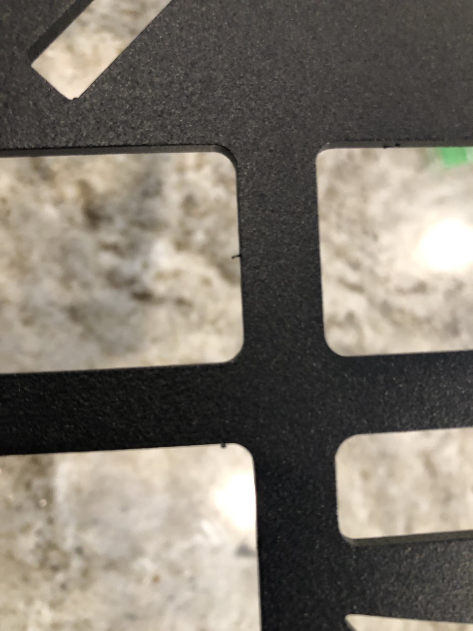

    Just FYI, the de-burr issue isn’t limited to the roof rack. I ordered some center console MOLLE panels and they were riddled with burrs. Very sloppy

    One could almost get away with burred edges on the roof rack (or any exterior part) - but an interior part, I would expect nothing but the cleanest look. Hell, I would go the extra distance and use a CNC to chamfer every edge ever so slightly.
    got a pic?

    I agree, and yes. Here are a few from one of the 2 panels.

    Water jet is so slow. We'd have to run a second shift just to get the same qty of parts cut. A properly adjusted fiber laser is awesome on aluminum with minimal cleanup. Our current cutter knows the deal now and our new fiber should be here in a month so we can have full control over the cut settings again to avoid so much cleanup and rejected parts.
    The solution is to replace them, or if you'd rather not do that, we can come up with more creative compensation. You can pull the sides one at a time with the rack on the truck. Just leave the mounts attached to the roof.

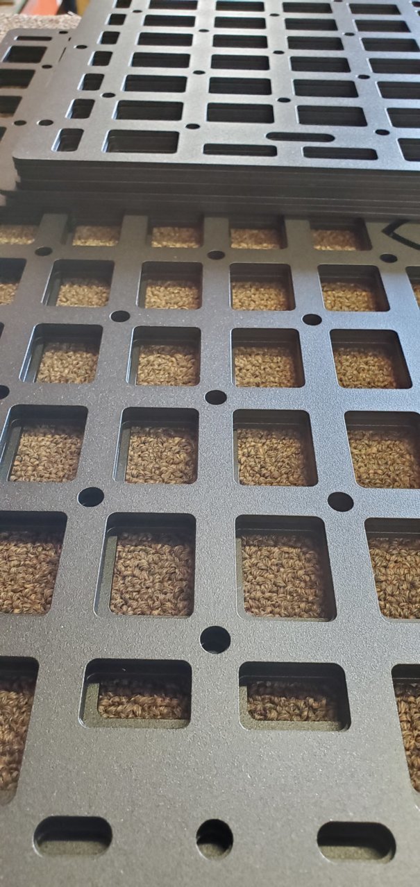

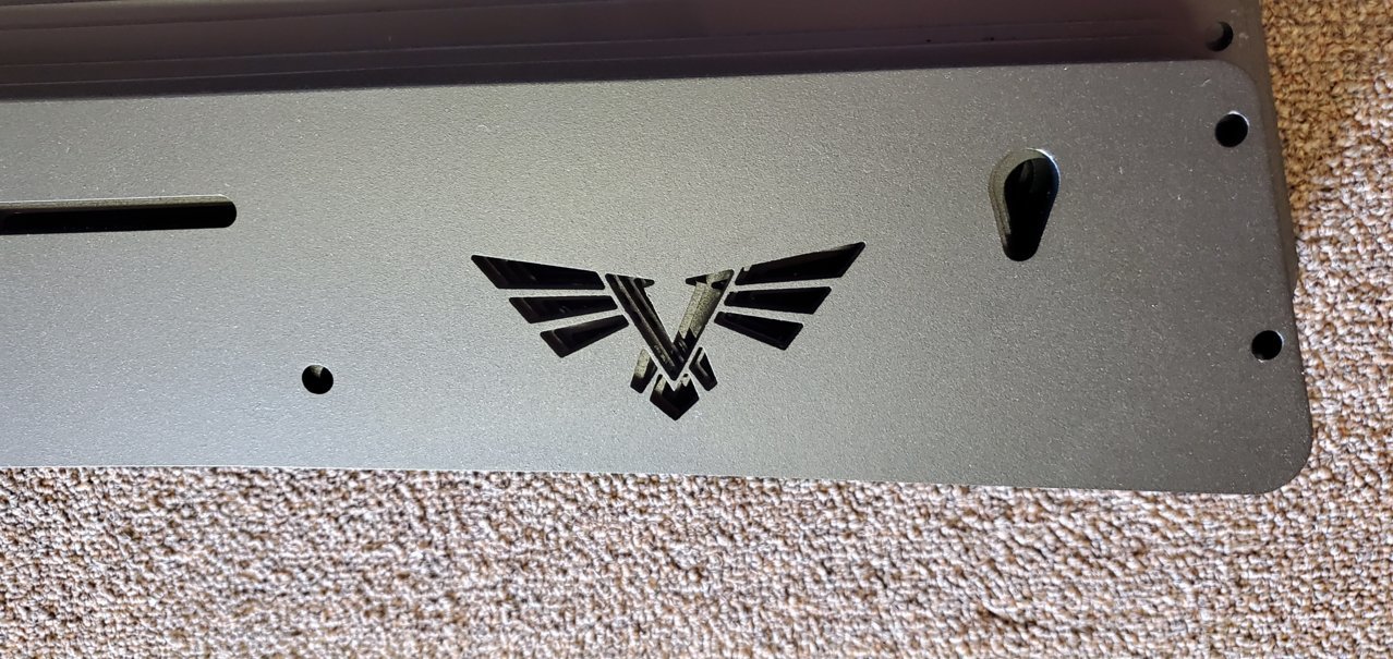

    Two samples from the outgoing rack this morning.

    I just mean, you might want to, as a company, figure out how to prevent product going out like this. Whether racks, panels, whatever is cut in this fashion.
    There should be a QC process to catch this and the vendor doing the work for you should be held accountable.

    Ah OK. Yeah, the team is already all on the same page on this one. That happened the first day we knew about the issue.
