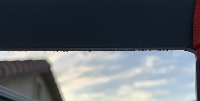

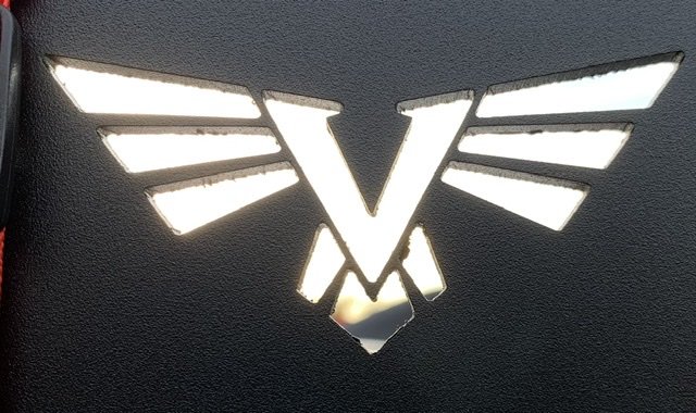

    514CFA5F-D6EC-4B65-A969-50F04F0E7A5F.jpg I installed my Victory rack a couple of days ago and am loving it! I dropped mounting legs and fairings to lowest position and used the weatherstripping front and rear. Seems to limit wind noise for sure. I may add some paint protection film under the weatherstrip to prevent wear. I added some cheap grab handles off eBay that I’m undecided on whether to leave them on...
    I had read about the deburring issue on this thread and while it’s not a deal breaker it does seem to still be an issue.F7E8513A-E46C-432E-AB90-7BD391FEE536.jpgEE0A323D-EE85-43A7-AD42-79268F008118.jpg
