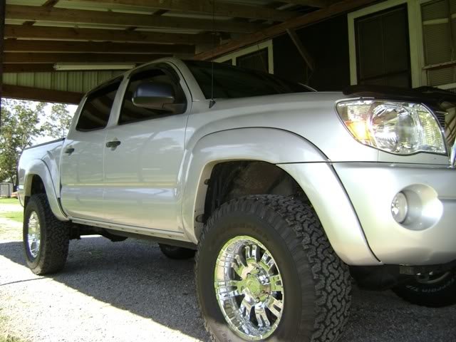

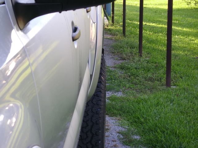

    I have the procomp 17x9 but my backspace is 4.5 with 0 offset. Here is a pic of how much they stick out, hardly.

    Thanks for the compliment. The BFG's are 285/70/17. They are 33s. The lift is Toytec 3" 884 coil springs with factory Bilstien shocks on all 4 corners. The rear is a block as I have the TSB done. If you have a 4dr I would recommend the 885 coils in front. The ride is great I can't even remember what stock felt like, this in my opinion is better.

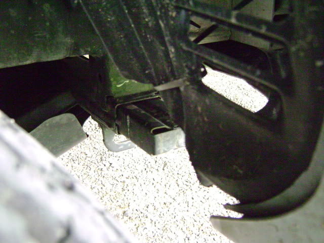

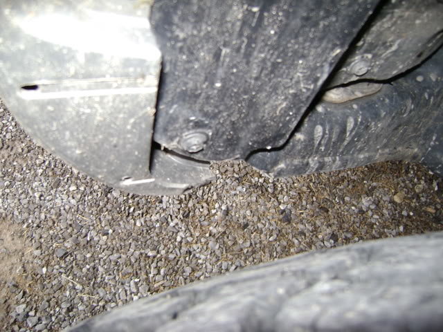

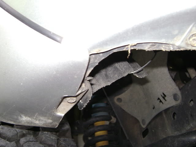

    Some trimming not much here are some pics.
    Cut the big square nob off in front. Used a razor knife, I don't own a drimmel.
    Then trimmed what touched in front and zip tied some back to stop from flapping.
    Was very close to rubbing in back on full lock so I cut some to leave room for flex.
