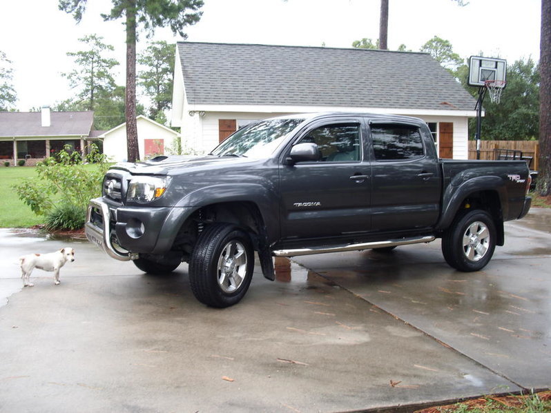

    I just put the 3" procomp. I find the ride stiffer but not really a bad ride. The larger tires and wheels will come come later.

    I think it looks good and it'll likely suit your truck fine since your truck is pretty heavy. How much front lift did u get? how r the cv angles?

    It lifted the front just over 3" It leveled it pretty good. I shimmed the differential with large area washers ( 3/4" of shimming) and longer bolts. The CV Joints are now really close to factory angle
