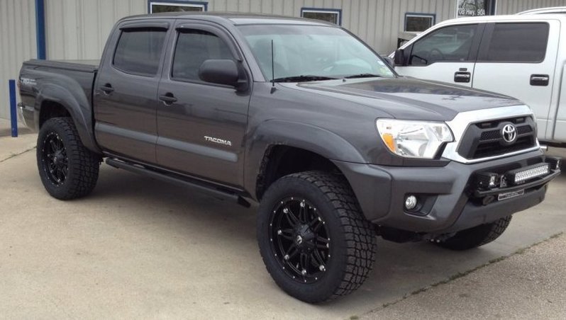

    TYVM! :) I am still hunting around. I wanted 18" wheels, but getting so hard to find nice wheels smaller than 20". I am thinking about the following look. Just need to get through dirt / mud without getting stuck.
