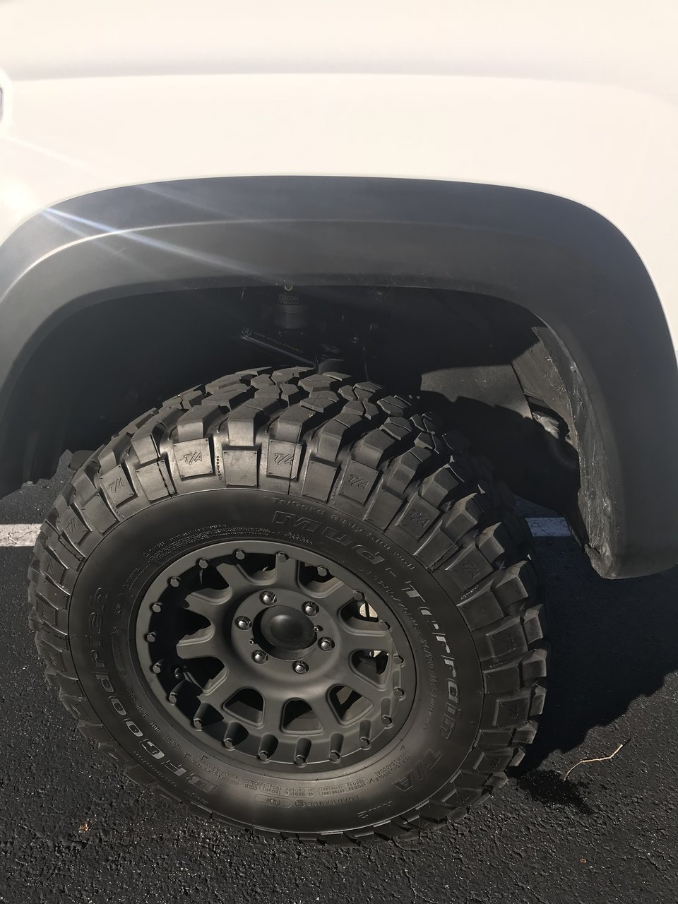

    I know this has been dead for 5 months but I just installed the 7031s on my truck tonight but the stock TPMS sensors that came off my steel wheels wouldn’t fit. Are y’all saying the OEM sensor for alloy wheels will fit these?
