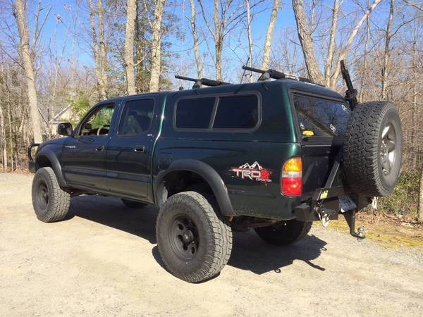

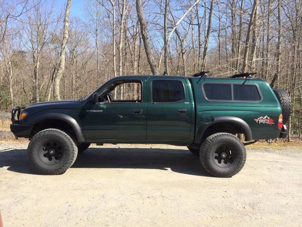

    Okay, so it took a little longer than a week but here you go.........they fit great but I did go ahead and order the black chrome ET style lug nuts from Wheelers just in case the Pro Comps diidnt get enough thread. I think the Pro Comps would have worked fine but I have read where others had some shaking issues with those and the ET style fixed that. They also helped center the wheels a little better.
    Haven't flexed it or anything but so far no rubbing. This is a hunting and fishing rig and sometimes on hunting land they stuff but I never really have issues with that. I spend more time on the beach in the sand than anything and the bigger, wider tires offer better floatation in sand conditions.
