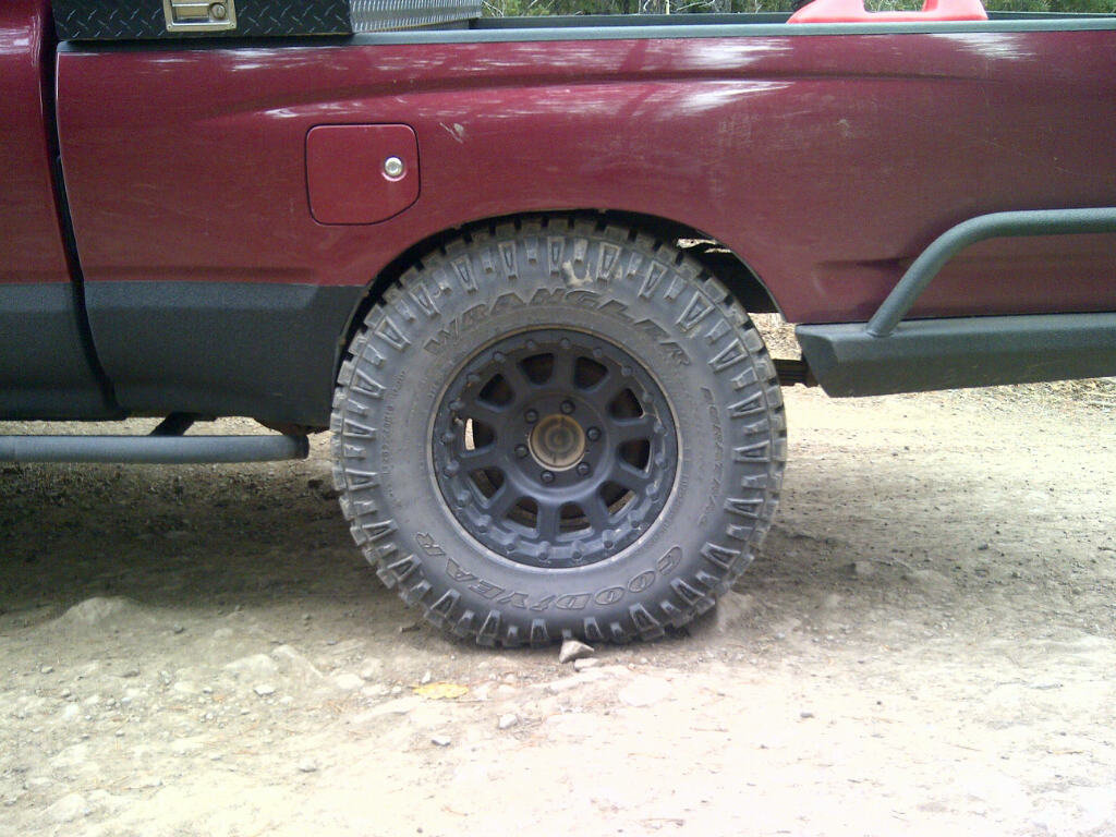

    i got the same tires last month and am on 16x8 procomp rims with 4.5 backspacing, full OME kit with dakar rears and 881 fronts
    i didnt notice any difference in the ride comfort with the E rated tires, i think they feel great on the road
    i dont have spacers and clear stock upper control arms no prob, i do rub on the frame at steering lock, and i do rub on the rear of the front fenders some even after pounding the pinch weld in and trimming some plastic. i think it would help a bit if the caster was cranked more forward but could only get it so far with my stock CA's
    my tires rub pretty good on the back though when they stuff up into the wheel wells, the axle is definitely moved towards the front on the wheel well as you can see if the pic below
    i also do about the same type of driving as you. in the city i have no problems at all and offroad they do rub some but not terribly, doesn't bother me much but ill see if i can remedy it eventually. love the duratracs so far though they are an awesome tire
