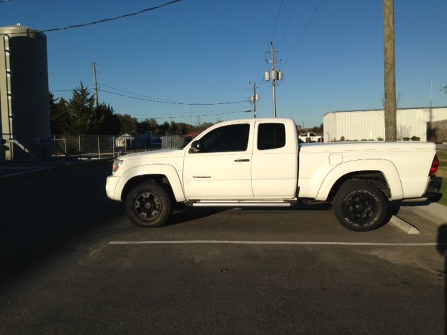

    Here is mine with the Procomps
    As far as your lift goes. I had my 5100's set at 1.75 with the 3 leaf pack and it sat level. There are some pics in my build thread of it. I now have maxtrac spindles and the 5100's at .85 with a Dakar leaf pack.

    Damn that looks good!
    3 leaf is stock right?

    Yes for the 2012+ TRD offroad package it is 3 leafs. The TRD sport package for 2012+ has 4 leafs.
