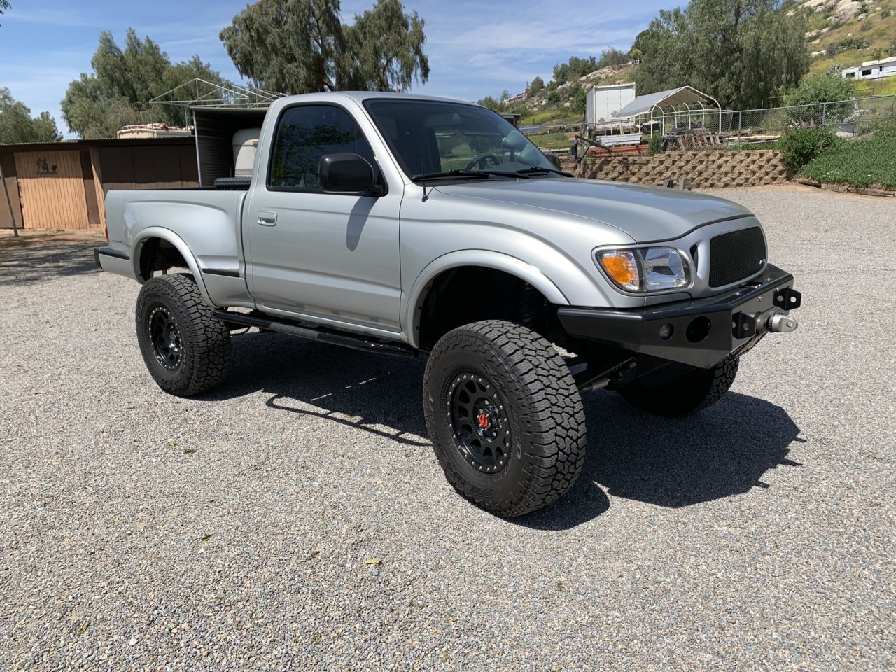

    A SAC isn't cheap by any means, regardless of leafs or links.
    I went with links from 4WU and Front Range Off Road for their Diamond axle.
    My frame is 22" from the ground and I'm on 33's at the moment, not tall at all.

    I’ve always assumed you could do it, since they use to come that way stock. But I’ve never seen an axle swap where it was left near stock height. That’s awesome. Any side pics?

    Here you go...
    Sogoku19 likes this.

    aw man. Love the step side. Sick truck. Thanks for the pic. Beauty.
