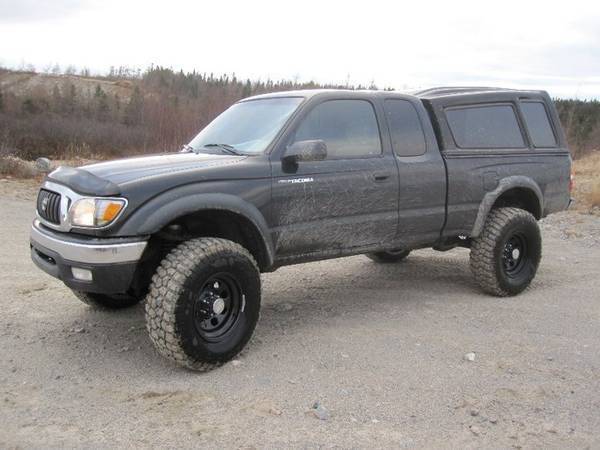

    Well, after a LOT of screwing around with a local dealer, I got a free set of 1.2" wheel spacers and my wheels went on just fine. Had to trim a little and flattened/cut the pinch weld, but now I'm more than happy with how it turned out.
    I've had them on for a couple of weeks now and they're working out great! Had a nice little crawl up a steep rock face with a few buddies and when I took my second line I had NO rub.
    Anyway, enough yammerin' - here she is.

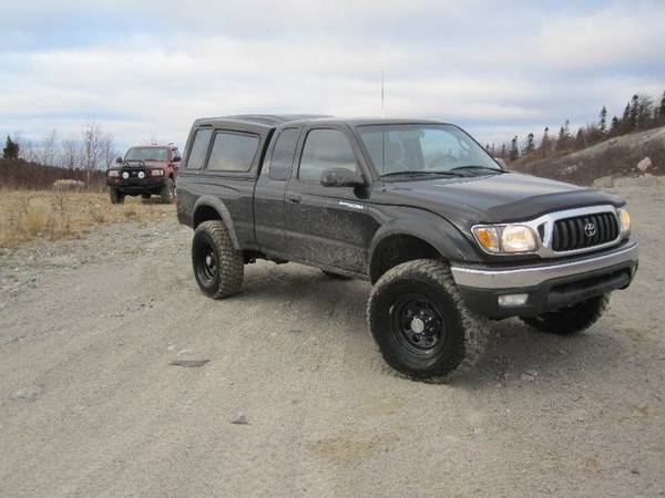

    And again, with my buddy's '02 step side in the background...
