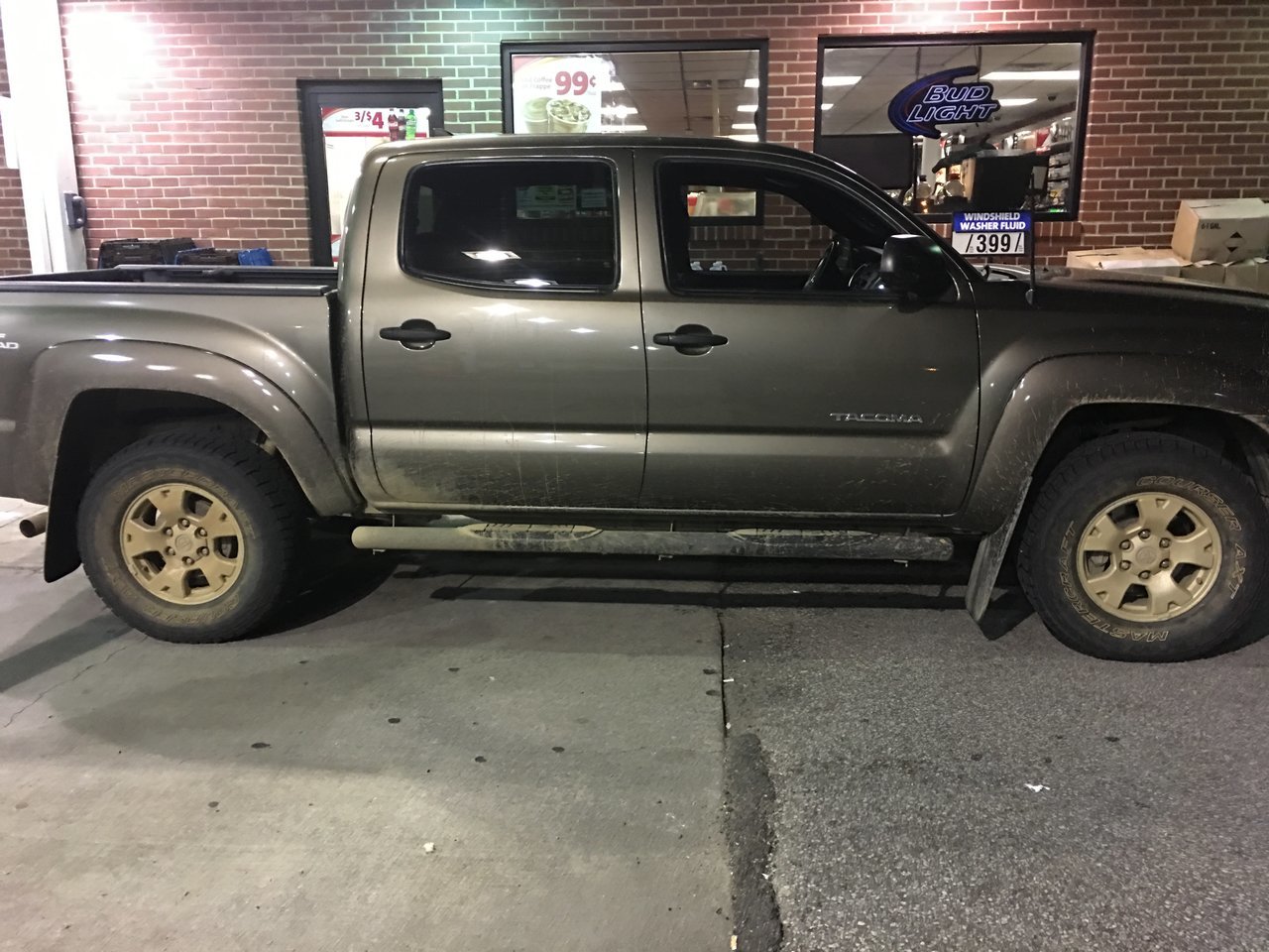

    Ripped off all four mudflaps. Scratches all down both sides 6112’s up front on 3rd notch 5100’s in back with Toytech 1” block Skids & sliders from SOS Concepts I got rid of the 1” block and put on Wheelers 1 1/2” progressive AAL. SPC UCA. Be sure your standing on the drivers side when reading the instructions! I swapped sides so many times that I can swap UCA’s in 15 minutes. I put in the 3/4” spacer to eliminate the Taco Lean, and just got my 4th alignment. Traded the OEM rims for 17” Sport rims and a bora bora 1” spacer. I got my Firestone 285/70/17 MT2’s. Pelfreybilt gas tank skid and hi-lift jack should be here Friday. Looking at bumpers, but I think they will wait for next year. So far I’m happy with my build. I’ve done it all myself, leading to a lot of cussing and frustration, but it’s all mine.
    I don't know why it posted that picture twice. I thought even a picture I want to put up there, but I couldn't figure out a way to delete it or change it Frankly I'm more a novice at forums then I am with a four-wheel-drive. Anyway, thanks for getting back to me.

    nice looking taco
